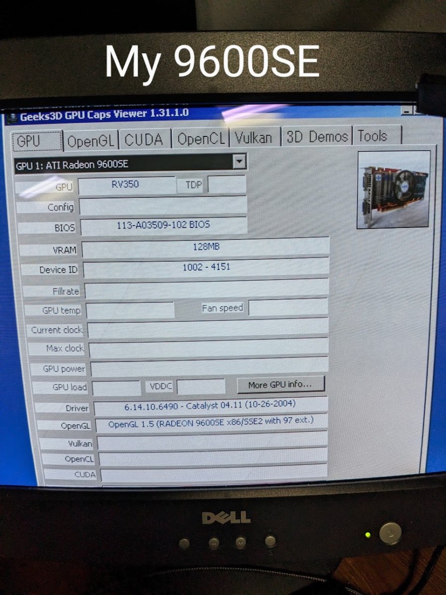

Hi, I have been on a journey getting my TTX running, and now am down to one final obstacle: the GPU bios. It seems the card I purchased from @davesarcades did not come with the Taito JAMMA BIOS, but instead a stock ATI BIOS. I tested mine and see I have the same problematic bios @AlxUnderBase and some others had. This results in all games working except TGM3, which plays blind (black screen, sound and controls function). I would like to use your TTX_MSDOS_GPU software, but the link to download seems to no longer work. Can your provide a new link? Thank you!

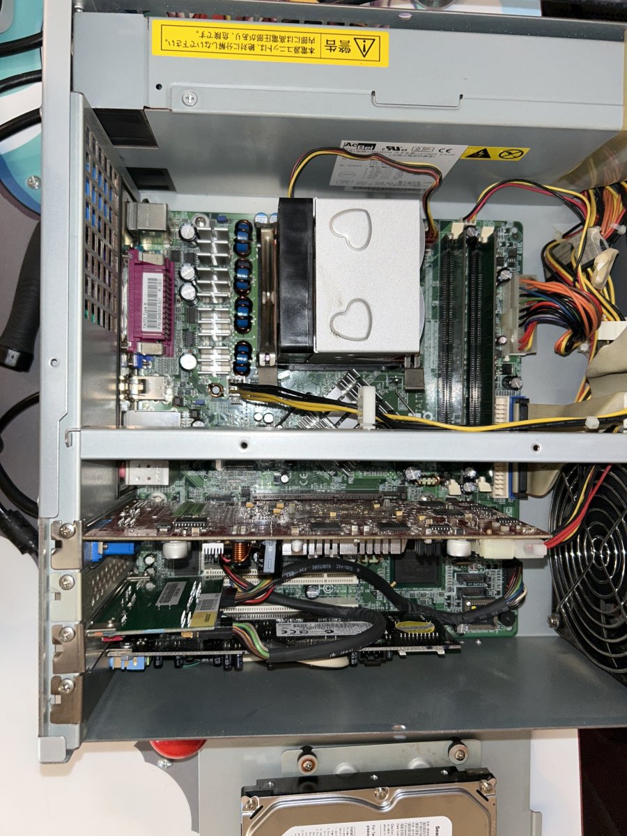

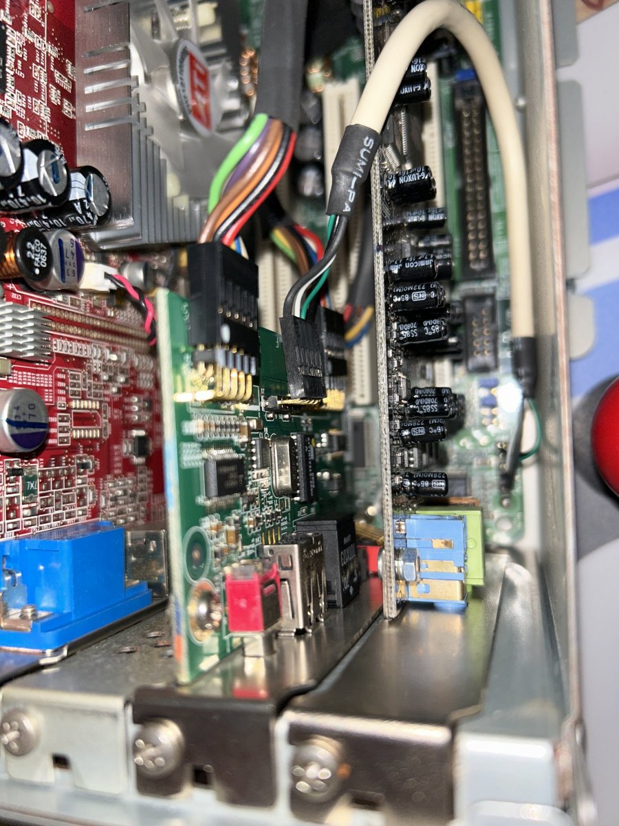

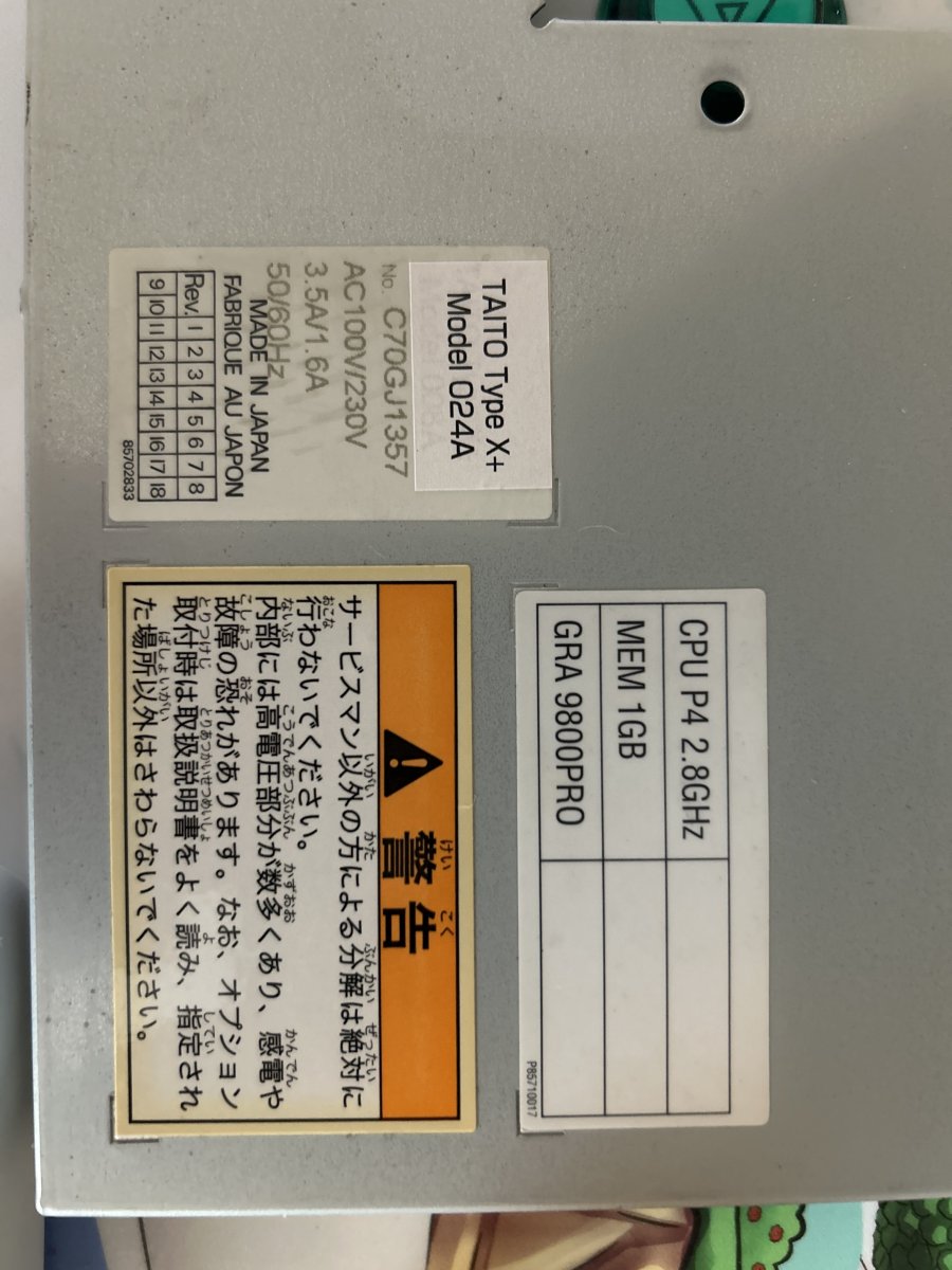

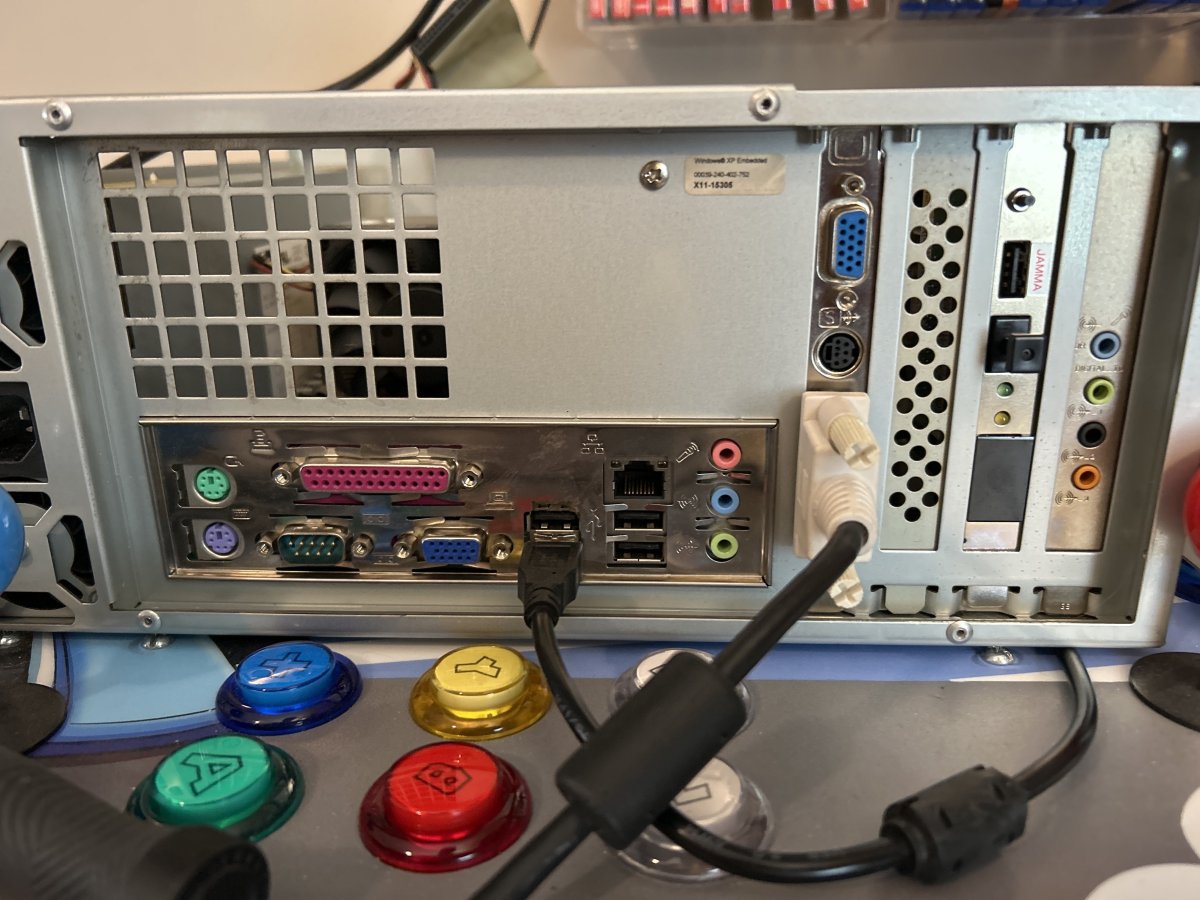

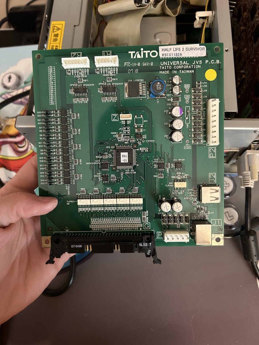

Attached are some photos of the system maybe they can help.

Assuming that's a photo of the system of everything connected in the back, you need to change where you have your JVS plugged in. You need to plug it in to the USB port labeled "JAMMA" on the PCI expansion card. You can't use the standard USB ports on the motherboard.
Ohhhh Rookie mistake on my part, Thank you for the tip!

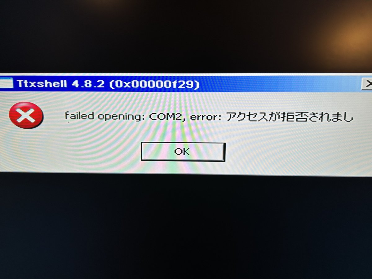

However, now it is throwing a different error any advice?
To thumbs up, click the like button below a post.
As for that error, I'm not sure. All I can tell you is the Japanese says access denied. Probably best if you create a new log file for rtw or someone else to look at
Considering it's a X+ HL2, I'm going to guess the video card isn't compatible. You will need to reflash the firmware or replace it with a compatible card.
Could you please remove the card and post photos?
That error means that the system can't talk to the JVS master board inside the TTX unit.
Trying to launch, but I get the error message "Could not open COM port: Error 5"
I have the JVS serial plugged in COM2, all the connections are solid, but there's also a slim chance it actually boots. I also just updated to 4.7.2 if that impacts anything
