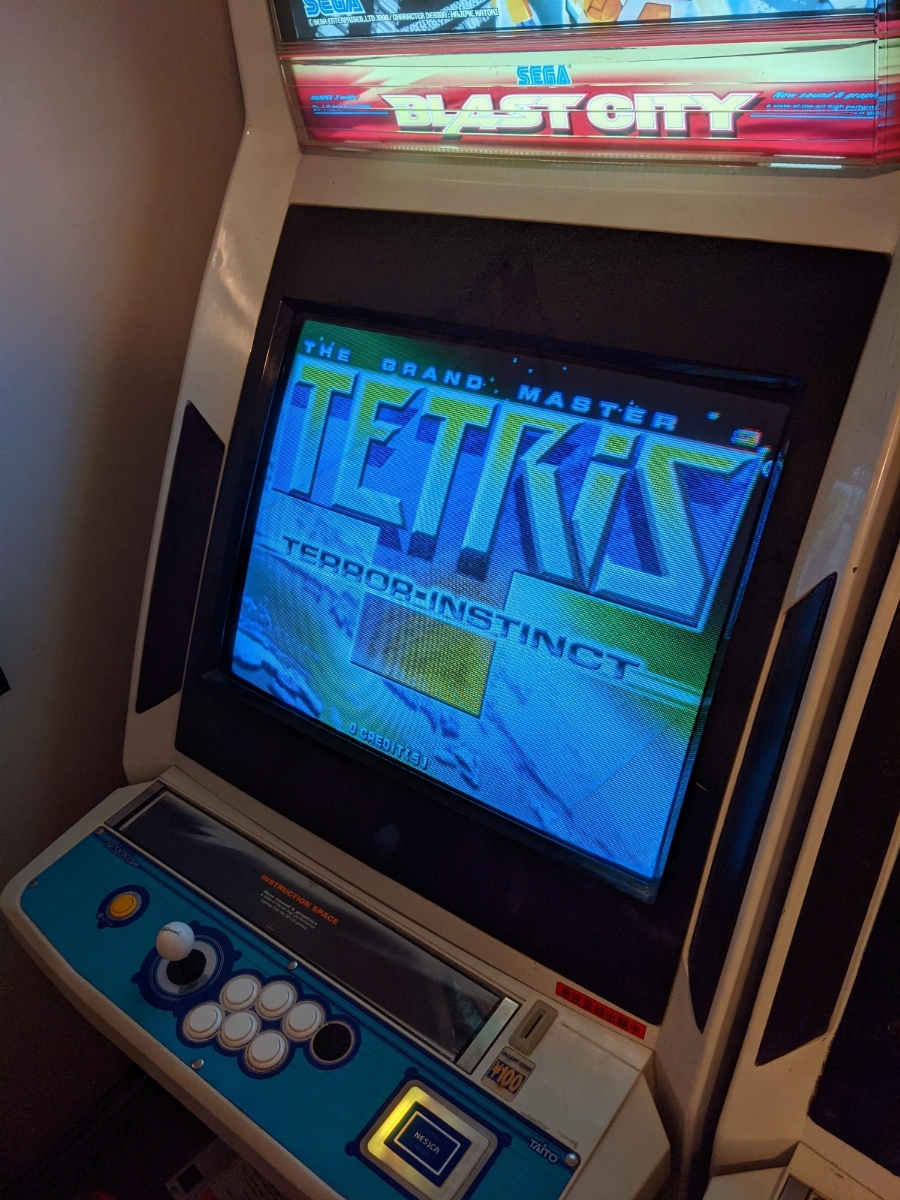

Weird, I'll leave it on over night. Hoping it's just the game data being at fault.
e: The games boot now, but I'm still getting JVS errors, and I think TGM3 has some memory error (0x000000000). I can control the game selector with my JVS i/o so I'm not sure why.

Looks like my Capcom i/o works, not my newer Taito JVS I/O (K9101262B). TGM still errors out for me. But seems like everything that had JVS errors beforehand, works fine now. I don't really mind the taito i/o not working since I just got this for TGM3 which I want to play on my blast.
Here is the error, looks like some memory issue?
e: Chaos Breaker stays at a black screen as well. Ironically the only two games I really wanted a dedicated X1 for haha. CB works if I manually launch it from explorer
Oh just looked back a page and saw someone had the same issue as me, maybe I'll have to dump my 9600E bios
e2: Here's my 9600SE dump, I had to desolder the bios ic and dump it with my programmer, but now I may have bricked my card after programming the "jamma" bios. Even burning my dump seems to have have not fixed it. Oops.

It DID end up being the bios on my 9600SE. I got it booting after burning the uploaded 9600SE bios posted earlier in the thread, now TGM3 boots right up. I didn't brick my GPU, I think maybe some alcohol was causing a short or something and it flashed off overnight. All good now. Thanks for the help!
