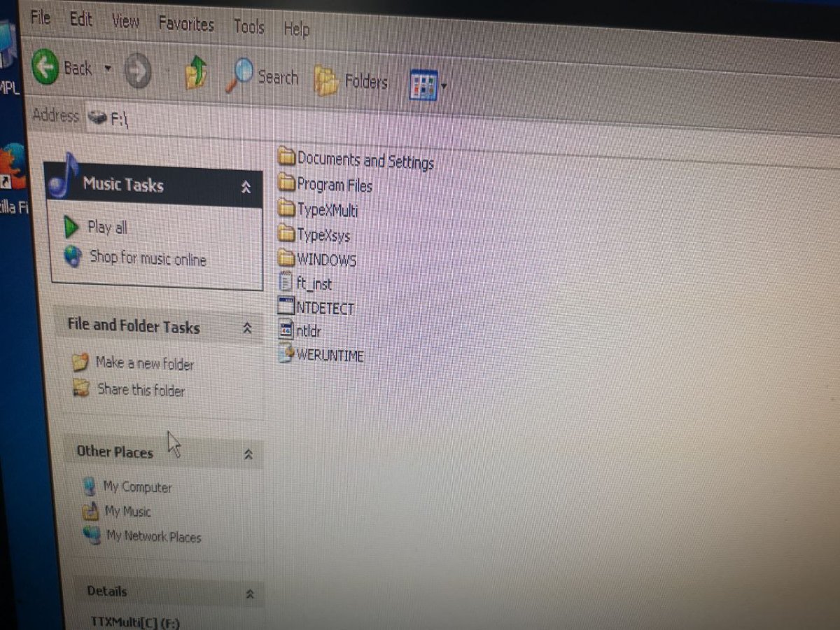

Almost ready Now is ready (running with 4.72 version)
Ps : remains to put back on that partition the games folders and to make update from 4.12 (what is now installed) to 4.72 (latest version)

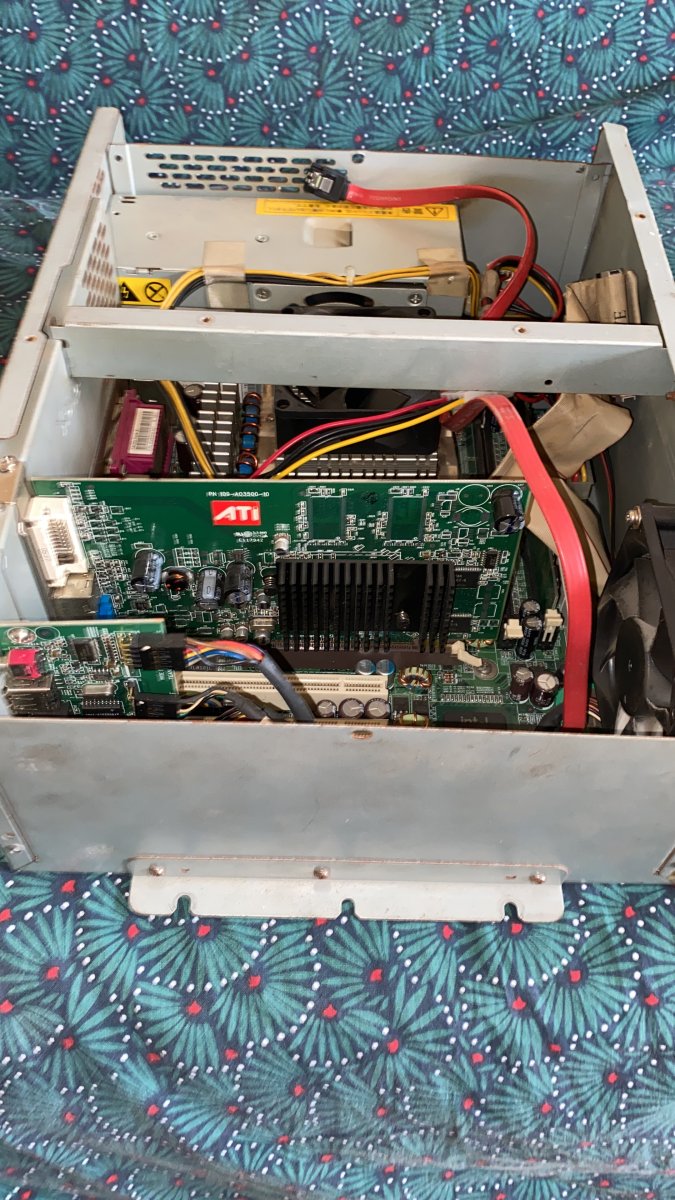

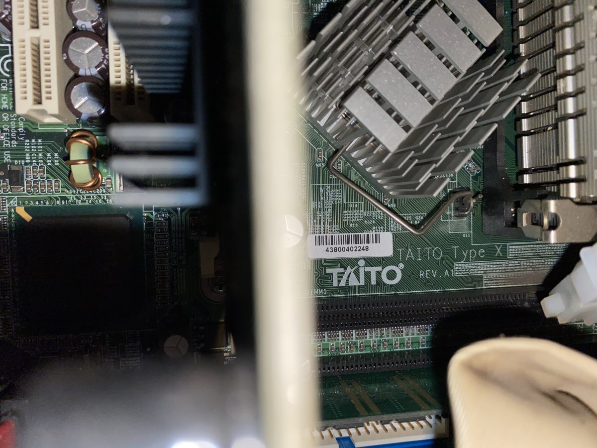

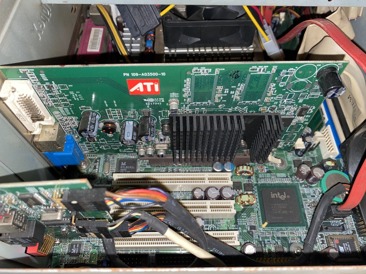

- my unit : Type X motherboard Rev. A1 | 007A | Cel 2.5GHz | 256MB | 9600SE

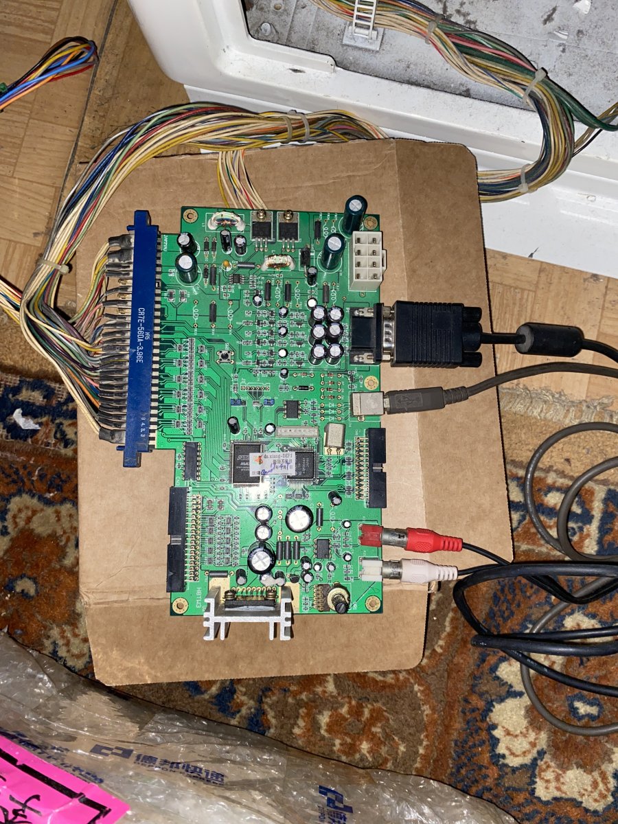

Tetris Grandmaster 3 is working fine on my TTX Multi but instead I'm having issues with GigaWing Generations!
All other games work great but on GigaWing I get the 'game.exe' message as soon as it loads. I was wondering if this is due to using a Capcom I/O (version 2) instead of the official Taito one?

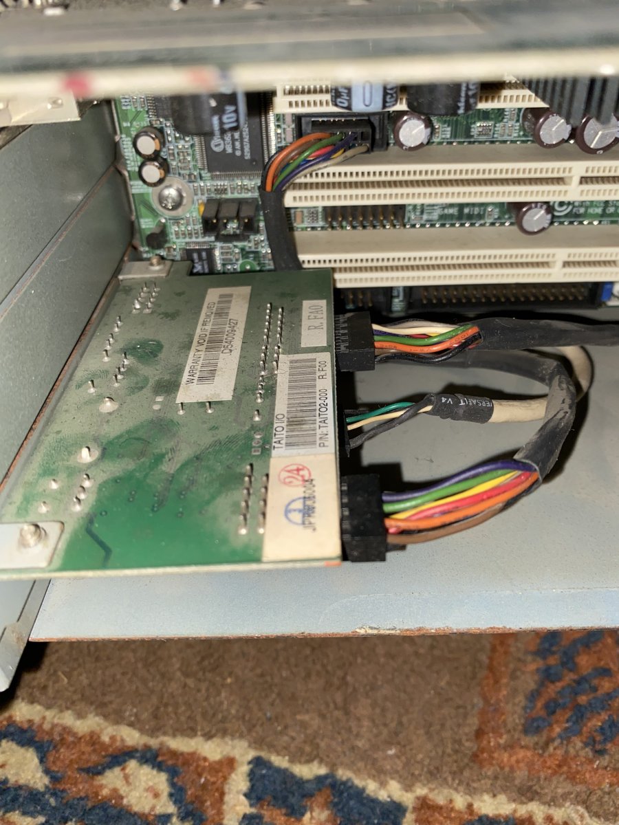

That looks original… some have a ‘Jamma Bios’ label on them like this one

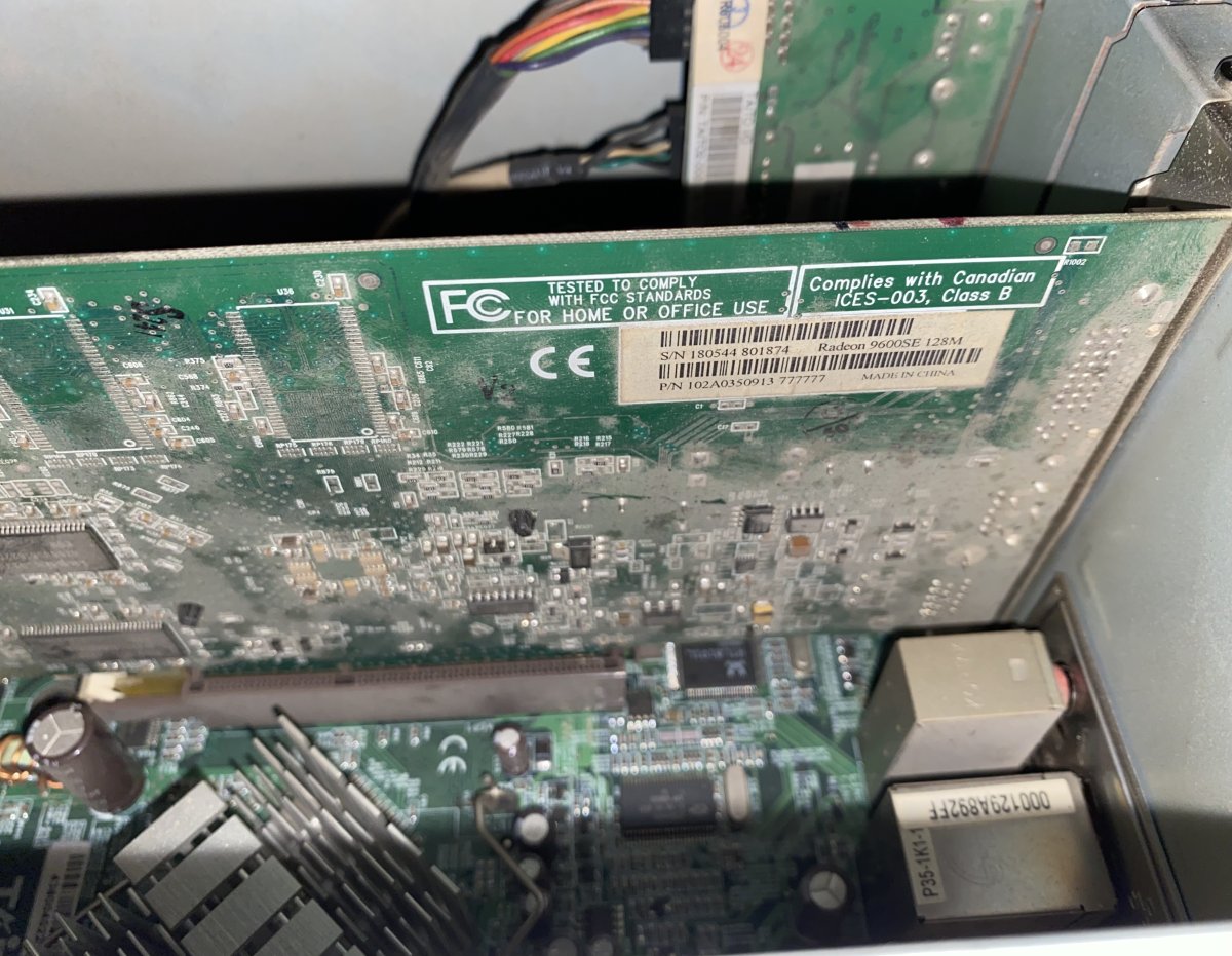

TGM seems to be the most picky title regarding this. Can you also try Raiden IV? I got awful choppy slowdown in the first level using a 9600 without the Jamma Bios…
@rtw, the title of the message is 'YOKUSHIN.game.exe'. The message also mentions "0x0041c1a6" and "0x00000000".
Here on this setup, this game is running normal without slowdowns buddy 🙏🏻

I am starting to wonder if the TAITO Type X has hardware revisions. Can those of you who have a working TGM3 please snap a picture of the version sticker ?
Rest of games works perfectly with this setup for me , only TGM3 runs only with sounds in attract mode with no image
