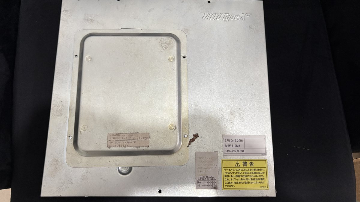

When you say this, do you have a JVS card, but without dip switches? If so, your dip switches are likely covered by a black piece of plastic you can remove by hand. Take a clear pic of the connected cards on your motherboard and we can confirm if you have an appropriate card.apparently x2 have a jvs card connected on pci port with dip switches that I don’t have
I don't have the JVS card at all, I can't put any JVS IO because of that, maybe I should give up and search for a complete type x2, I couldn't find a JVS card anywhere, even infos about it are so hard to find.When I tried with my multi, not having the appropriate flashed GPU and not having a JVS I/O plugged in stopped me at the same spot. My guess is, you'll need the GPU, you'll need the JVS card, and you'll need to plug in the JVS I/O to the JVS card to get to the multi menu.
I can post a photo but not right now, I'm home and the board isn't here, but I'm sure that the JVS card isn't there, I have to find one 7900gs and the JVS card.Definitely won't boot if you're missing the JVS card, I think I missed that in your previous post. Sorry!
Could you post a photo of the expansion card area of the case? The JVS card is usually all the way at the bottom.
The only way you're gonna get the JVS card (or even a DMAC/FAST card) are from part outs, I think. There's a certain Chinese seller you could try asking for one if you wanna roll the dice on him.![]()
