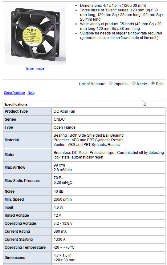

Thank you for this! Any reason why you chose the PWM fan models versus the 3 pin models?This is the original fan that came with my Vewlix FC: cndc12d7v
I tried both of these with good results, the first one although spec wise is very similar to the OEM one, to me sounded quieter, it didnt bother me as much as the oem one. The second was much quieter being a lower RPM of course.
NF-F12 industrialPPC-3000 PWM
NF-F12 industrialPPC-2000 IP67 PWM
Since the oem fan was directly spliced in, I crimped my own jst connectors for the new fans in case I ever want to replaced them.
Glad to help, I am sure you can find similar replacement fans. I just happen to like Noctua fans.Thank you for this!

The industrial 3000 rpm fan which is similar in specs to oem only comes in PWM, plus those are meant for constant server type operation, so figure it was the best bang for the buck when compared to the oem.Any reason why you chose the PWM fan models versus the 3 pin models?
