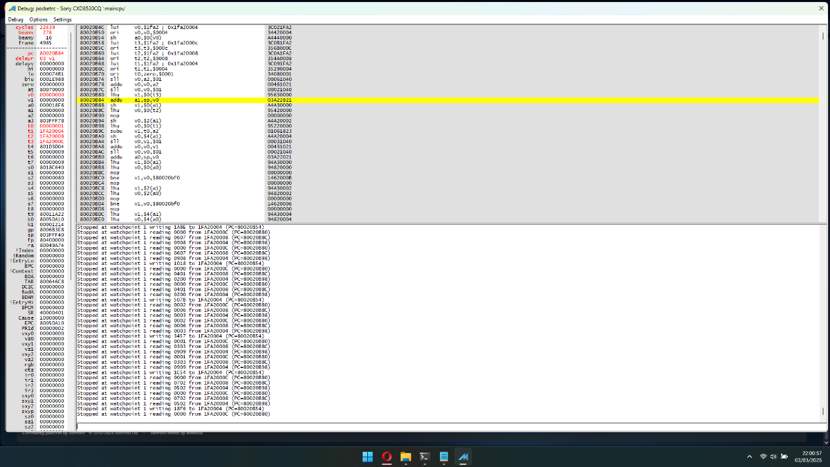

Well, clatGPT is wrong :D
prime goal is a few easy checks too ..
So the only 2 that are a problem so far are dancing eyes and pocket racer...
dunk mania i have not checked yet
Dancing eyes makes sense, i can see what's going on, but pocket racer is a bitch (of cause, because it's the one i want the most LOL)

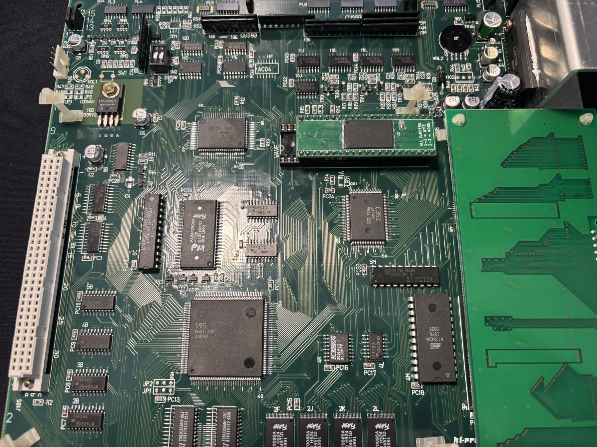

This is the memory plan guys:
ROM8 PCB - IC: 1,3,4,5,6,7,8,9=8
Original: MB8316200B
Spare: MX29F1610
IC:6D
Original:Intel 28F200BX-T80
Spare: PA28F200B5T60
IC: 2F,2J,2K,2L
Original, still available on ebay: 28F008SA-120
IC: WAVE.8K 32MBit
Same MVS problem, there is no 42pin DIP EPROM in Byte mode that you can buy ! only 27c322 in word mode
Anyone have pinout of original maskrom ?
If we are lucky we can use the adapter made from ACK granmaster jedi ! for MVS !

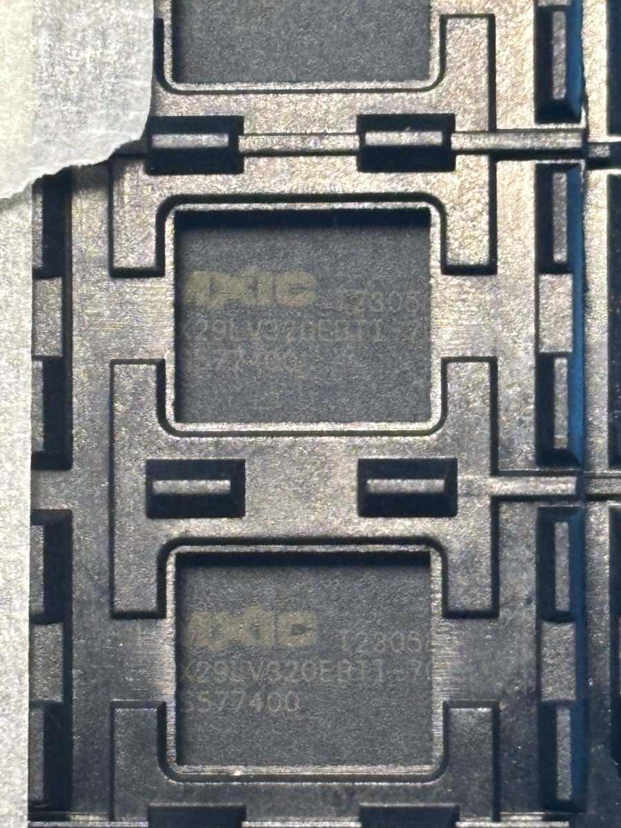

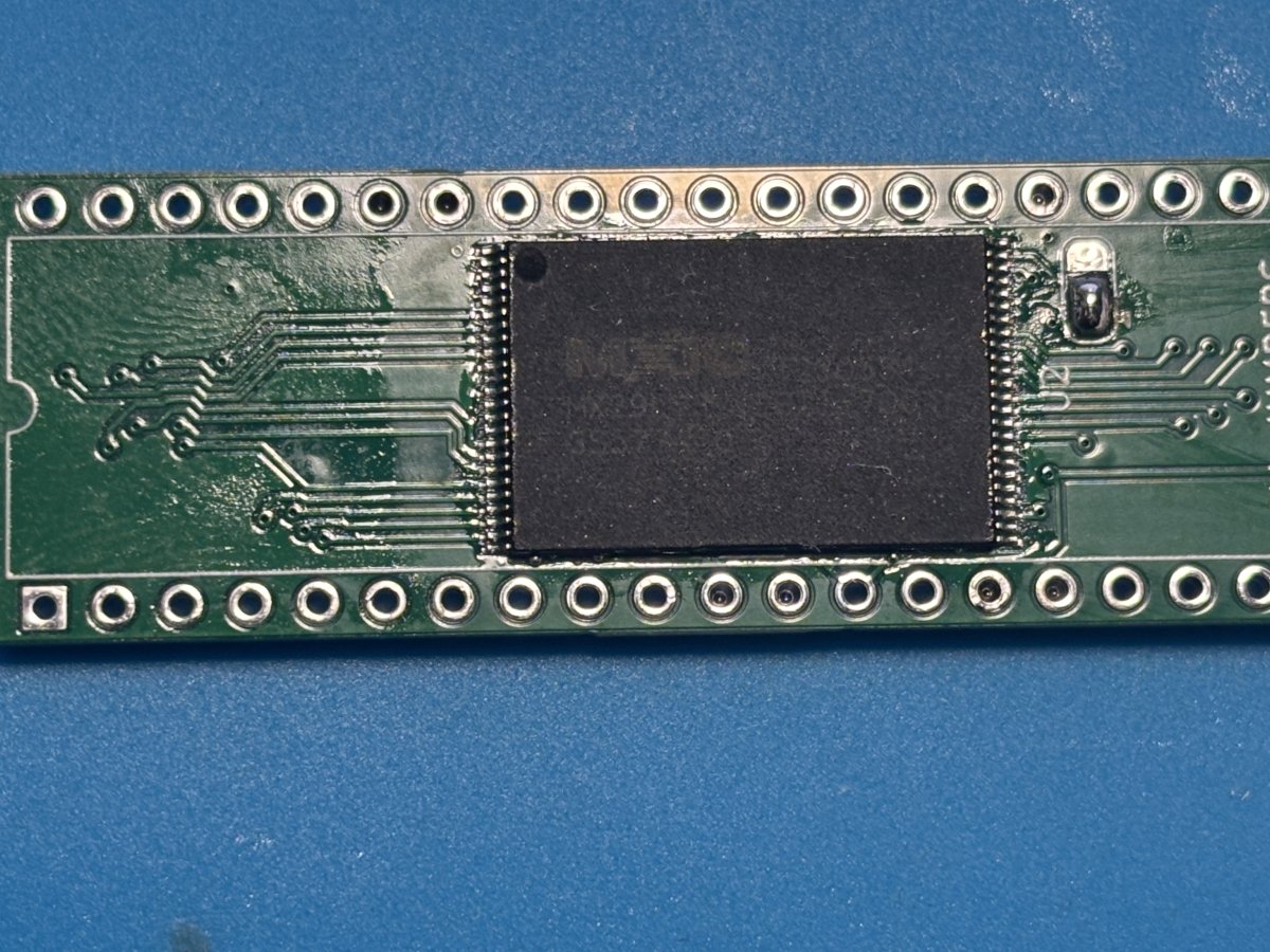

I have already used it and and still have some pieces available, so i can use: MX29LV320EBTI-70G
WAVE.8K - Sound samples, 42 pin DIP mask ROM, either 16MBit or 32MBit. If 32MBit, it is programmed in Byte Mode.
SPROG.6D - Sound program, Intel PA28F200BX 2MBit Flash ROM (SOP44)
PRG.2* - Main program, Intel E28F008SA 8MBit Flash ROM (TSOP40)
What you think about guys ?

Good morning guys !
What i choose to buy in order to test this rom on my hardware:
All follow IC are easy programmable with my Xgecu T56
IC: 1,3,4,5,6,7,8,9=8 - SOP44
MB8316200B - Datasheet
MX29F1610MC-10 - Datasheet - where to buy
IC:6D - SOP44
Intel PA28F200BX - Datasheet
PA28F200B5T60 - Datasheet - where to buy
IC: 2F,2J,2K,2L - TSOP40
E28F008SA-120 - Datasheet
LH28F008SCT-L85 - Datasheet - where to buy
IC: WAVE.8K
32MBit DIP42 Byte Mode Maskrom
MX29LV320EBTI-70G with ACK adapter (maybe this is my plan)
Any other advice is welcome
