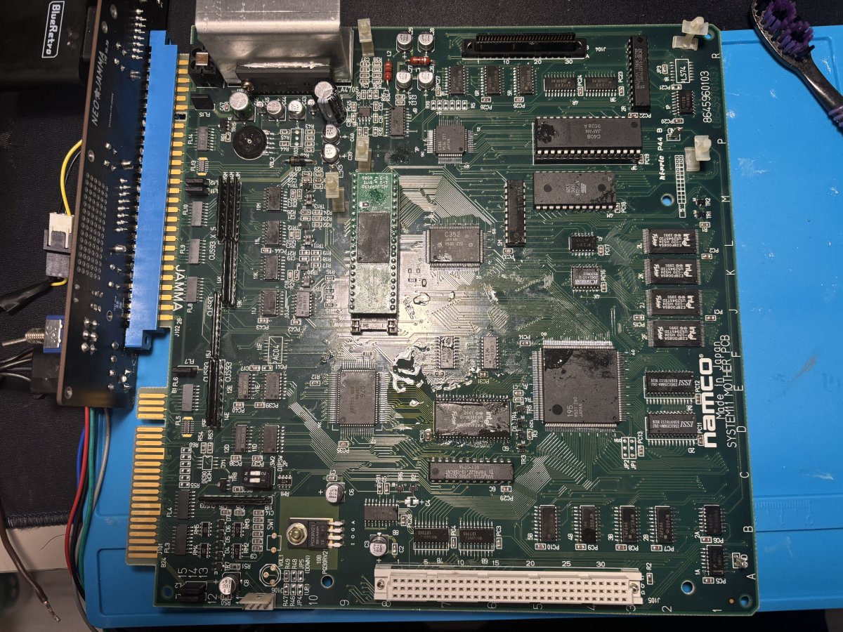

Is there an issue at about 0:27 in your video? or is this monitor related?
Its just my monitor :-D i dont have any old monitor to use so i need to convert signal.
Also with Tekken i got wrong gamma color, i have ordered all part to make The Jassifier and use my OSSC.
Or maybe there is some video level to adjust on board, i mean the resistor on top board.
