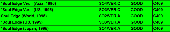

Checking test menu of my soul edge, is written: SO4 / VER.C
But on board i have SO1 / VER. C 8|
So the only different is 2MB chip version

To upgrade a Soul Edge Ver. II to the (Asia, SO4/VER.C) version, do you just need to reprogram 1J & 1L ?
Is the file you dumped a Soul Edge Ver. II (Asia, SO4/VER.C) or a Soul Edge Ver. II (World, SO4/VER.C) ?

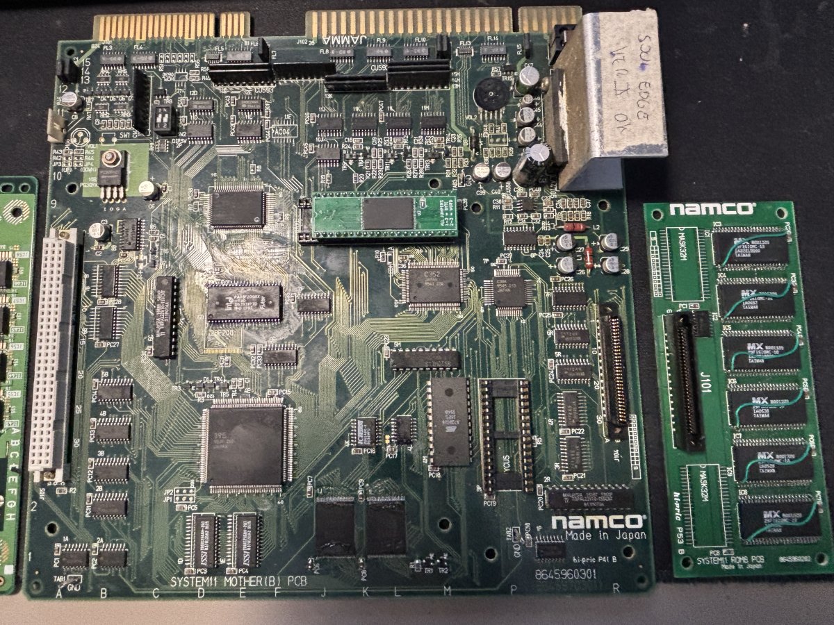

I really dont know Asian or World, i take a picture of settings but there isnt any info about it.
What board you have ? with 2 or 4 ic ?
If you have two ic 1j and 1l this is the only version aroud, if you have 4 ic motherboard you can get the other dump that seems Asian:
Checking here there is no SO4 Ver.C world
But keycus is the same C409, and daughter board also is the same so yes you can just update 1j and 1l or 2f,2k,2j,2l
