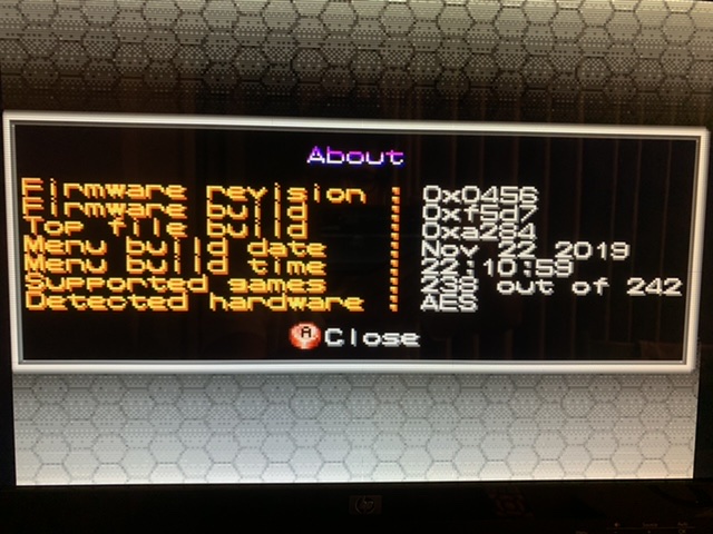

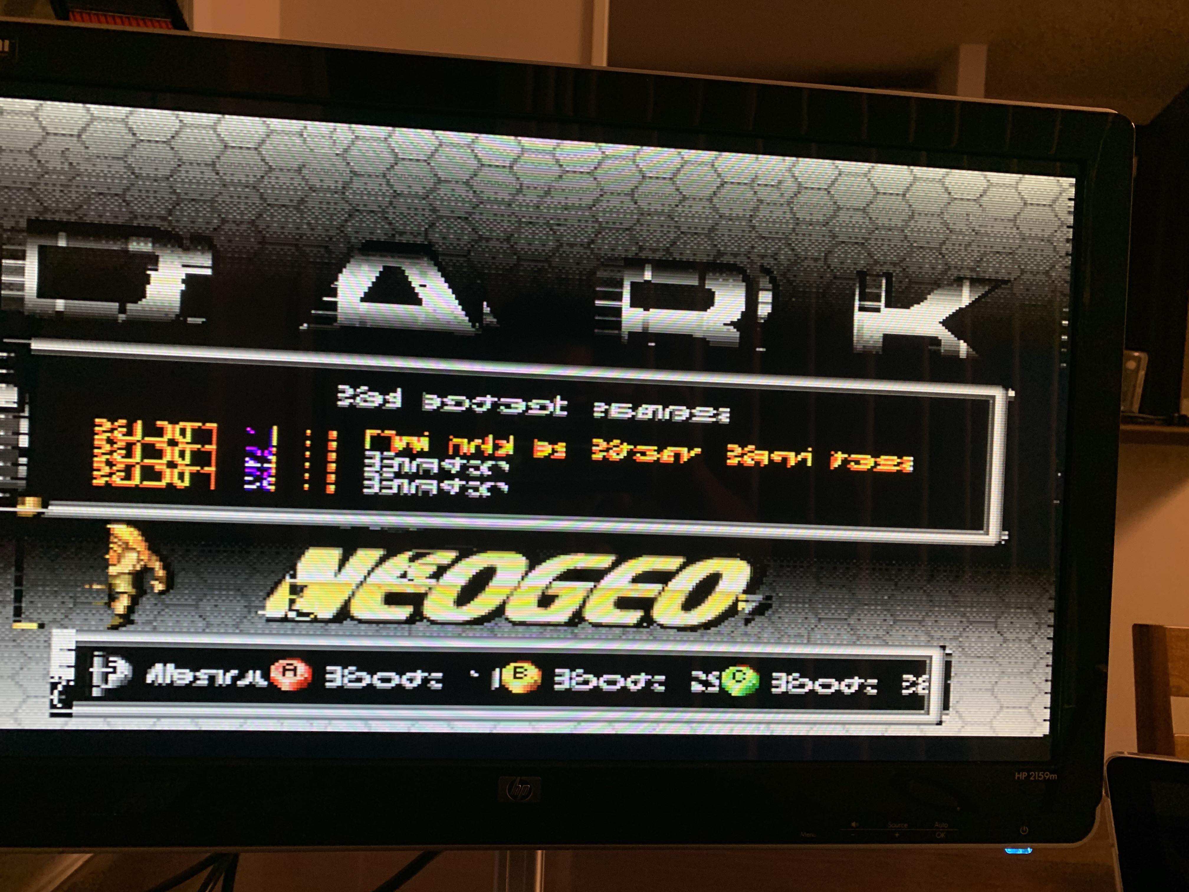

Good evening every one,
I have installed the FW r 1169_AES_only, the menu was the same as before 20191122, according to the menu I could install it properly but still I have some issues :
I could install the 3 games, play the game but I could not change even one game. I could erase all the game and we I restart manually, there is no game installed, I tried to install one but it doesn't.
Sometimes I have some huge graphical bug on the menu and still the regularly in the menu the image is becoming black for less the one second and come back directly after, sometimes with sound cutting. In game this black screen appeared as well, but it is rare.
I dont know what to do now

First of all, make a check of the microSD in your PC looking for errors, please.
Those symptons are very weird and they might be related to many thinks, like PSU not powerful enough or cart slot dirty.
Do a full FW upgrade, including the cpld file and let us know how it goes.
Thanks.
