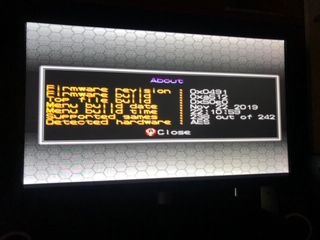

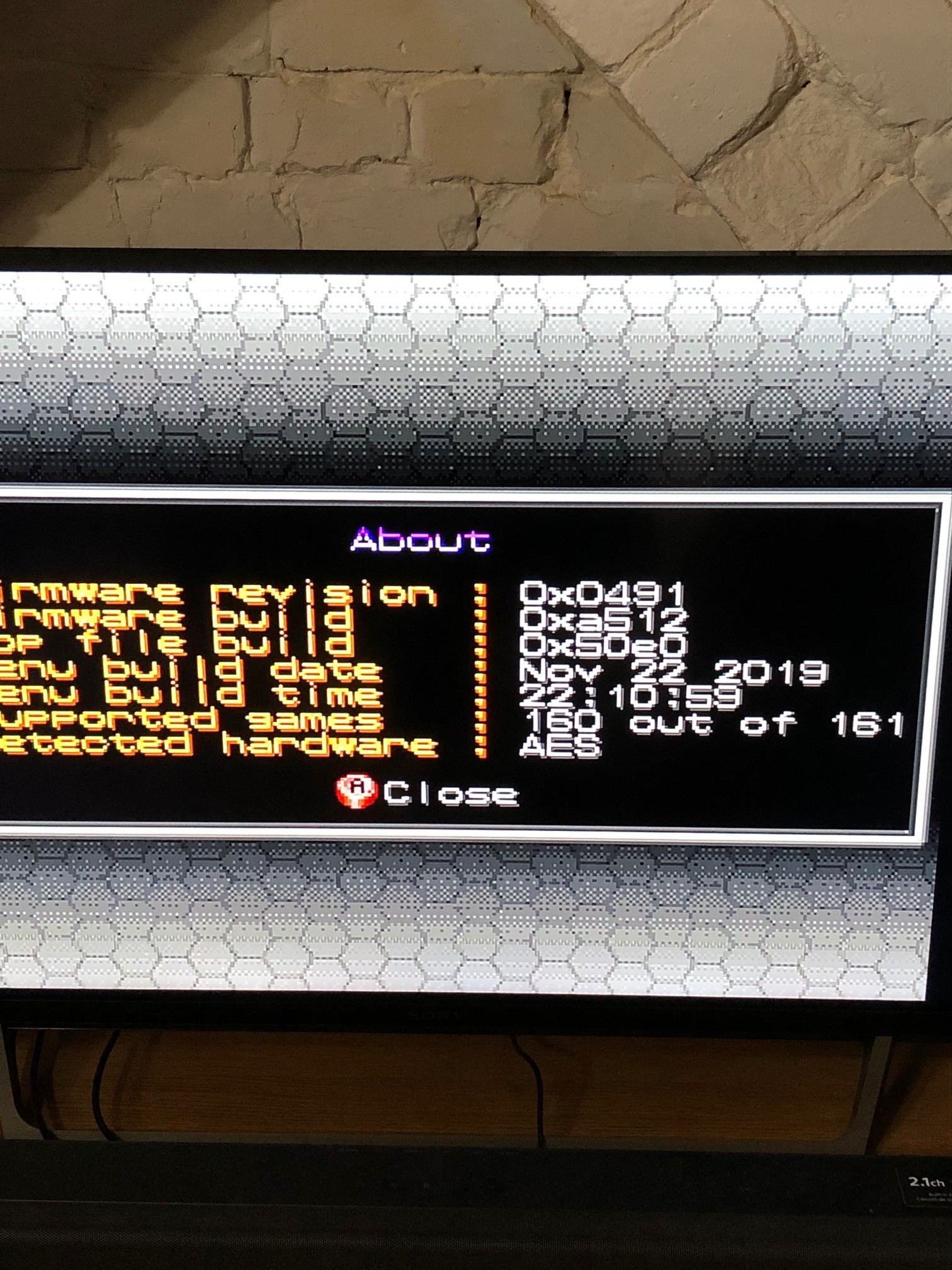

Firmware revision 0x0491 - build 0xa512 - top - 0x50e0

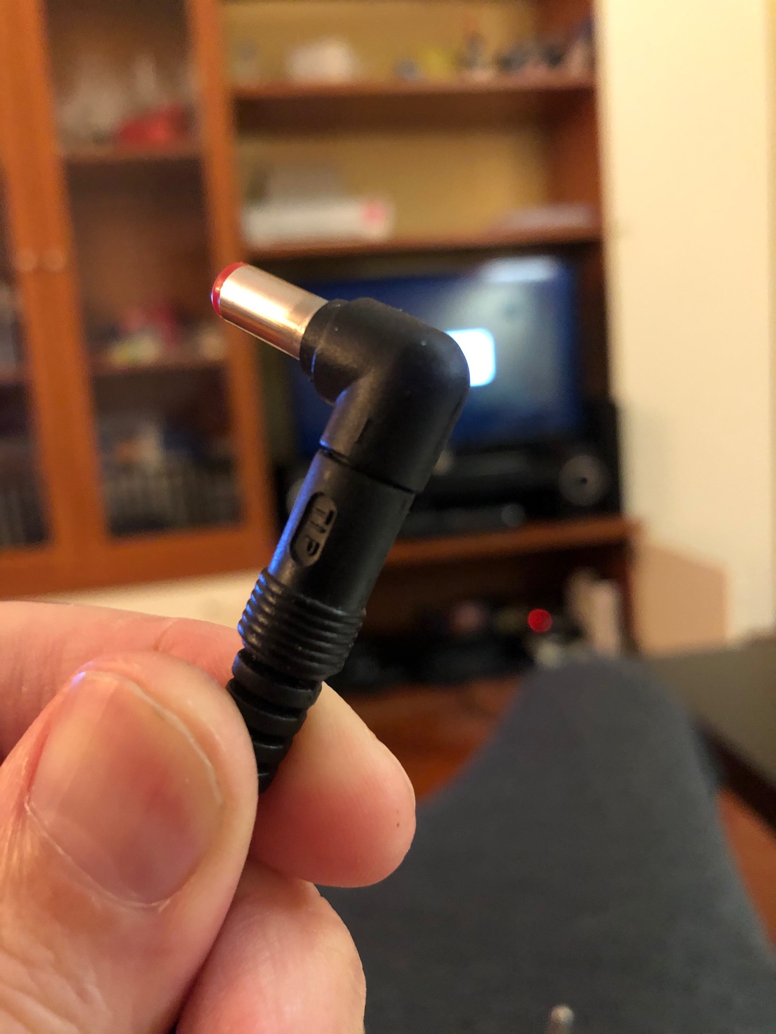

That PSU doesnt look very reliable to me and may introduce a lot of noise or not provide stable power. I assume that you are using the Tipp that makes the center of the connector to become '-', right?
I would strongly advice you to get one of these:
Choosing the right AES PSU
ok, but i tried 3 different psu and they give me same error, in photo is the last i tried. The one of megadrive, that i tried, is good and also the first.
I used the neo geo until yesterday with both originals and the mvs aes adapter with a 161 and other cartridges without a problem. Anyway the tip is correct, center negative.

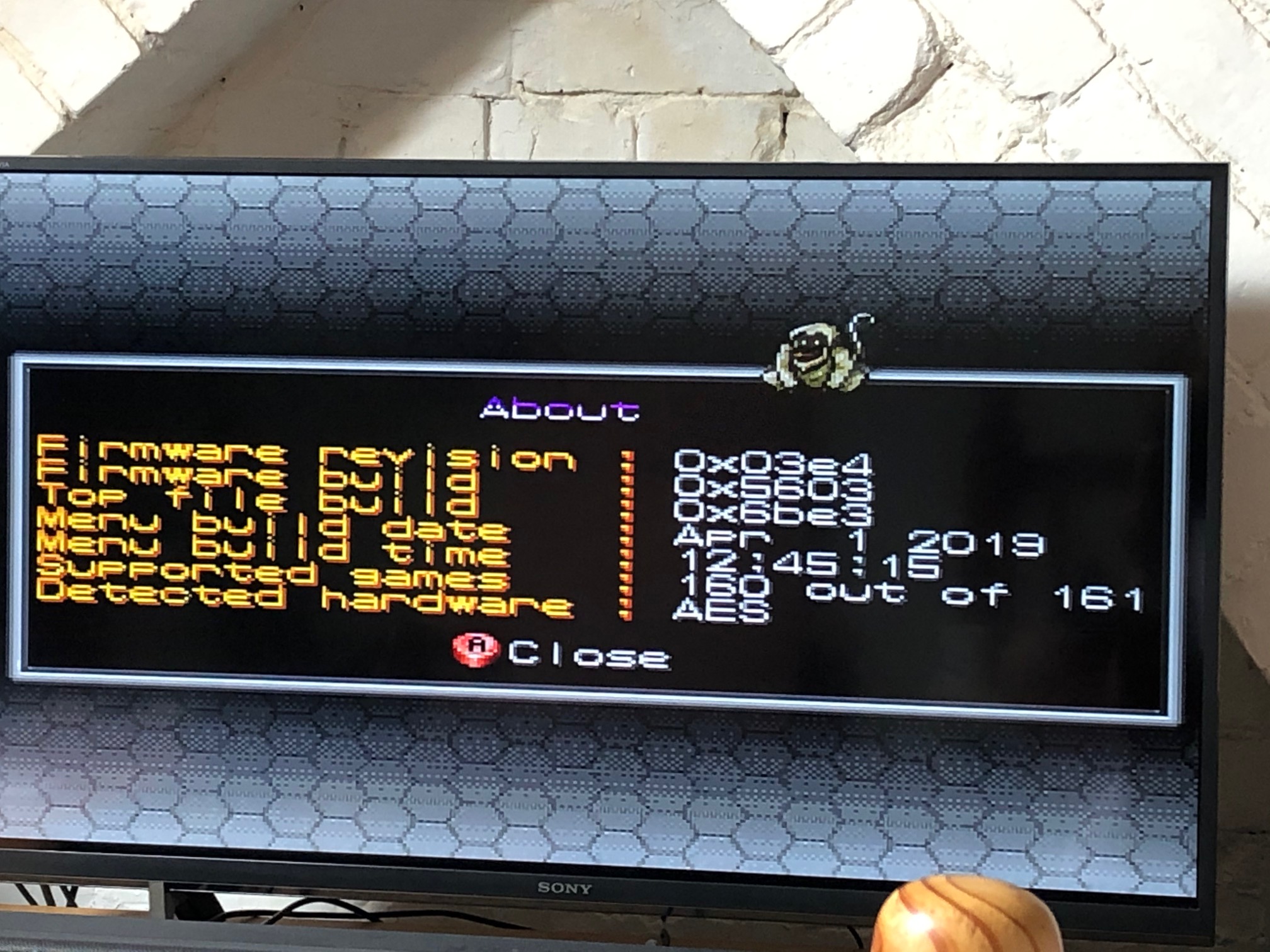

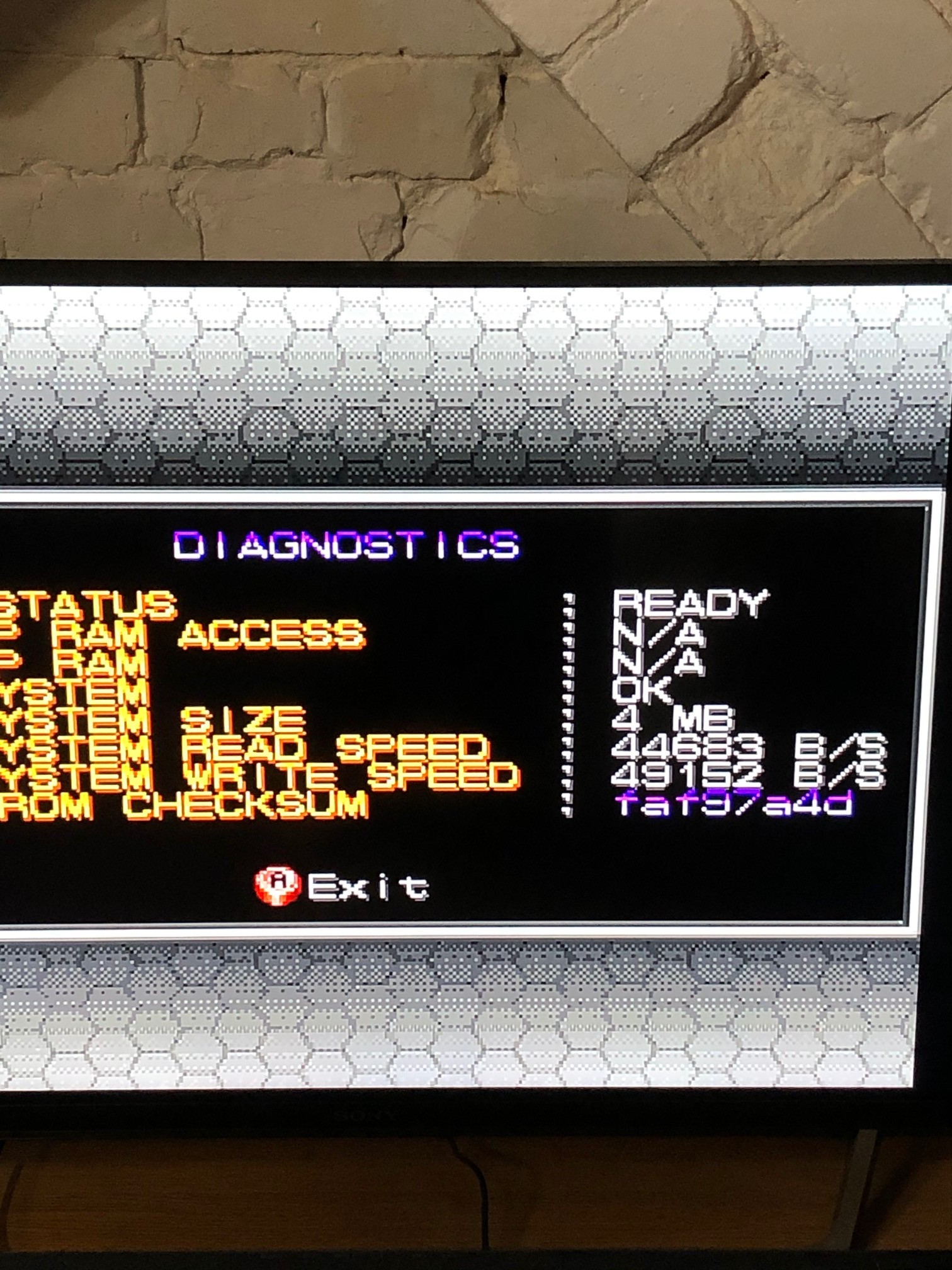

Hello every one,
As recommended by Darksoft, I downgraded to FW r996 and menu from 1st april 2019. I could install Andro-Dunos on slot 1 only, play a little bit without any problem then I remove and install MOTW on slot 1, no problem I could play 1 hour without any issu then moved to another game on slot 1, I removed MOTW and install Rage of the dragon, again not issu I played 30 minutes before changing again to the slot 1 with Windjammer and this time it was written please wait and black screen for 10 minutes. I had to switch off the console and rage of the dragon was still written on the menu I try again with another game but still not possible on slot 1. I went back to the pc to see if some file was remained. Buff, region and slot 1 was on the sd card. I remove them and add the sd card again in the cartridge. I start with reinitialization something like this the the menu restart. I tried to had a game on slot one but still no installation possible even if the slot was empty. I tried the on the slot 2 and it works. but then impossible to remove it and add another game.
I dont understand why after 3 times, I cannot remove and add another game ?
Do you have any suggestion ?

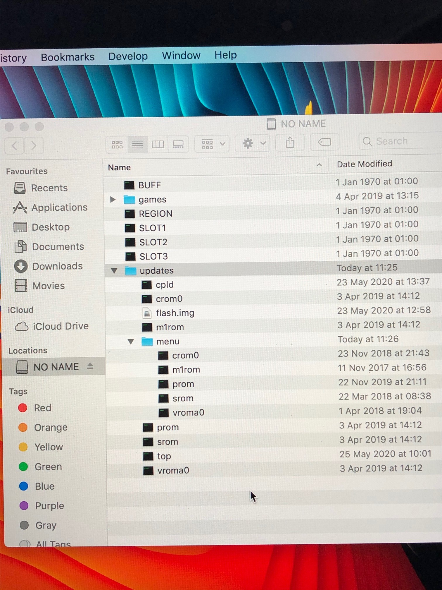

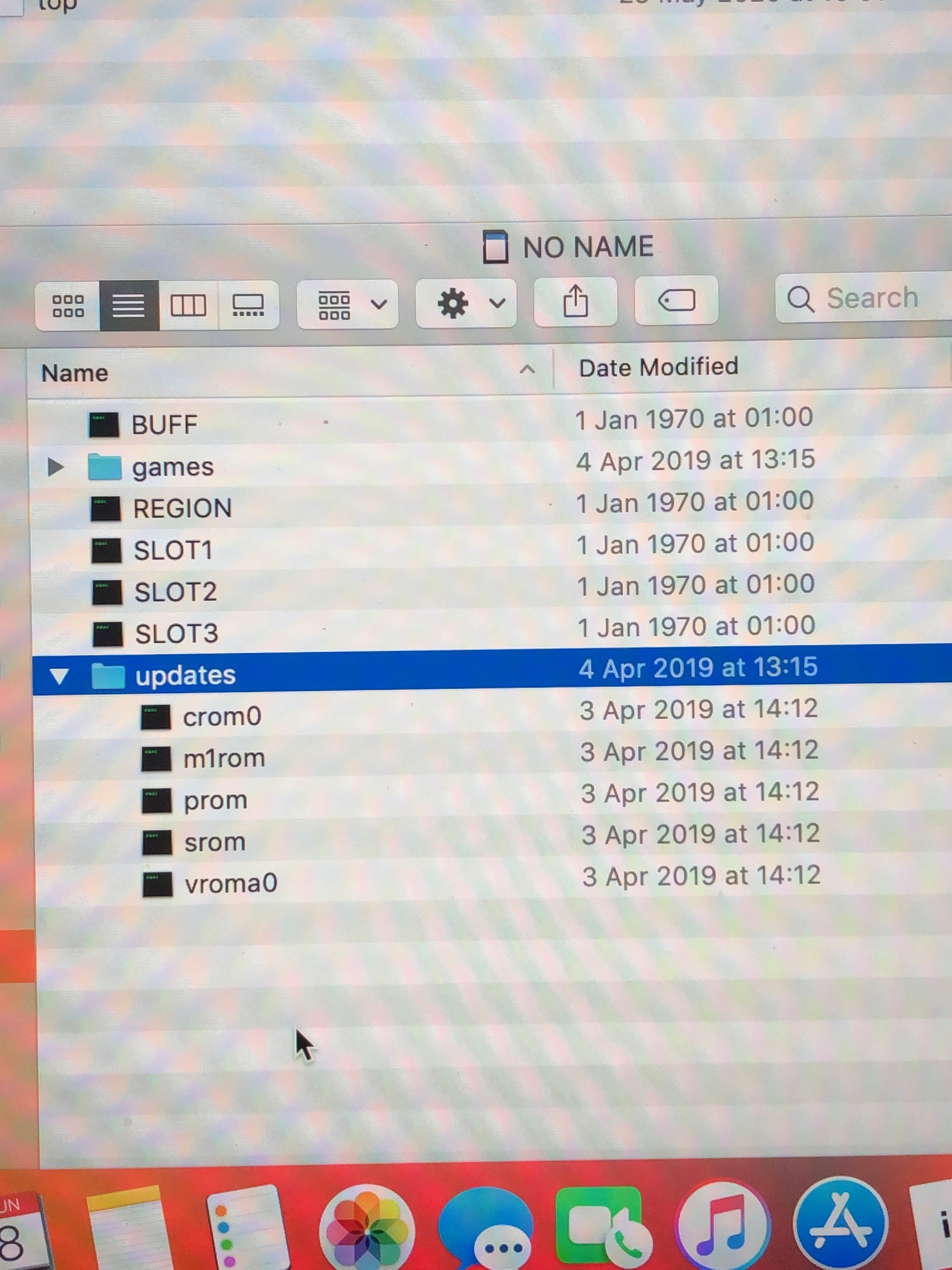

hmm I thought I could follow simple instructions but apparently I can't.
Have never updated anything on the cart since I bought it way back in the spring of last year. It's been ok, a bit of sound popping and dropping in some games but its been ok. (no regrets!)
finally got around to updating it and I genuinely cant work out where the menu and firmware go. Dropped the firmware files in updates and they haven't disappeared. I deleted the buff and on reboot it did an initialisation and seemed to do a firmware update but didn't I guess.
the new menu files go into a folder called menu in updates? or do I just overwrite the files in the updates folder with the new ones?
someone put me out of my misery please.
pic of current about after failed(?) the update and then one of file structure of card before I tried anything and one of what it currently looks like. ugh
any help appreciated ta

You almost got it. The folder must be called UPDATE, not UPDATES
and the update files go inside there. Notice that the Menu must go as a folder, so you will have \Update\Menu
and inside that \Update\Menu you will have all the crom0,m1rom, etc that correspond to the new vesion of the menu.
Also notice that the firmware files must be called "flash.img", "TOP" and "cpld". CPLD is optional. I mention the filenames because sometimes I pack them using a slightly different name like "flash_r110.bin", which should be renamed to flash.img
Let us know how it goes.

ok ta, the firmware files disappeared after the update as did the old menu files. does the about page now stack up ok? Thanks for the help D.

There is something wrong with your setup. Nobody has ever reported such a behaviour.
It looks to me like a power issue or a microSD issue. Try deleting manually the SLOT2 file and see if you can update now.
