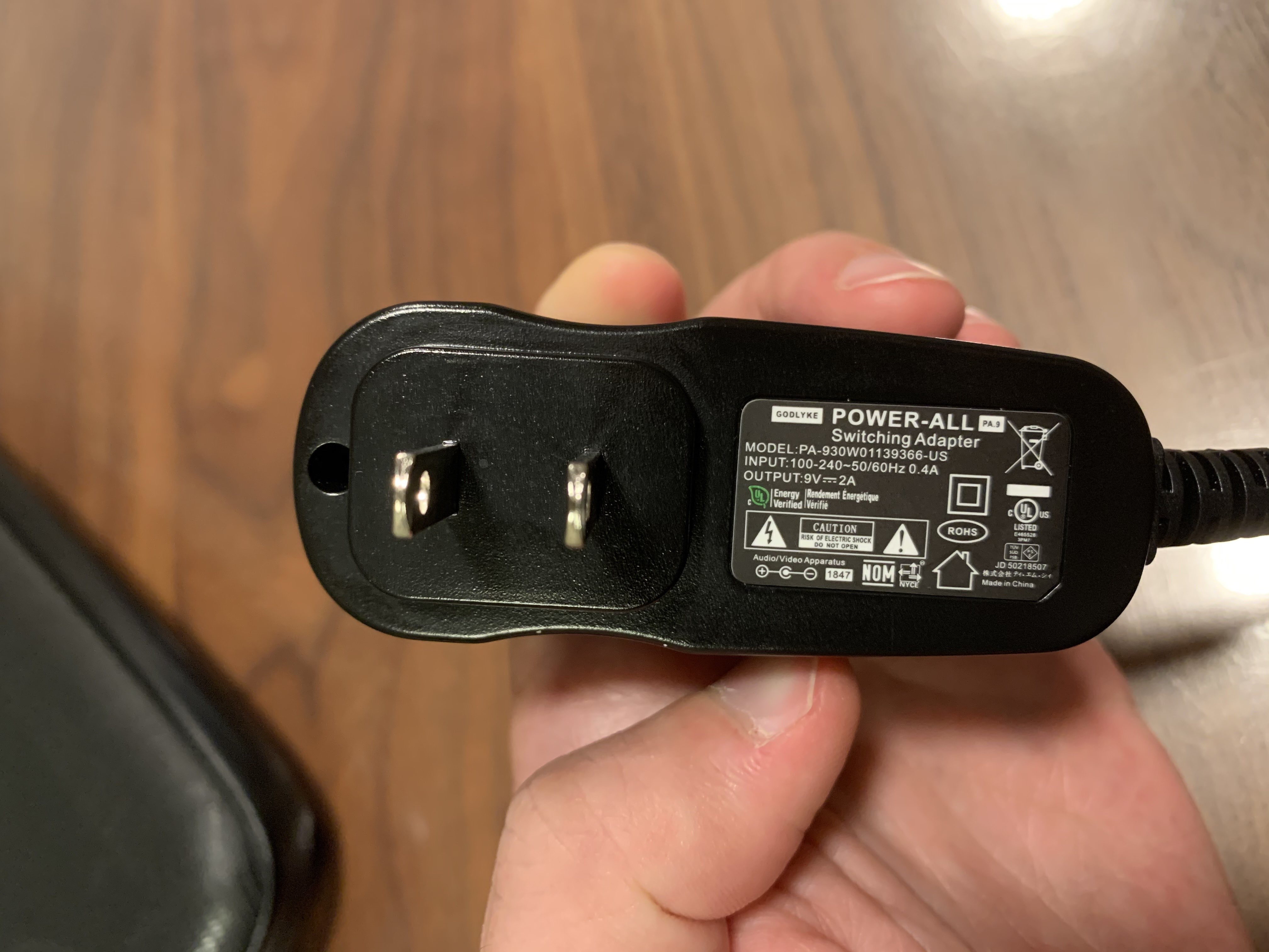

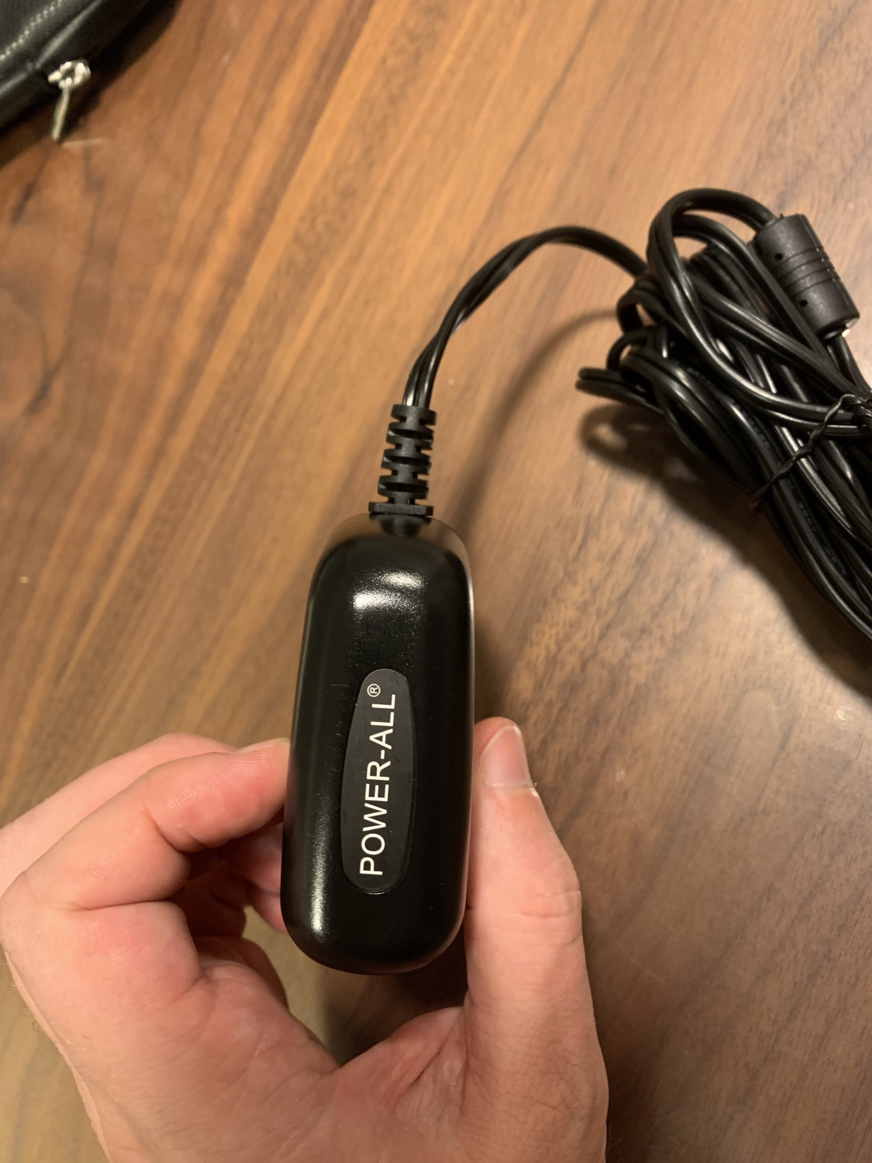

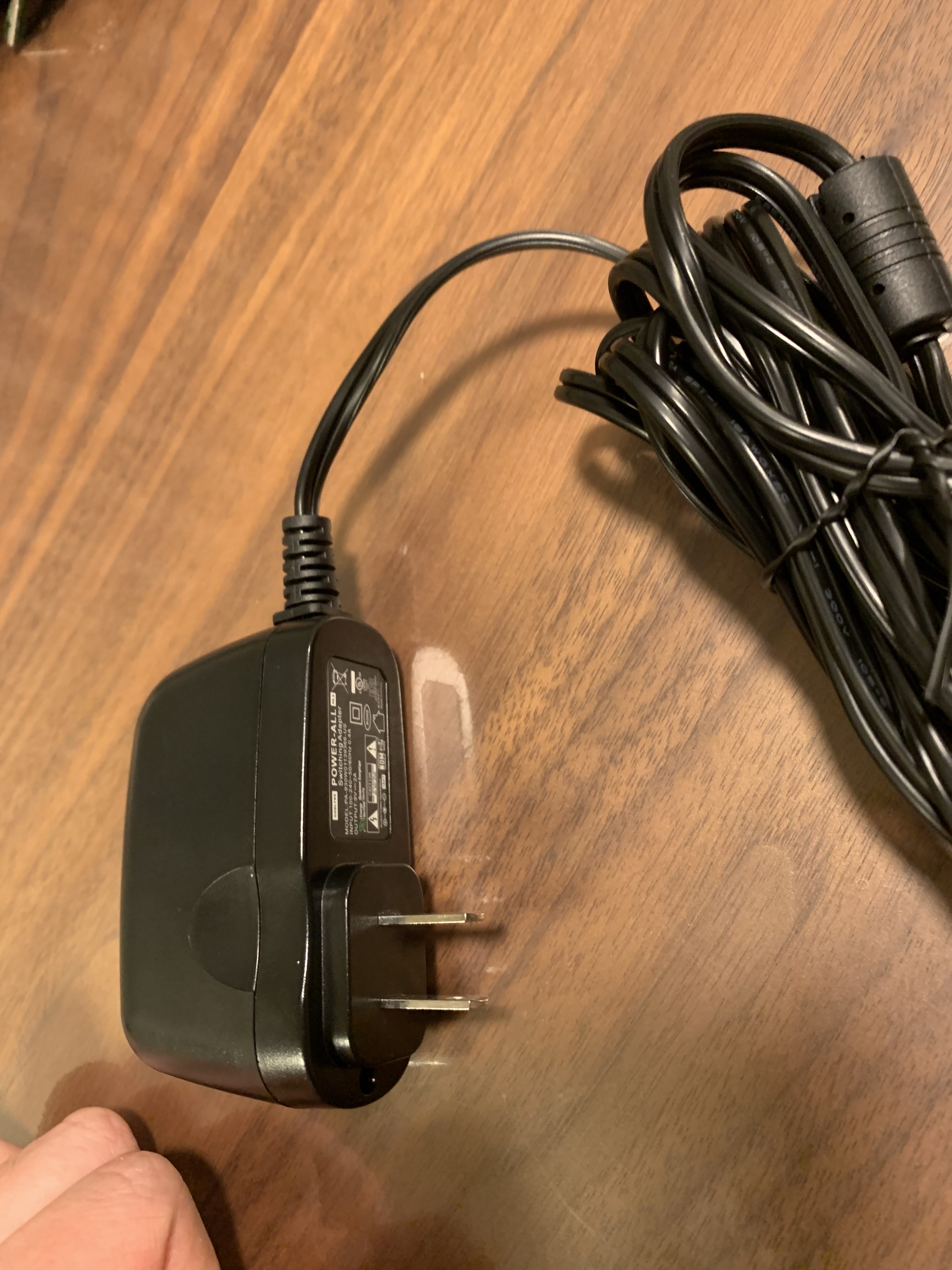

Due to the suspected problem of power that I have with the AES multi, I am posting here some picture of my PSUs : The first one is the "old one" bought in November 2019 and was working with the fw r1110 until April 2020.

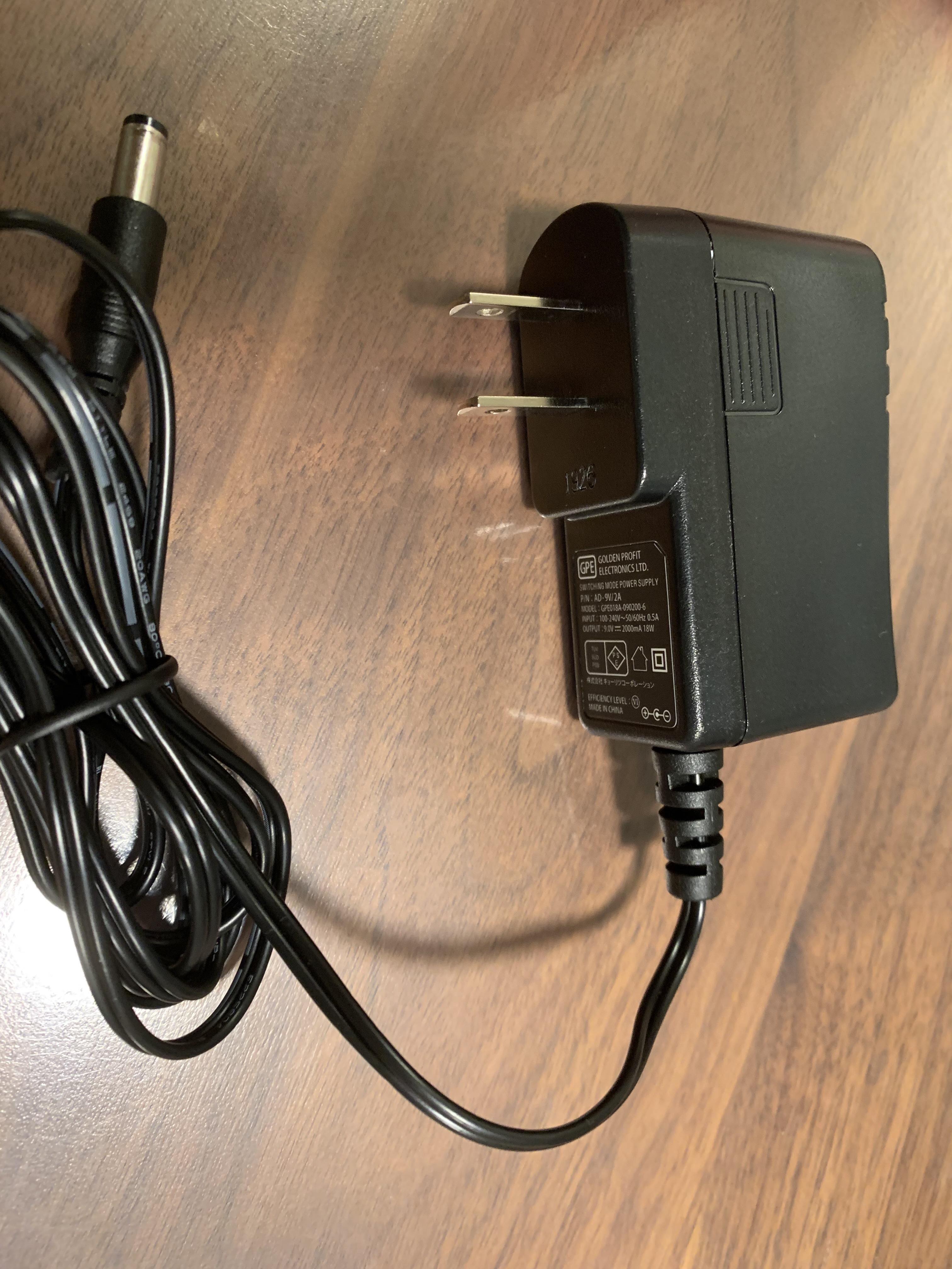

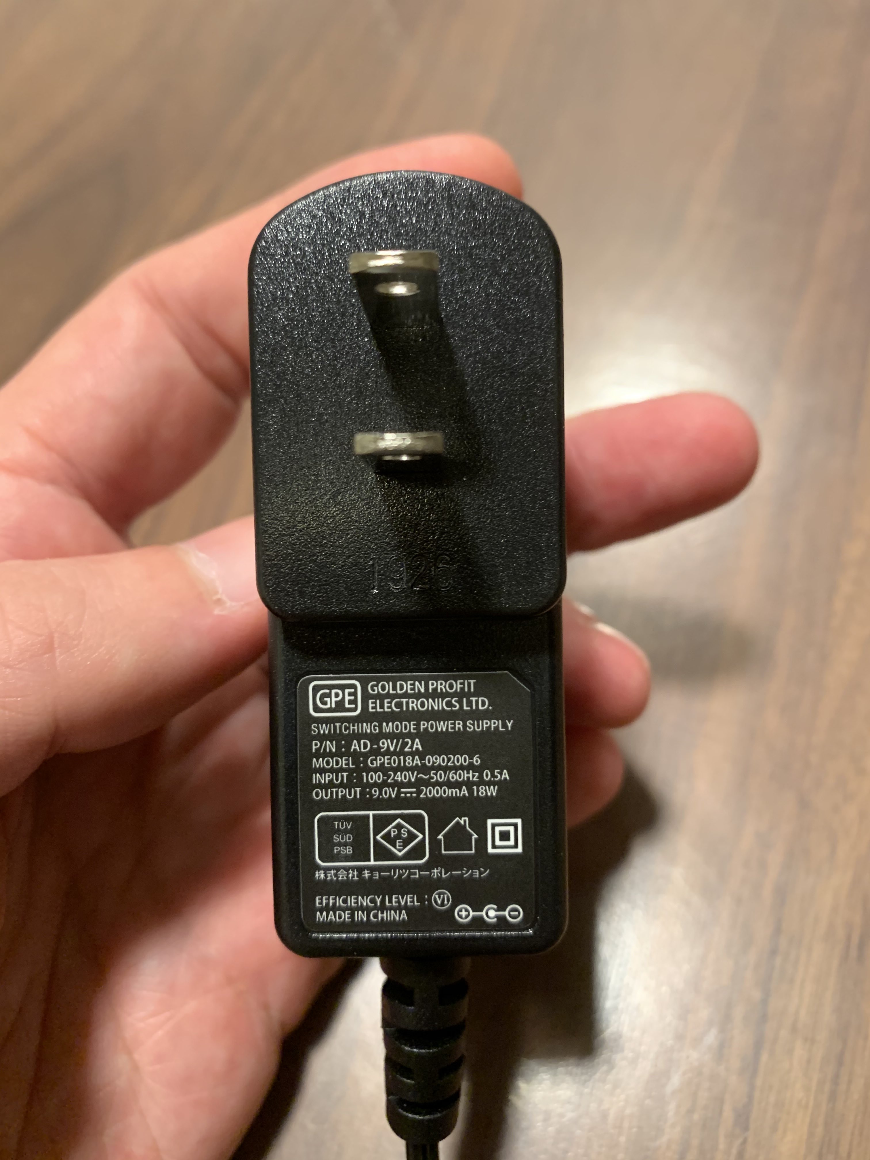

In this post I added some picture of the new psu I bought last week also suspected to be defective in term of reliability.

What do you think about the two psu ? Do they look bad quality ?
