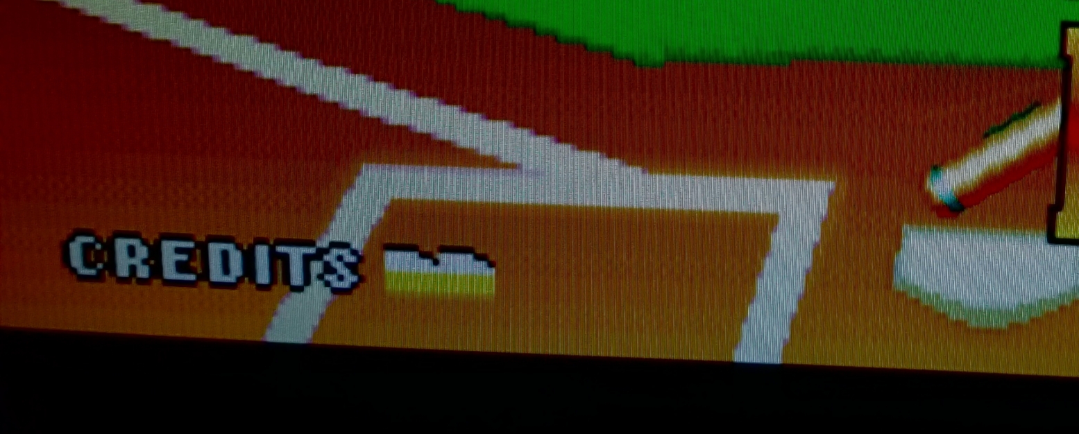

Hello All,
I am having what I think is an issue. When in MVS mode I get no credit counters. When I rest the console it goes back to the default AES/JPN bios setting. Also, Breakers Revenge does not work at all. But, Ganryu does. I have included some pics of the screen showing what the credit counters look like in game. I am using a JPN AES with Pro PoW 3 AC adapter. The board revision is 3.6. System number 271697.

Hello All,
That is normal. The AES has no backup RAM so it will show some other values. IF we implement someday BackUpRAM, then you will see like in the MVS.
