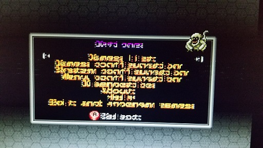

Sometimes the menu does this when I hit up and start to return from a game, this picture was taken when I was using the Sandisk Ultra Micro Sd.

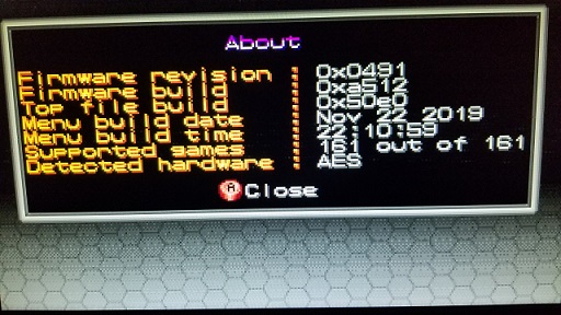

Here is my About screen so that anyone that can help can know what FW I am on.
Thanks
