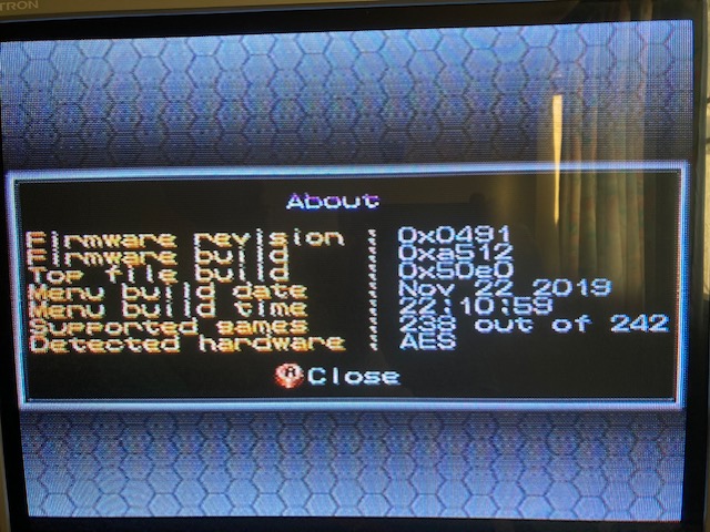

@BRAKKUS1 you have AES 3-6, right? What version show the ABOUT section of the menu when it worked well and what shows now?

I've been enjoying my AES multi cart for the past few days. It's been mostly great, but I do have a few issues with MVS mode
My system:
AES 3-5, original Japan BIOS
multi cart:
FW rev: 0x0491
FW build: 0xa512
Top build: 0x50e0
Menu date: Nov 22 2019
system config: MVS mode, Japan
I found that only the 1st boot of the game (or 1st boot after switching to a game) works in MVS mode. Hitting the reset button puts the game back to AES mode.
Matrimelee in MVS mode defaults to English, even though I've set it to Japan from menu. AES mode switches to Japan region just fine.
Crossed Swords in MVS mode reboots itself right at the "how to play" screen. AES mode works just fine.
I've not tested comprehensively and these are just ones I noticed. For reference I'm using the ROM pack from SmokeMonster's thread.

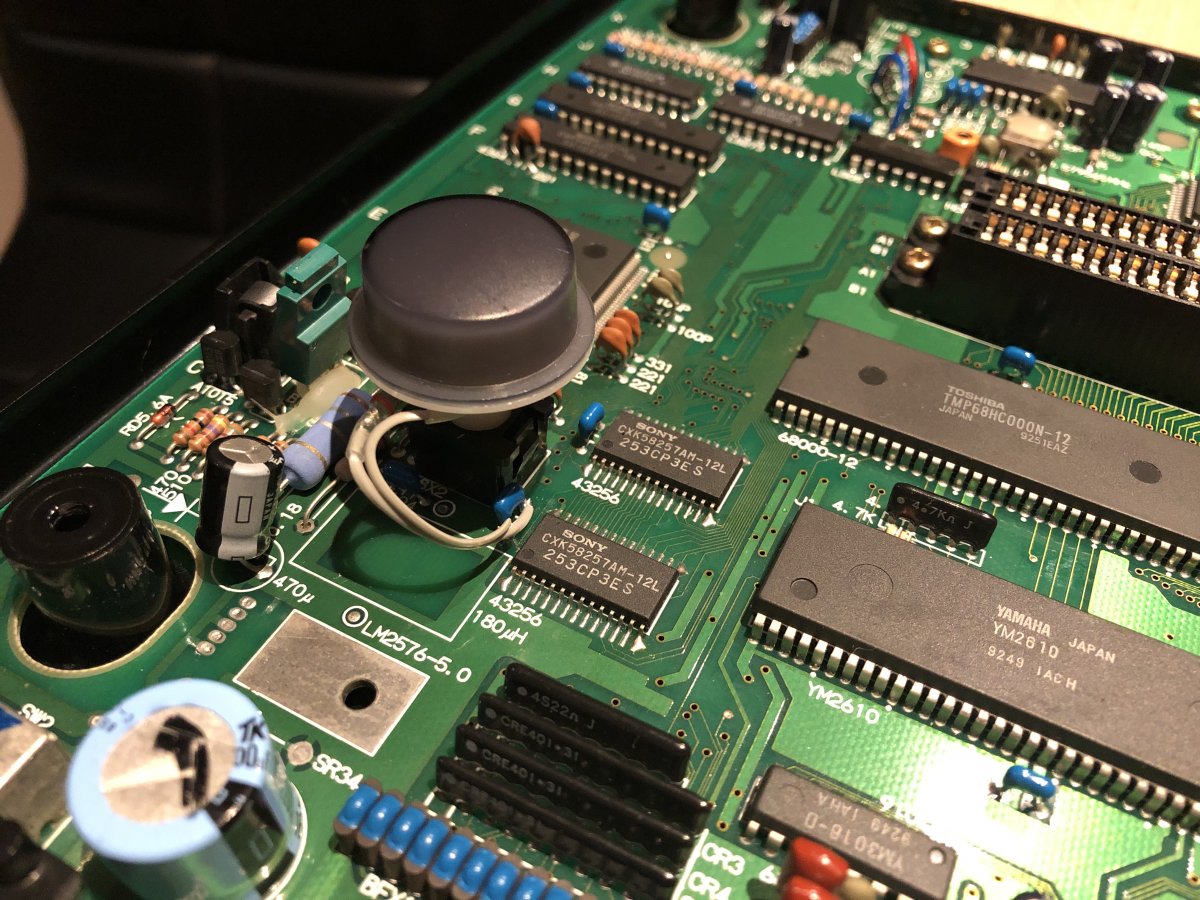

Hello I also own a Aes 3.5 and used a 5v 10A PSU that was controlled with true RMS multimeter at 5.03v and I also faced strange reboots . I ordered a official pro-pow 110v to 5v DC Adapter when I controlled the voltage I have with the same multimeter 5.48v !
No more glitches and strange reboots ... I also changed the 2000uf cap for new one this solved also few issues . In the 3.5 Aes you have a green switching regulator that needs voltage higher than 5 v to supply 4.9 v to the chips ...

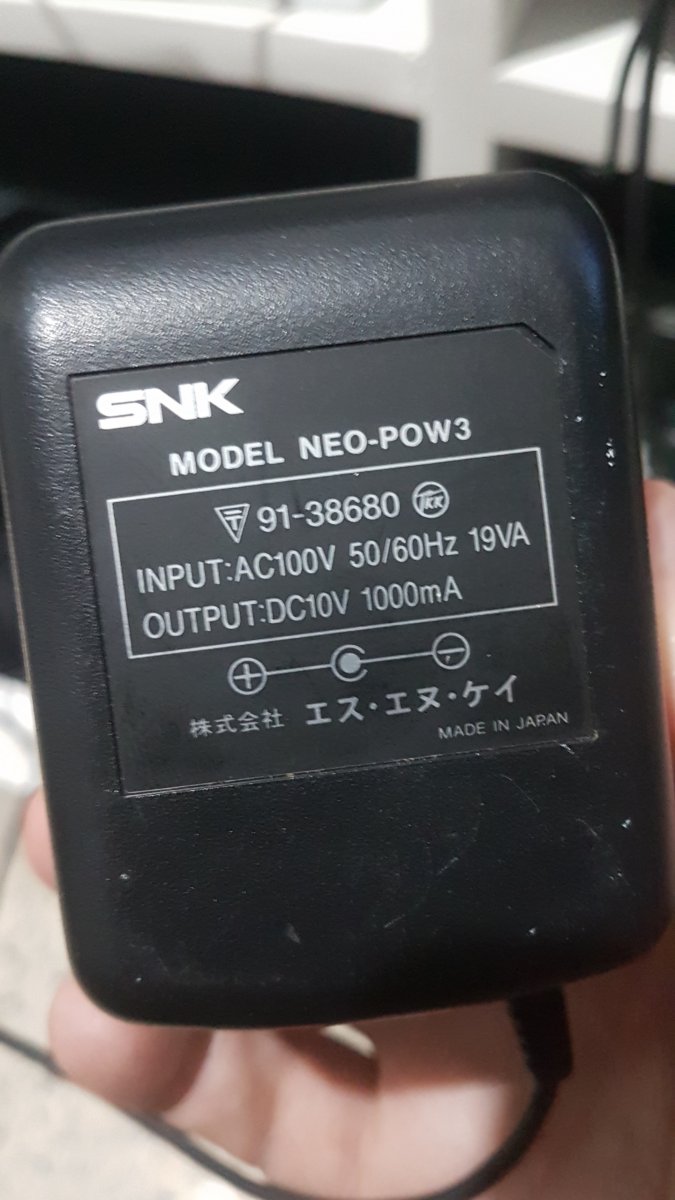

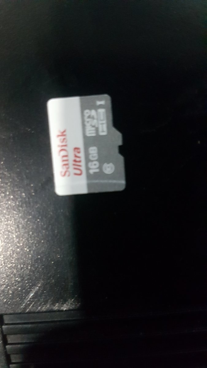

I didnt have time to use it till this saturday, so i follow all the steps /tutorial given by team Darksoft, but, i have a blue screen each time i start my console, i download the last AES firmeware and menu, i creat 2 folders on my Sandisk SD Card (games + update) i put the new menu inside update/menu and the roms inside the folder games, but nothing worked, there is a little glitch and pixels (brouillan) in the begining and after that the screen become blue and nothing happen, i waited 30sec and more but nothing happen
So changing the PSU for a Pro.Pow fixed the problem for you, right?
Was it working when you received it or did you always get the blue screen? It looks like a PSU problem to me. The one that you have is not giving enough Amps.
Please check here: https://www.arcade-projects.com/threads/choosing-the-right-aes-psu.10221/
Was it working when you received it or did you always get the blue screen? It looks like a PSU problem to me. The one that you have is not giving enough Amps.-

I got the blue screen from the beginning, from the first time i insert the cartridge and start the console, and just to let you know that i have some AES games that work without any problem,
so for you the problem maybe from my PSU, i will check your link and i will order a new one with more Amps, i hope it will resolve the problem, :) i really appreciat your product (and spirit of making thing with passion. Merci) ,
Thanks again and i will try to come back with good news as soon as i receive the new PSU

Hello Darksoft yes using a PSU that delivers 5.4v and recap the 2200uf cap definitely reduced the glitches there are still some in samurai V perfect.
Could you give some information on what power is drained by de multicart Aes cartridge in amps ? As the standard official cartridge all work perfectly so I assume that the power requirements are totally different. Would increasing the 2200uf cap to 4300uf help ?
This cartridge requires more amps than a regular cart. Also the original carts have mask roms which are much less sensitive and voltage tolerant.
Definitely increasing the cap could help solving that. Give it a try and let us know how it works for you please.
