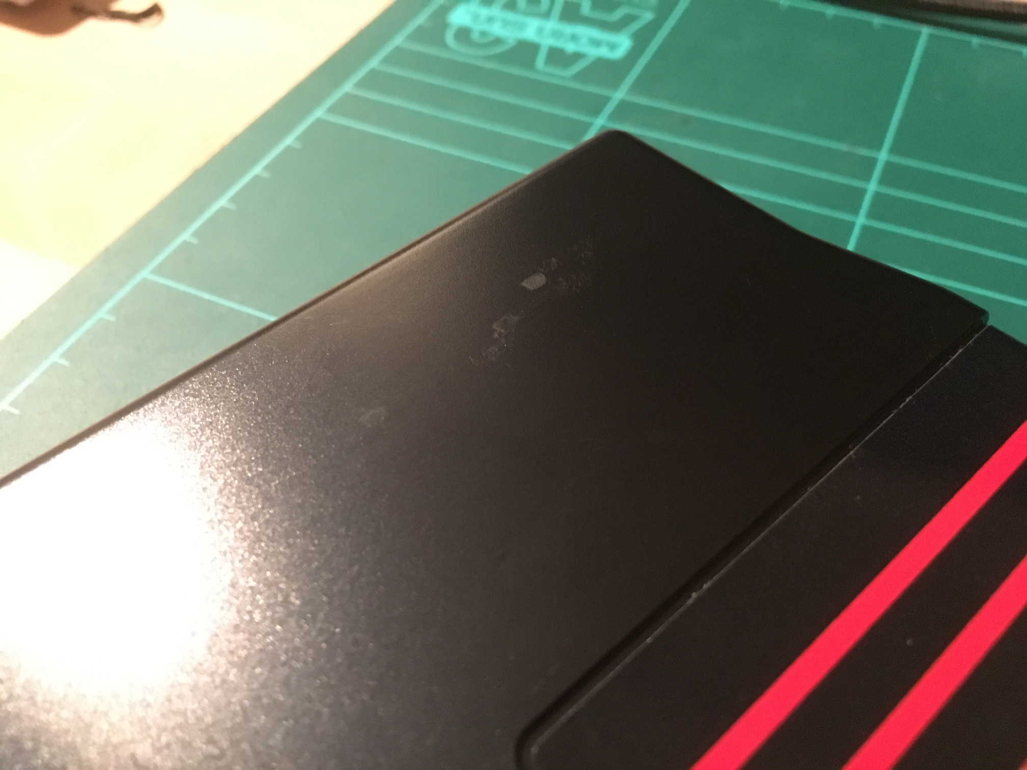

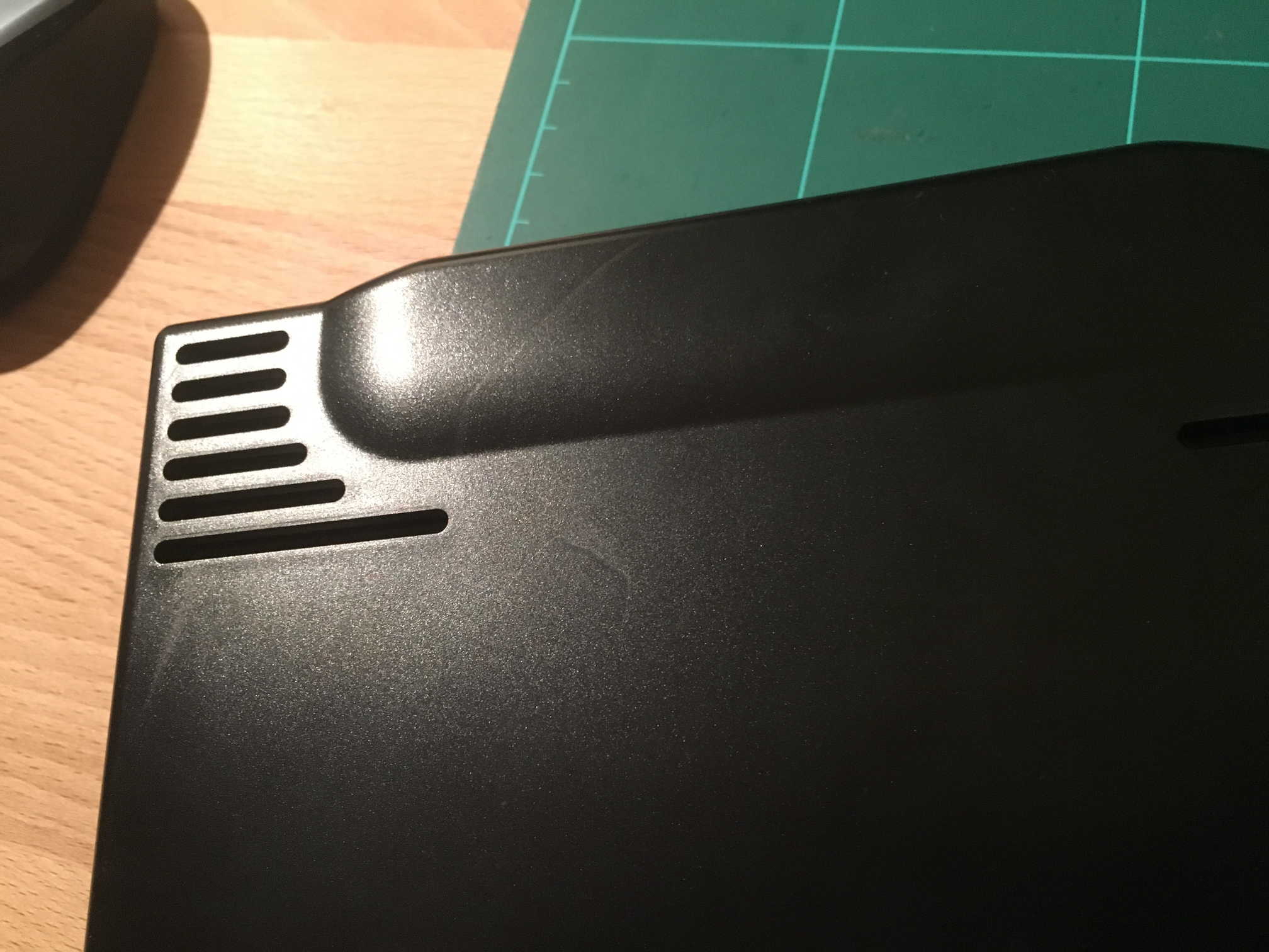

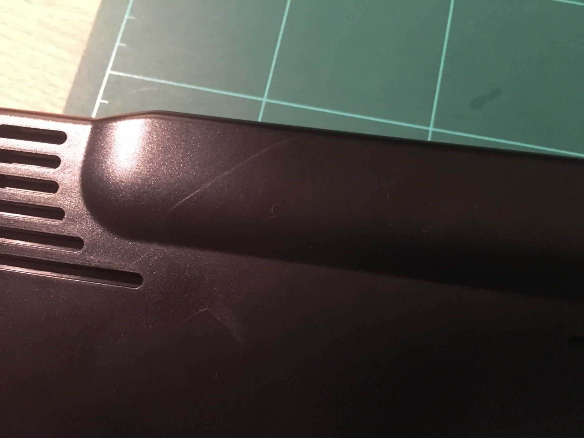

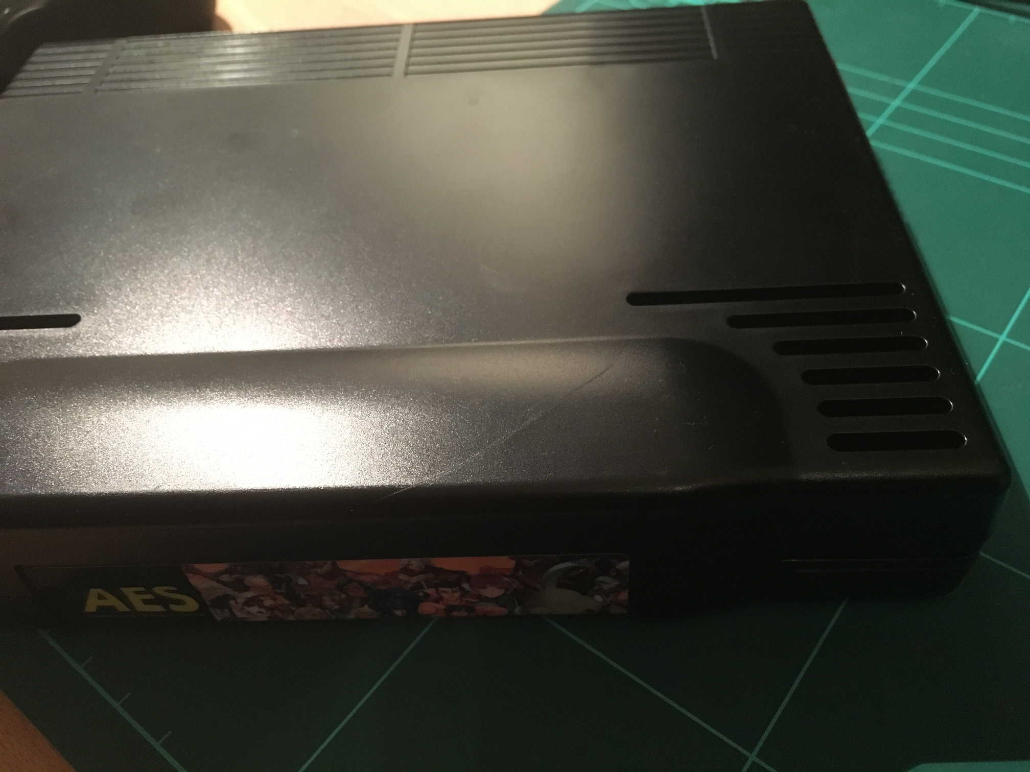

1.- @CPZ - SAVEYOURGAMES can you please let us know what may have happened here? All the shells are new. @quadratic can you post a picture?
It's hard to really capture the problems with a camera, but see attached pictures. Please see them at full size.
It's mainly a large scratch on the top/back of the cart, some smaller scratches here and there, and a variety of imperfections that look like specs of dirt but are actually permanent.
Again, I know that it's not game breaking, but considering the cost and that it's a new shell I assumed that it would be in a mint condition.
And it's always frustrating when you have a great item in your collection that is not as perfect as it should be! :D
I agree with you. That shouldn't happen and it should be changed. Let's wait for Aldo to comment on this please. @CPZ - SAVEYOURGAMES
It's hard to really capture the problems with a camera, but see attached pictures. Please see them at full size.It's mainly a large scratch on the top/back of the cart, some smaller scratches here and there, and a variety of imperfections that look like specs of dirt but are actually permanent.
I am sorry cause Your seems with more signs than other but, in production is very difficult to Don't some signs in it. It's hard to explain, but for find the right material for this Shell we have done many compomise, this is the best that we have find. Many material used in the past now are out of production. All pur Shell can't be Perfect At 100%, we always do the bes as we can.
