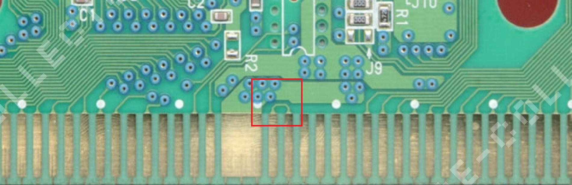

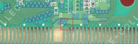

We've finally found a fix for the people not having sound on the NEO-AES models. The fix is a simple jumper wire as it can be seen in the pictures below. This only affects to user installing the multi on a NEO-AES console and will be fixed on the new units produced.
For those of you that have this console, we believe that this is a very simple fix but it has two dangers, one is that you can break the plastic shell when opening it and second it that you need to have some basic soldereing skills in order to make the fix. If you are unsure about how to do it, I advice that you sent it either to Mitsurugi (if you are in the USA) or to Aldo from Saveyourgames if you are in Europe. People from other regions can choose either one.

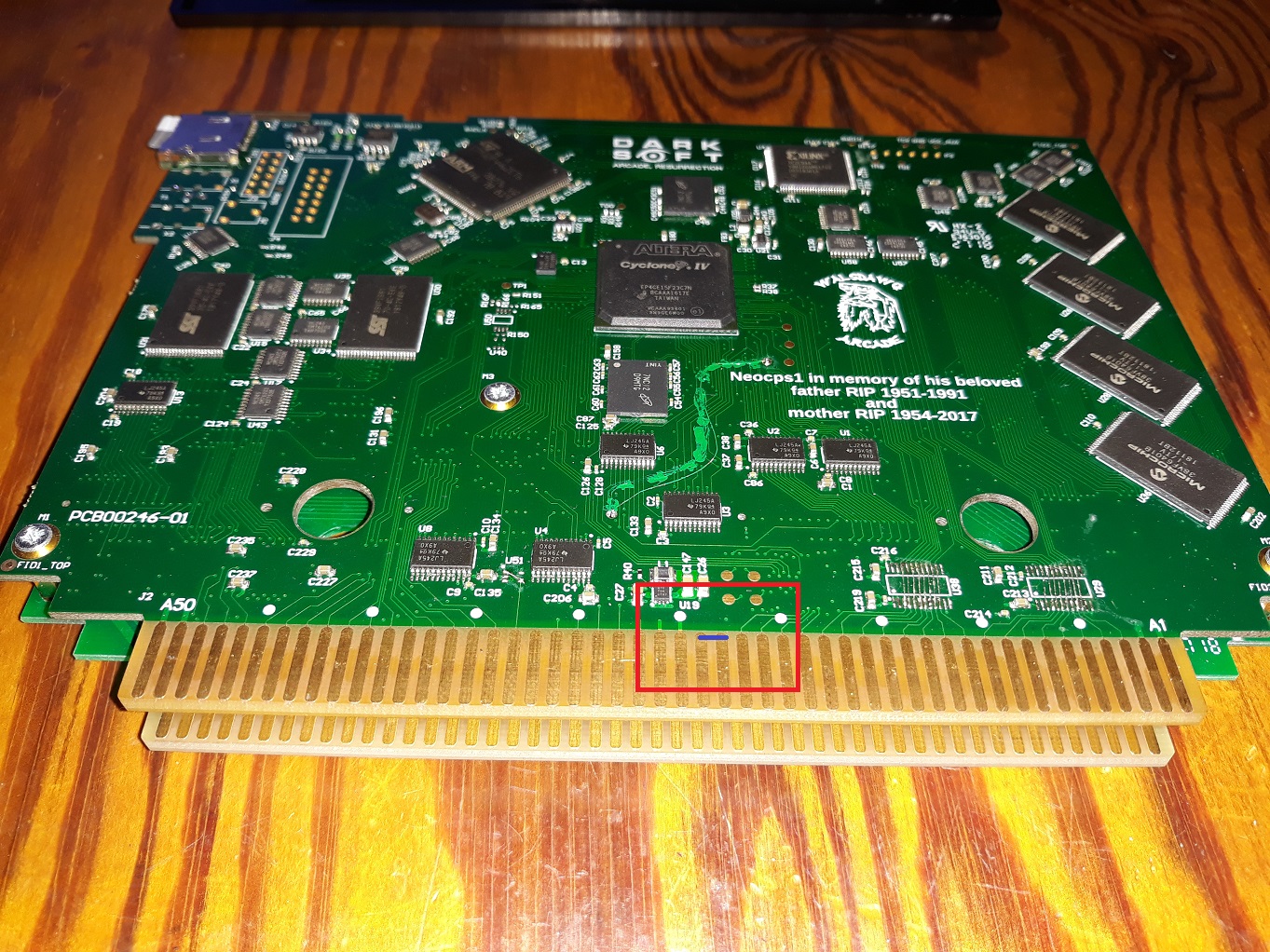

Here is a more detailed procedure about how to install the jumper wire on the cart.

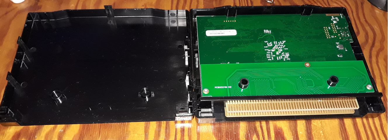

1st of all, you need to "very" gently open the plastic case as can be seen here:

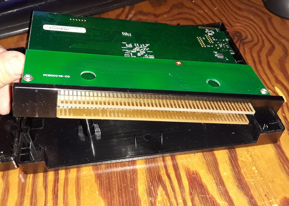

Now we need to remove the cart by lifting it from the left side:
The thirst step is to extract the PCB and install the jumper wire (blue line) between the pins A23-A24 as can be seen in the edge connector. It's inside the red box.

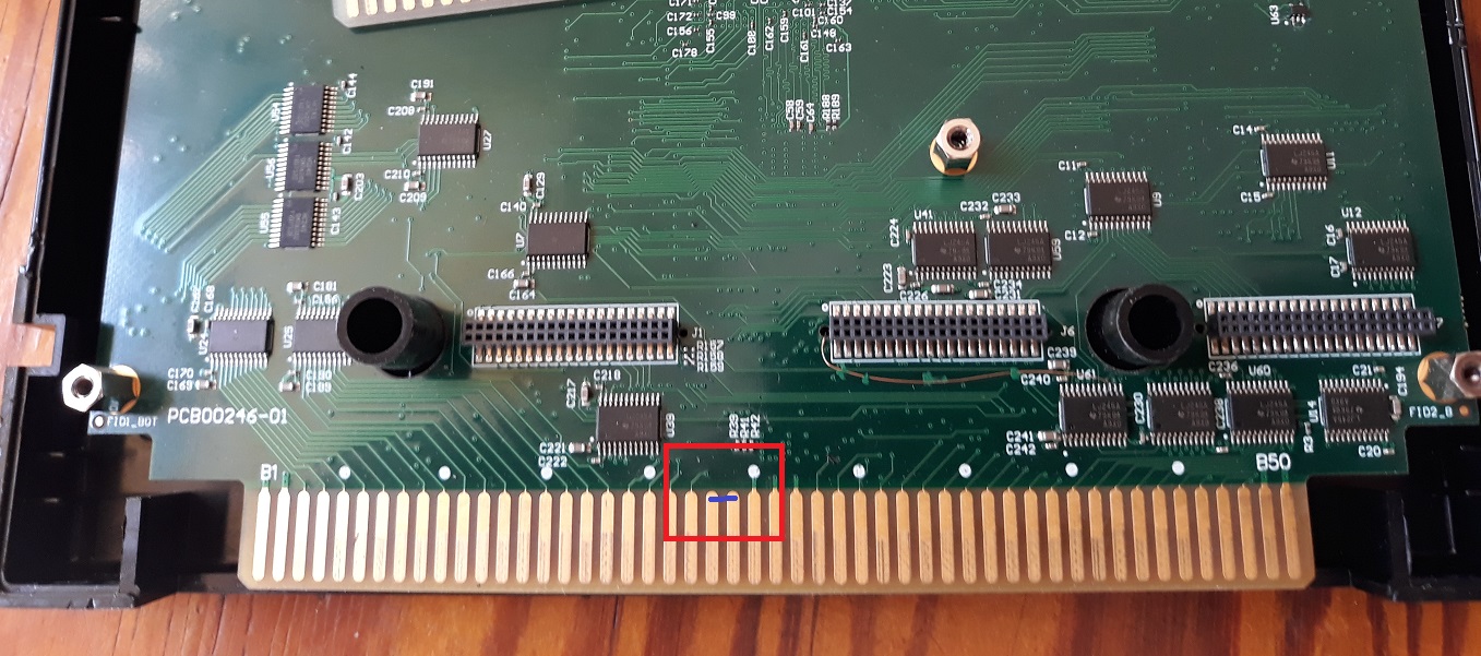

You also need to do it on the other side as well for pins B23-B24.
You only need to do this if you run the cart in a NEO-AES console. If you don't feel confident to do this fix, please send it to us.
