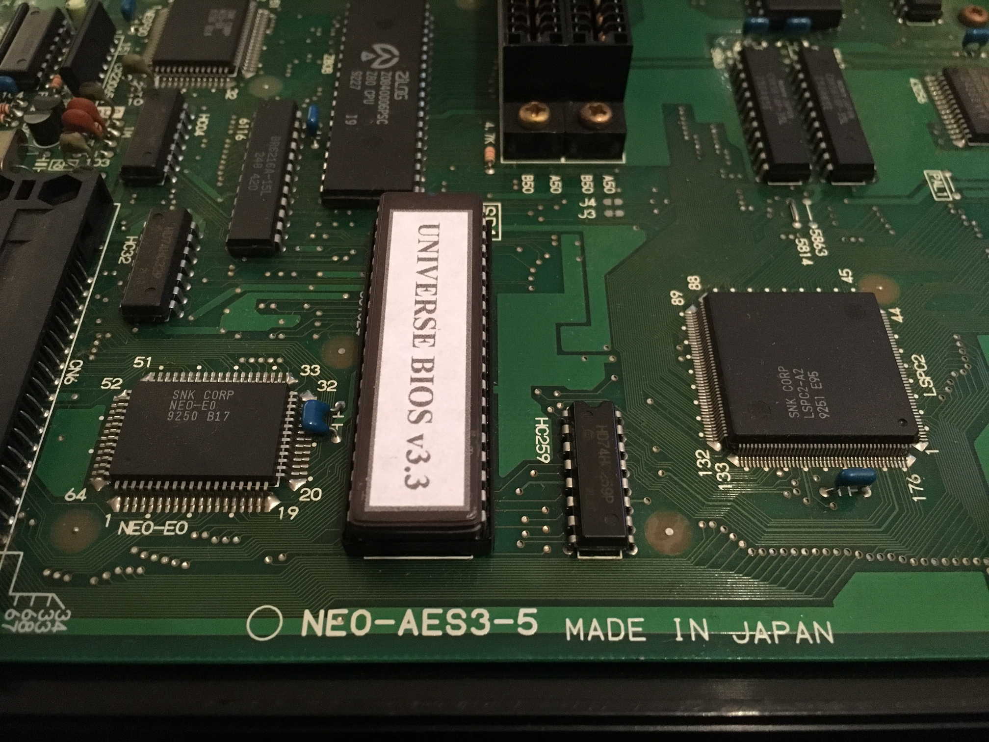

2 - My console is a 3-5 rev with a 3.3 unibios. When running the cart the console is stuck in a reset loop. I see the unibios boot screen, a 'Checking Games' message and it immediately reboots and the same happens. Over and over again. I tried several SD cards (Samsung, Sandisk, with varying sizes) and it doesn't change a thing.

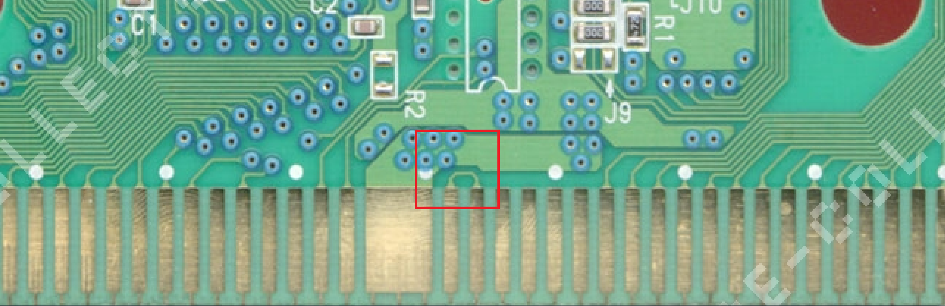

Nothing to worry about guys, this bridge is present in all AES carts and is simply a loop for audio used on NEO-AES. It's documented on the neogeo wiki.
Here is a pic showing how original carts have it.

2. I don't have a memory card. I already tried deleting the BUFF file, no change. Model number is NEO-AES3-5, see attached picture.

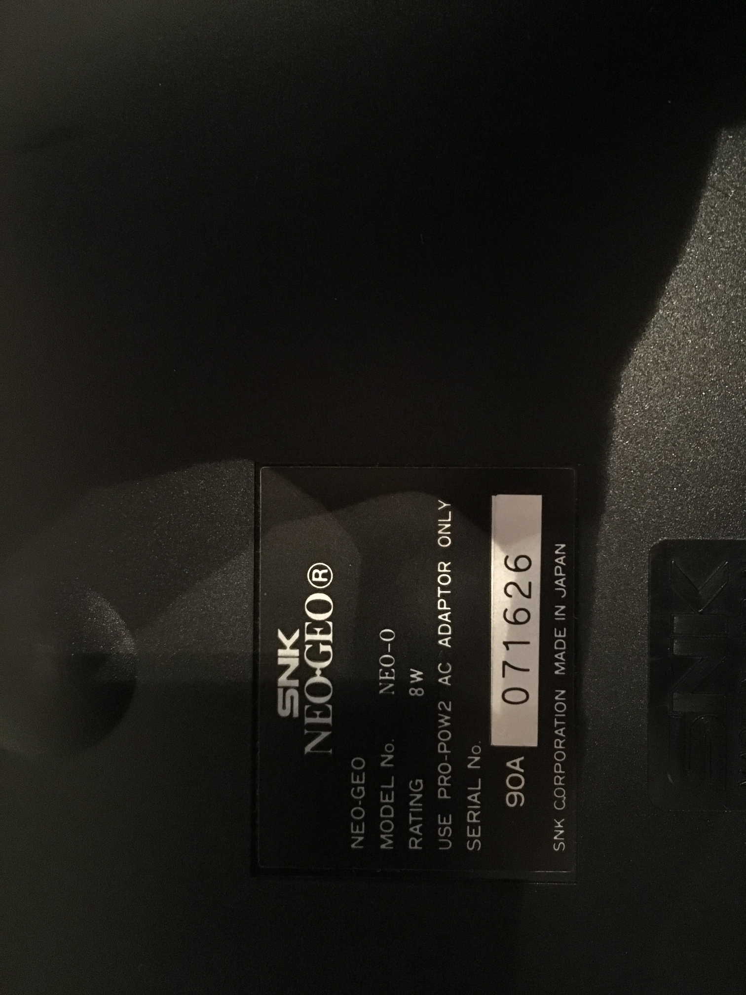

The sticker at the bottom of my console says 'Use PRO-POW2 AC adaptor only' (see attached picture). AFAIK the PRO-POW2 is a 5v 3A psu, hence why I chose a 5v replacement (at the link posted above).

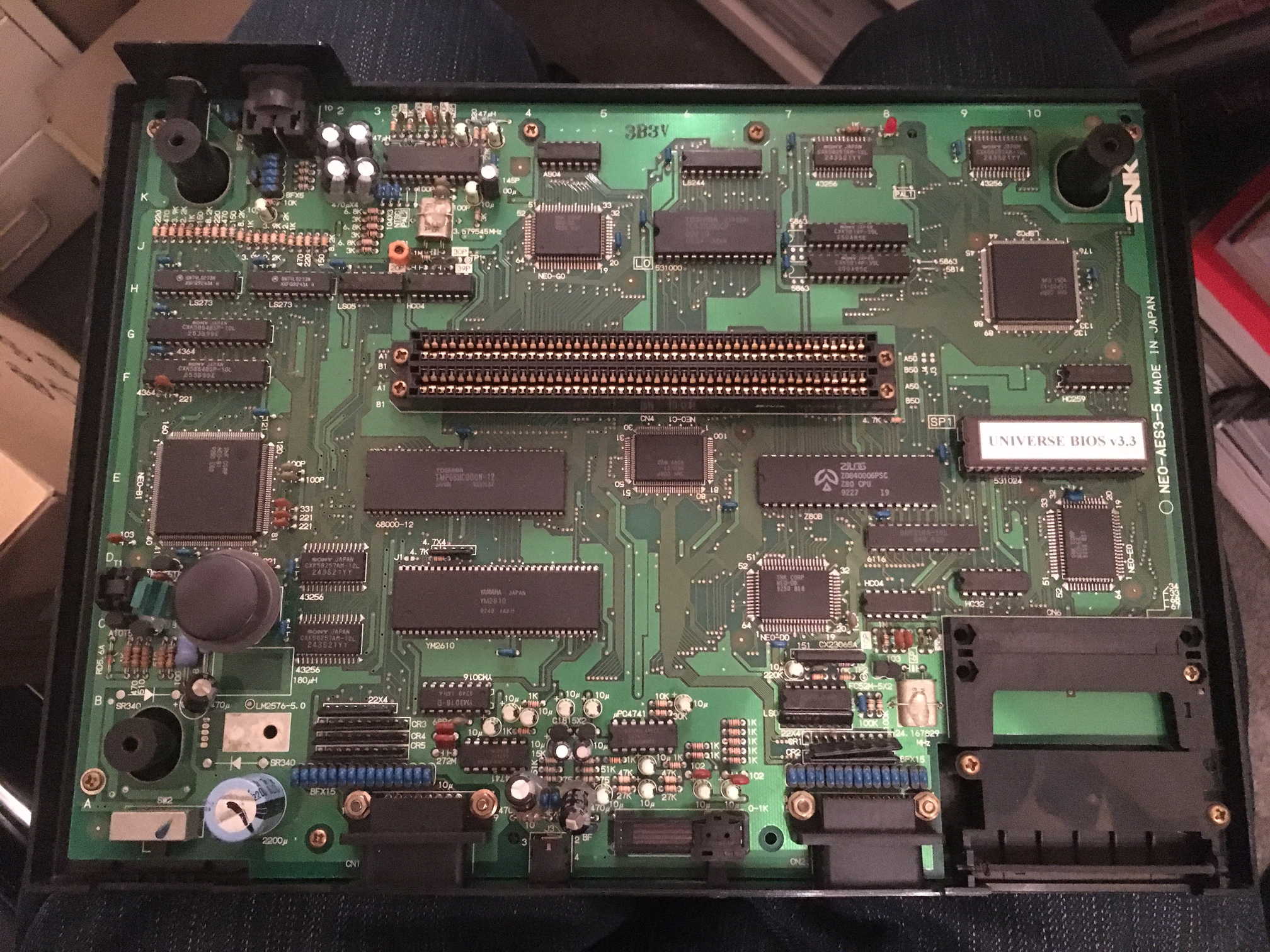

Now there's a possibility that the motherboard got switched in the case and that the sticker is wrong, I wouldn't know how to check which voltage is correct from looking at the components though... But that would indeed explain it.
Is the picture of the inside I posted enough or do you need a broader view (when I took this one I was only thinking about capturing the revision number and the bios)?

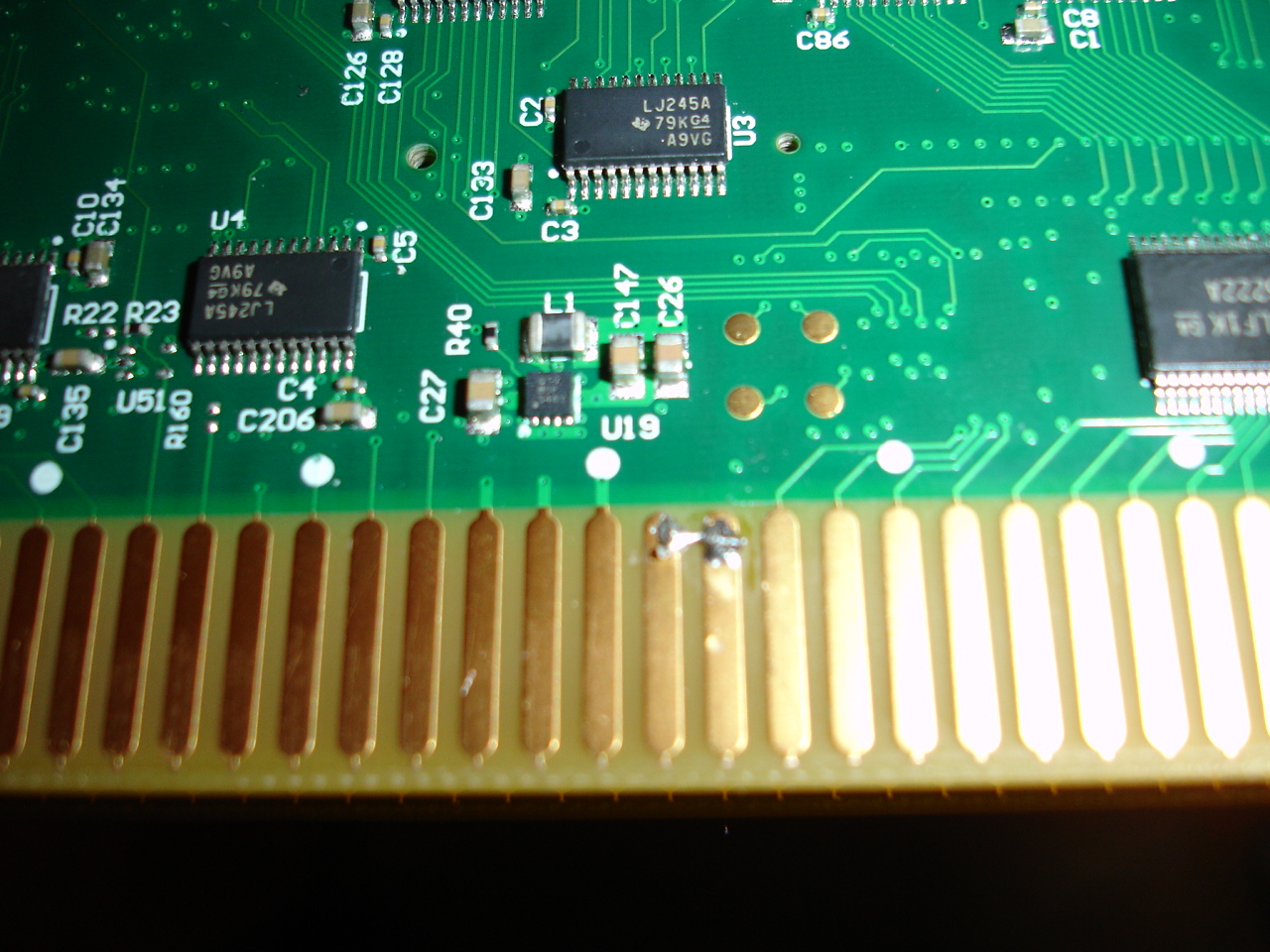

I still get no sound! I get continuity between the joined connectors, so I know its soldered correctly. My power plug is 5v 2.5a I can try with a slightly higher amp rating tonight. Pic below of bridge
I am no expert! But I tested continuity on a real AES cart on the pins in question and indeed they are joined. I then tested the other side of the PCB and they are also connected. The AES multi cart the pins are NOT connected on the underside (solderside)
Should I connect the 2 on the other side as well? Cheers
You did it for pins A23-A24 and you need to do it on the other side as well for pins B23-B24. Sorry if I wasn't clear.

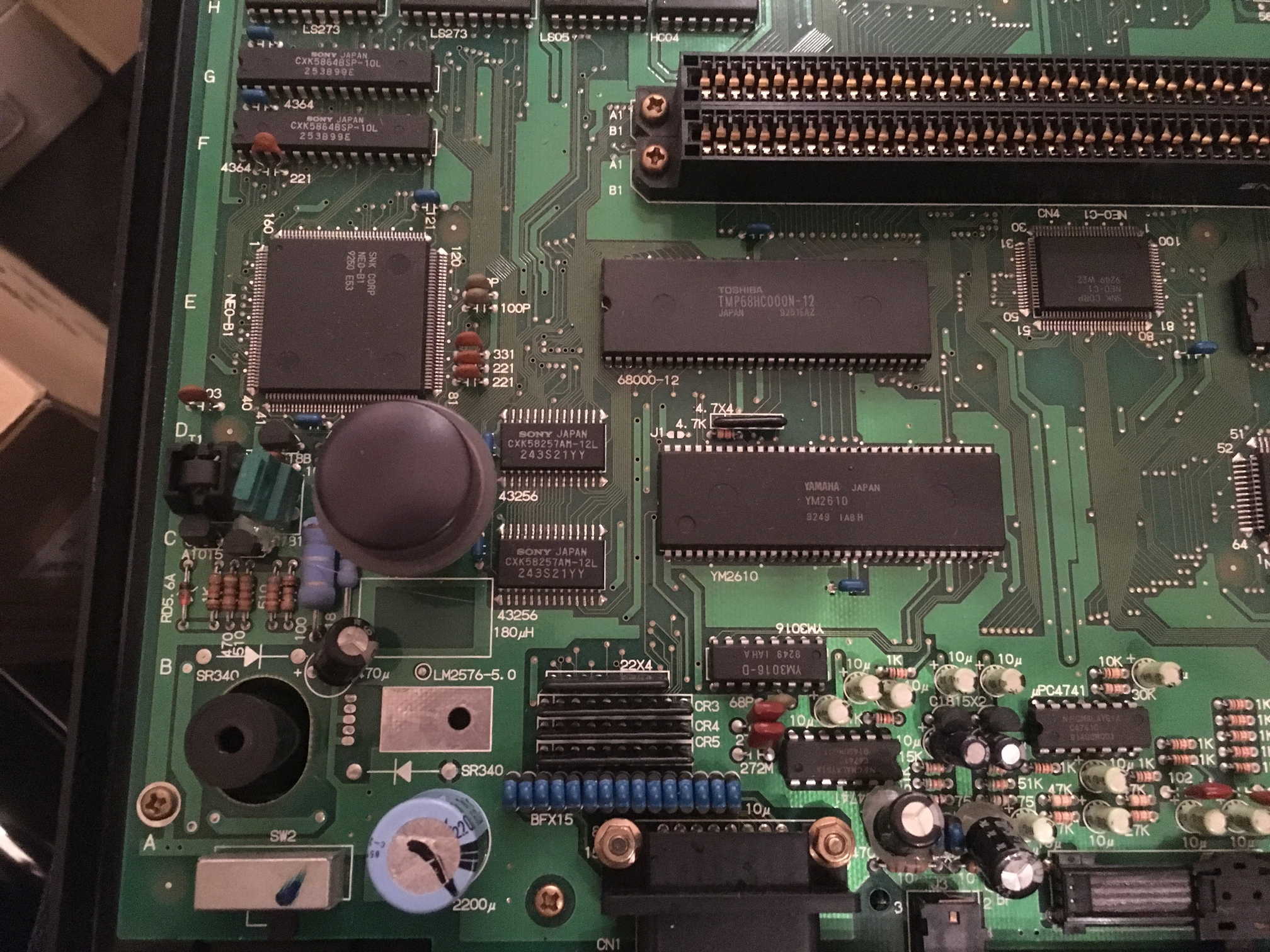

@quadratic I need to see the whole motherboard, no need for high res pics though, if there's a coil close to the reset button then you have a 9V model.
See attached pictures. No coil, unfortunately. That would have been an easy fix to the problem if it turned out to be a 9v unit.
But then, what could cause this? Any idea what I should check/try?
