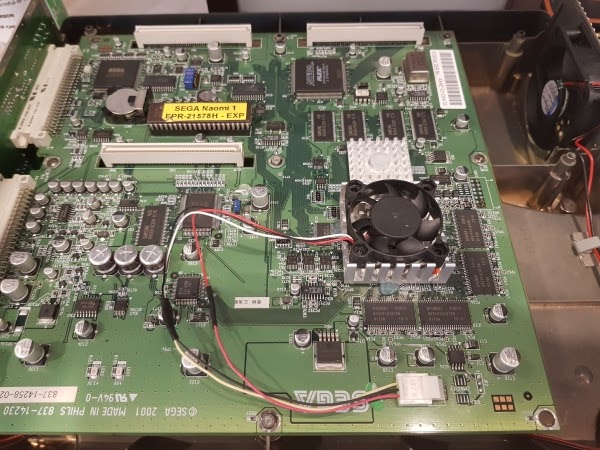

SH4 SCIF is accessible on N1 via cart connector CN1:
B45 = RXD
A46 = TXD
The signal is UART, not RS232 compatible to directly connect to a modem (need to use a transceiver chip like MAX232N). It is compatible to connect directly to various types of FTDI usb/serial cables if you want to talk directly to PC instead.
B45 = RXD
A46 = TXD
yes; so a original classic Naomi would need to be gently persuaded with a small modification chip; or have an Arduino pro micro soldered in (the correct) spot with a serial repeater sketch...like in my photo...but I was getting garbage data from the RS422 plug.
I'm out of town right now; I'll have something down as video when I'm back.
Also jp13 is the maple Gnd and and the AICA clock cart/board switch is jp1

I got modem working because the SH4 IF on the Naomi one is converted to RS422.
https://github.com/anderss90/softwareSerial_RS422
I used this software to try it; a real RS422 dongle would be better.
An rs422 version of the Arduino softwareSerial library. It has two TX pins, TX+ and TX-. It only uses one pin for RX, as the positive pin of rs422 can be read as normal rs232.
If the device only listens to one RX pair it can be read as RS232 @Darksoft @MetalliC
This is how I did it without the mystical and fabled modem; I have the server software and extensive knowledge of the sames and differences between the two software versions on either Naomi or

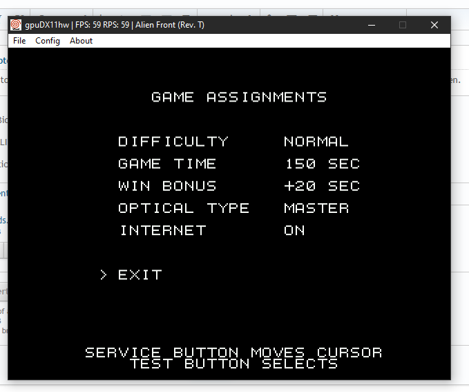

I don't know if the pictures of the system menu dialing it in the telephone simulator you attached are just for reference but they are mine from a video I took and posted on Twitter explaining that I was able to connect a NAOMI 2 via RS232 -> USR v.92 -> DreamPi and Alien Front detected the modem and dialed out connecting online. I used the Dreamcast live Alien Front server for the IP address but the game would always disconnect dropping back into single player after loading a round. This was tested with only 1 other player on the server.
I don't know how the lobby/game matching works for a mix of Naomi & Dreamcast players so I was going to load up various Dreamcast players in the same lobby with and see if the Naomi would connect....maybe a minimum number is required, etc which is why it was dropping back to single player....or maybe cross-play never worked....?

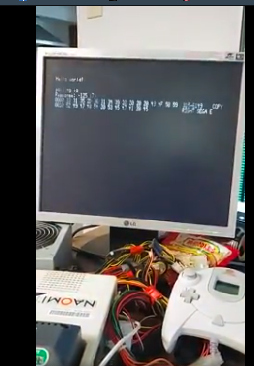

Twitter post of the modem detect and dial out:
https://twitter.com/Gewal/status/1294425683540811779?t=R2iOMumWIC82qG8geViBzQ&s=19
Twitter post of 8 player Dreamcast local Alien Front battle vis Flycast.
https://twitter.com/Gewal/status/1391184157569687560?t=2U3UbNEn0el21N2vkOVwGw&s=19
