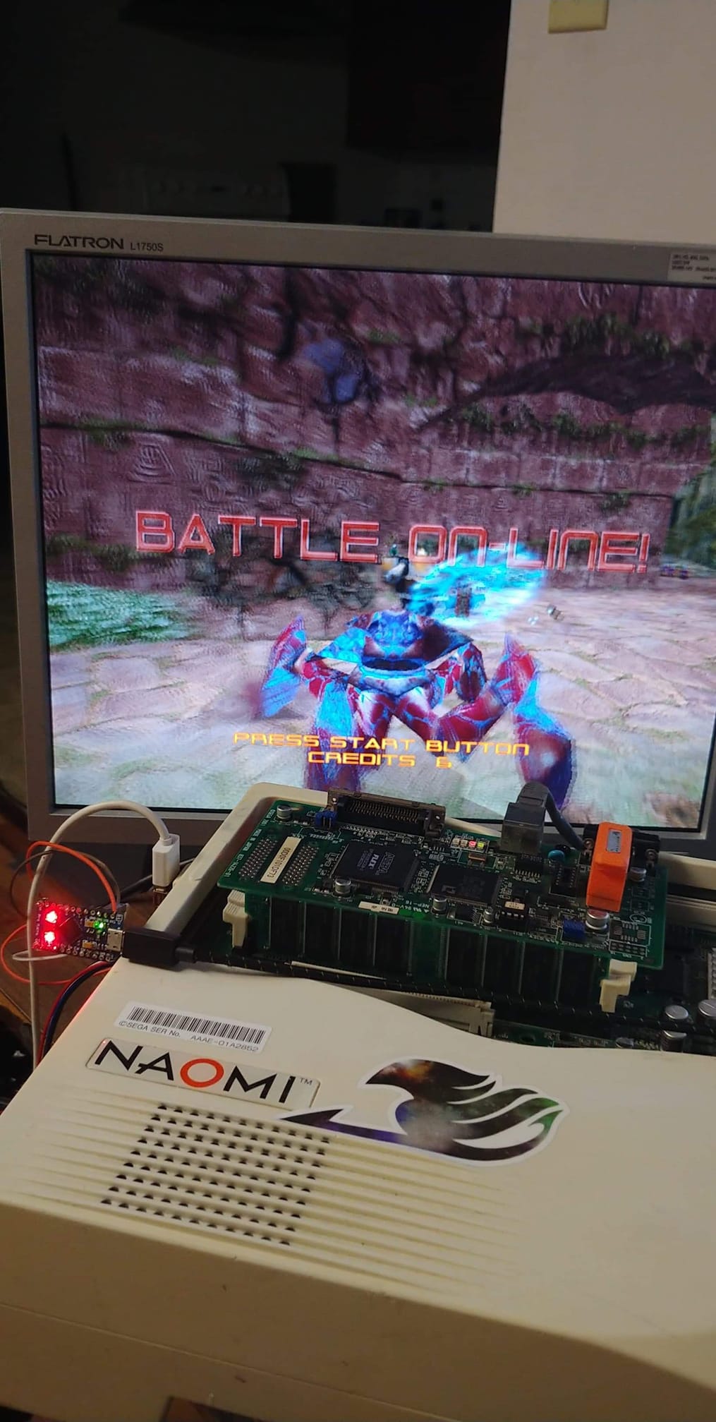

I got modem working because the SH4 IF on the Naomi one is converted to RS422.
https://github.com/anderss90/softwareSerial_RS422
I used this software to try it; a real RS422 dongle would be better.
An rs422 version of the Arduino softwareSerial library. It has two TX pins, TX+ and TX-. It only uses one pin for RX, as the positive pin of rs422 can be read as normal rs232.
If the device only listens to one RX pair it can be read as RS232 @Darksoft @MetalliC
This is how I did it without the mystical and fabled modem; I have the server software and extensive knowledge of the sames and differences between the two software versions on either Naomi or
Dreamcast;
I have a GDI equippped Dreamcast and a Classic Naomi with a Netdimm with a currently broken Pic slot that still boots off Triforcetools.py.
Stay tuned ..

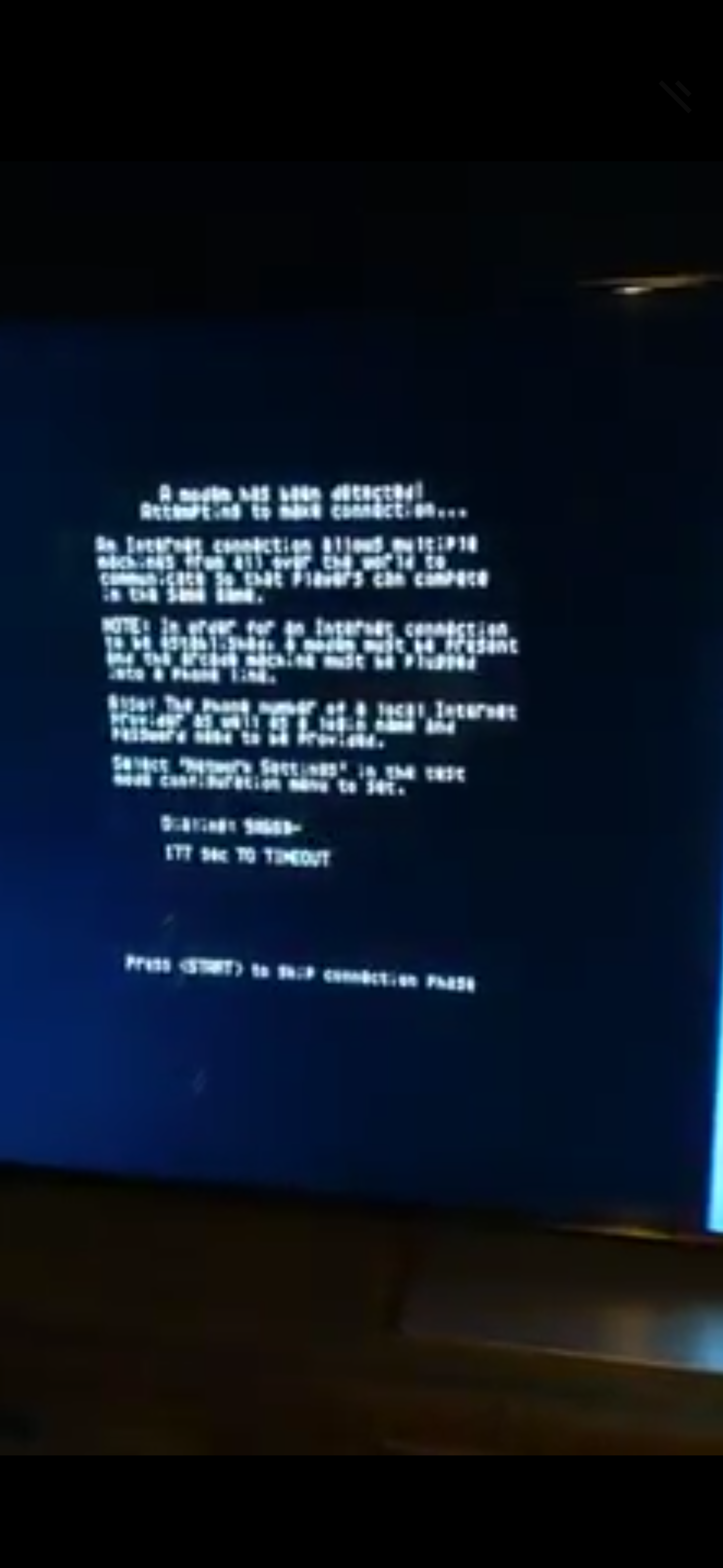

The 'Battle On-Line' text means nothing though. It's part of the attract. However, the second screen (modem being detected) is definitely interesting.

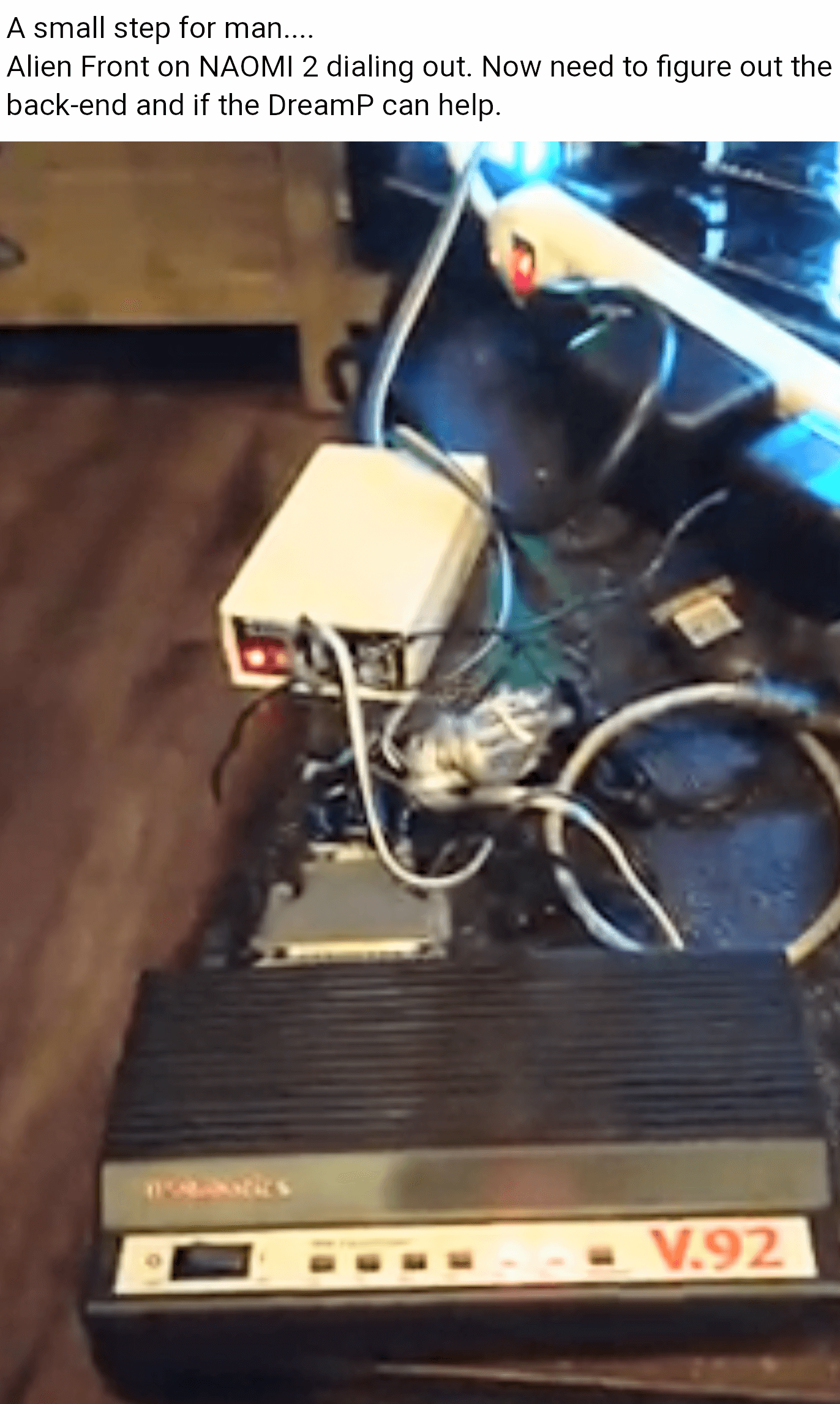

apparently the location test modem was an RS422 modem that plugs into that serial communication connector and Miku figured out how to make a differential reciever out of Softmodem code; it looks like hacked ROM was used to change the server to the dreampi IP...so this wouldn't work with an ordinary aliens front cartridge but works fine with hexedited game like how phantasy star online is modded on le dréamcast
the Naomi 2 guy didn't need the adapter since the second naomi could speak RS232 out of the box; simply a few wires to a US robotics modem with a proper handshake.
Edit:
https://github.com/Kazade/dreampi/blob/master/dreampi.py#L381
Here is the github, looks like it chats to it as a serial device, so possibly a USB to RS422 will suffice and it'll just work without the modem?
I'm a bit young to understand modems lol...
I'll get a confirmed answer soon, but I'm fairly certain all that's required is:
1 - Get an RS422 to RS232 converter
2 - Wire up CN8 to the RS422 side:
CN8 6 pin cable to db9 with the following pin out:
CN8--DB9--Function
1--2--Rx
2--3--Tx
3--5--GND
4--7--RTS
5--8--CTS
6--5--GND
3 - Plug that into a serial modem (they seem to use one by US Robotics or something)
4 - http://blog.kazade.co.uk/p/dreampi.html Setup a dreampi and plug your modem into the USB thing they get you to buy
Then I think dreampi just ignores whatever number it dials, and forwards the info from the dreampi server and so it'll play.
I'll update as I get more information...
As an aside, the whole serial -> modem -> other modem -> computer thing is obviously a bit silly, and I'm sure someone could take the serial data and pass it straight into the dreampi software, and then all you'd require is a USB to RS422 converter.
On the Naomi 2 it can speak RS232 using a jumper, and so you don't need the RS422 to RS232 converter stage (although seeing as those are very cheep + small, you might as well get one).
@bobbydilley cool story, but why I see in debugger NAOMI AlienFront tries to detect modem at G2 bus (i.e. Dreamcast's modem), and see no any access to serial port ?
