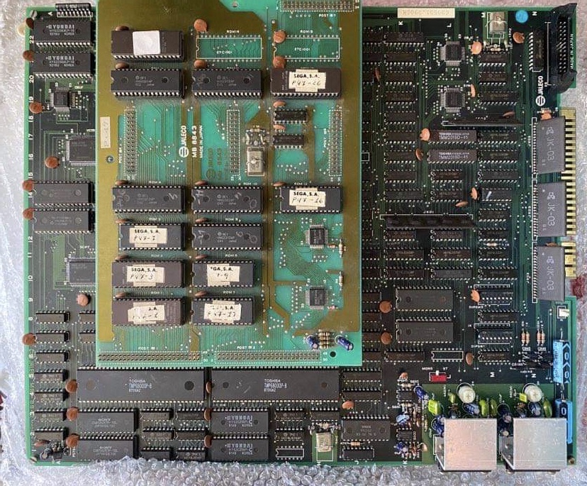

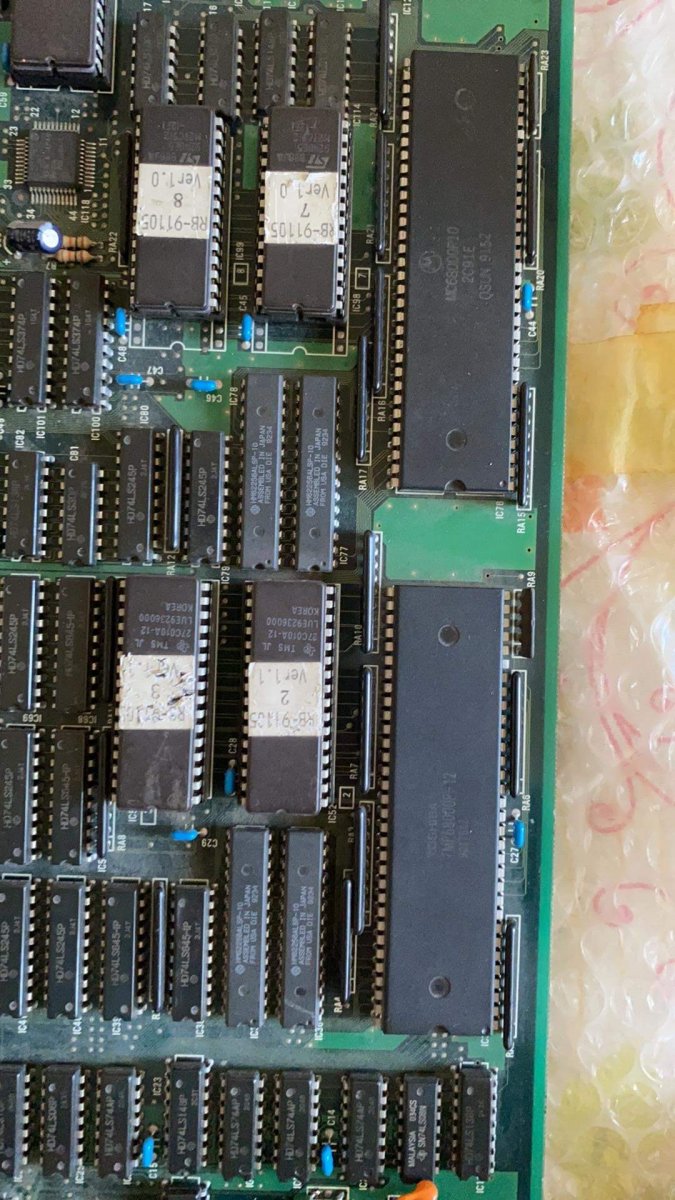

Big striker (12) and p:47 ( 8 )
So the sweet spot is 10mhz, either through overclock circuit or swap cpus.
12mhz is the sweet spot ;)
But i get ya, running at 8 or 10mhz would be a sweet spot for a P8 ;)
