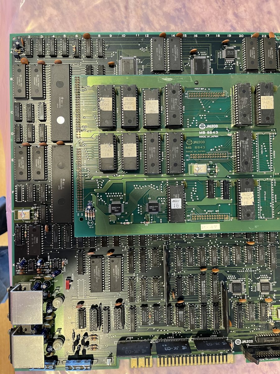

ANNOUNCEMENT - MMS1 - A 16 in 1 MULTI FOR JALECO MEGASYSTEM1(A) FROM CAIUS + HAMMY

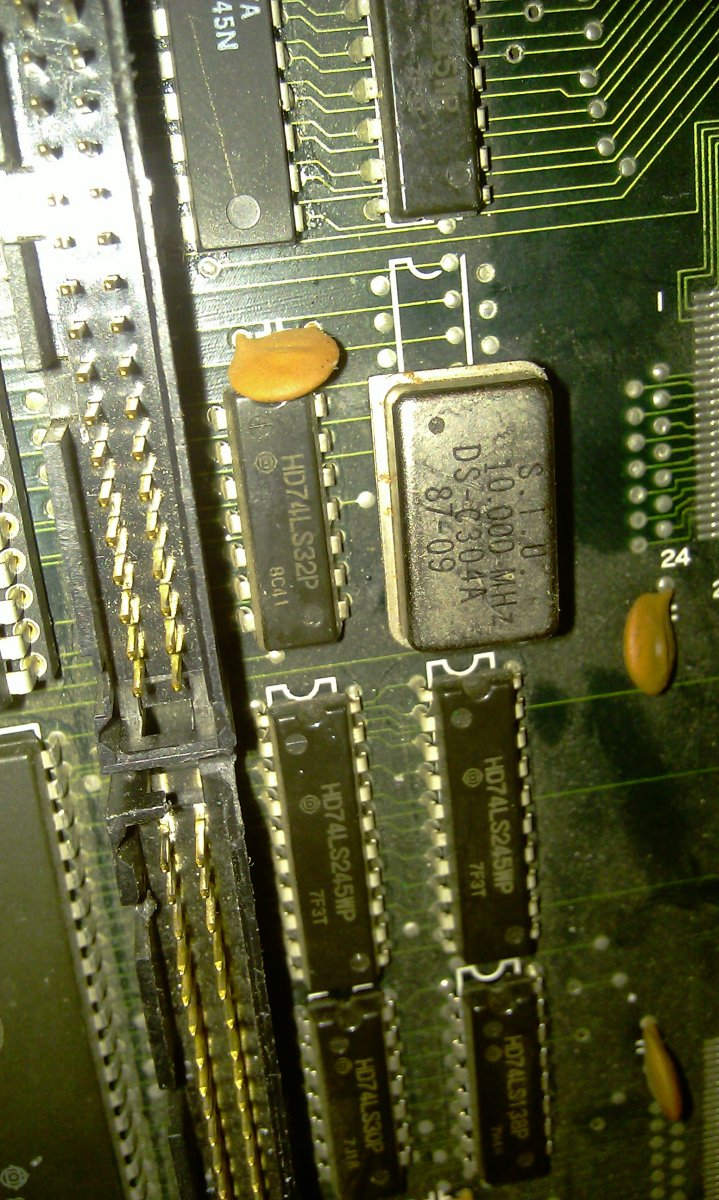

p8 MAY run at 10, it's not that big a jump - i only went greedy going for the full 12mhz first.

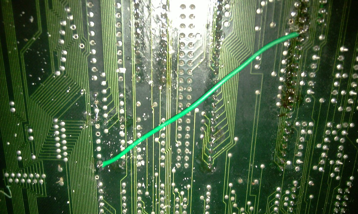

Mod is easy, lift pin 4 on the HC04 same as before, fit 10mhz osc (or better a socket) in empty space + wire power pin.
Run wire to clock pin. Easy

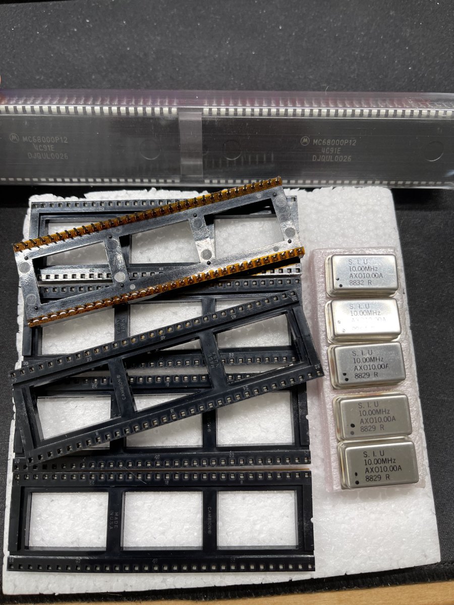

My order of eproms, sockets and crystals etc... arrives tomorrow. Hope to do cpu swap sometime soon.

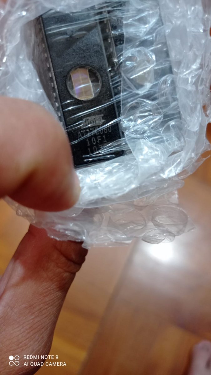

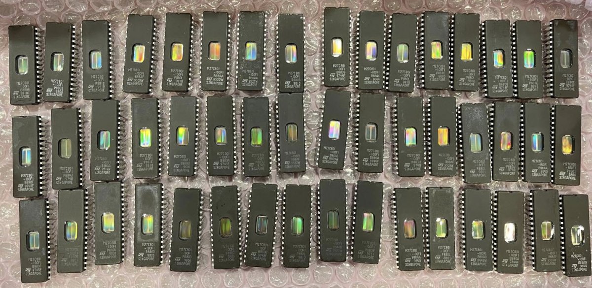

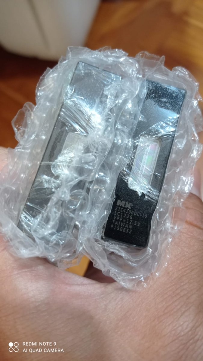

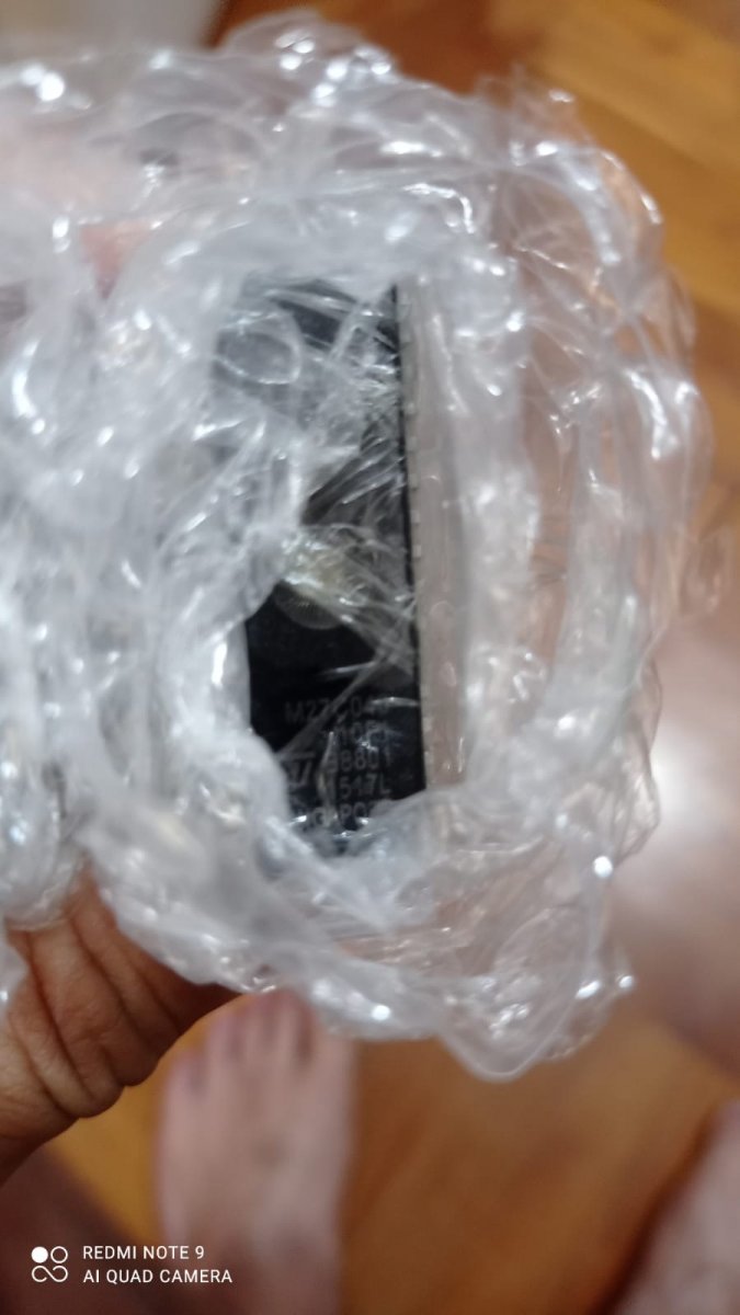

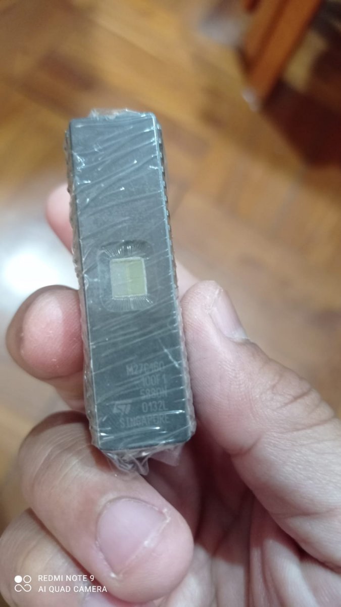

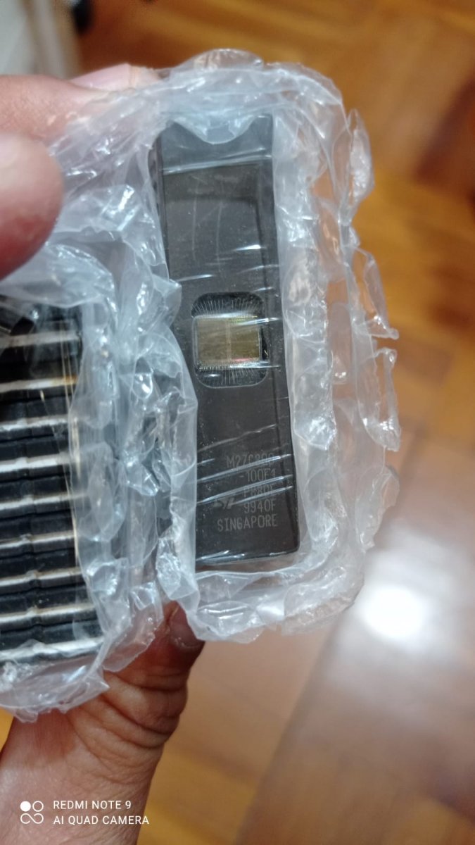

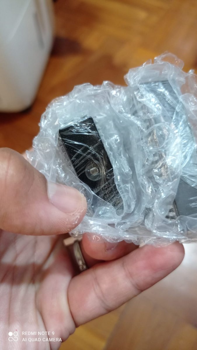

Eproms came in, not as bad as I thought for being used. Recovered from Touchmaster pcbs. besides the glue residue, they are almost like new.
Still need to grab the mcu and socket and 10mhz oscillator . Your eeproms looks great 👏🏻✌🏻
PS: if somebody need a donor for MMS1 multi , don't hesitate to contact me to forward you on the right spot !
Did they get dumped? I guess not. That sucks and i don't encourage buying from people doing that.
So a bunch of undumped versions have probably gone, touchmaster rare to come up and lots of versions.
You probably got them from ebay or similar "ready blank" and had no control.
