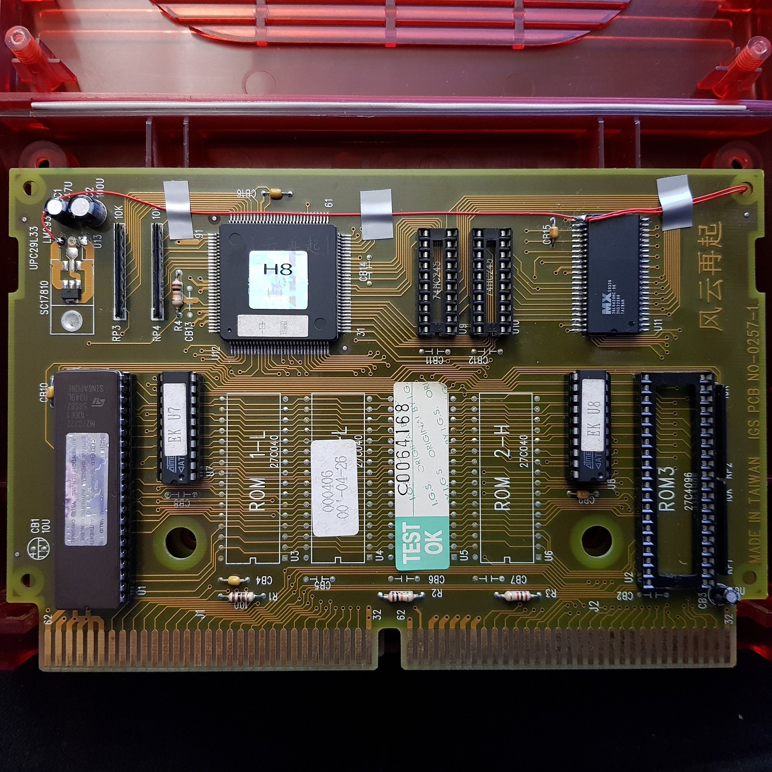

If anyone has successfully performed a Ketsui or Espgaluda conversion using a Killing Blade cart, I would be very grateful if you could please post some pictures of the completed boards.
Can someone who has one of these or has done it let me know which ICs other than the 27C322 I'll need to order for Ketsui?
@Apocalypse which voltage regulators would you suggest
Edit: should've looked back through the thread for the ROM ICs, already been noted. Good I'll order those.

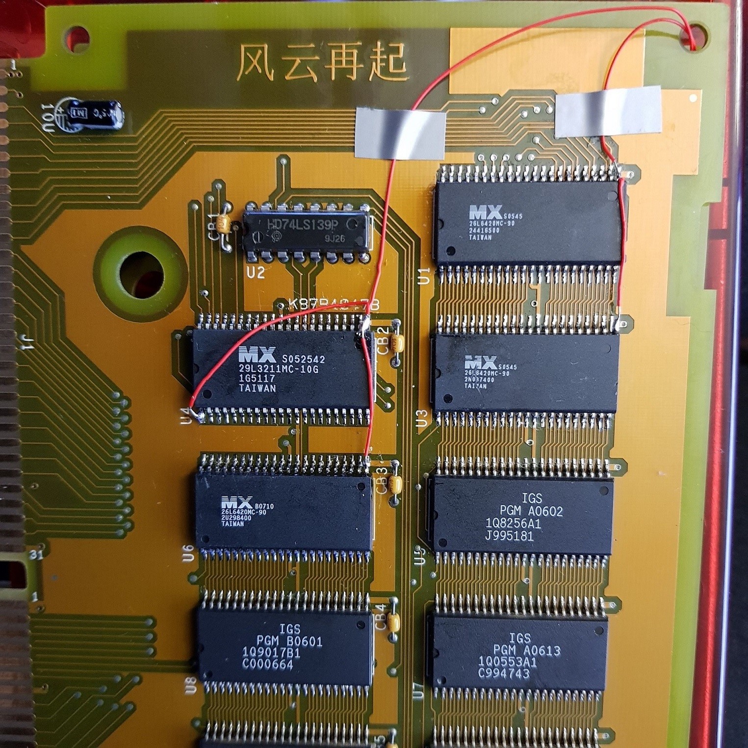

I ordered a killing blade before I did any conversions and the PCB is totally different to knights of valor 2. I haven't seen any pictures of a conversion that uses KB as a donor.
I assume there's different PCB revisions like there is for other games, hopefully the one I've got coming is the right one, otherwise I guess I have KB in my collection now :P
Edit: just bought some voltage regulators, 3. 3v/1A max so they should be good.
Yep earlier in the topic I suggested 500mA should be enough.
Saw that when I went back and read the full thread looking for the instructions for Ketsui - thank you very much, I'll get the correct EEPROMs on order this week too. Will take a photo of my cart when I get it to make sure it's possible before I go any further.
