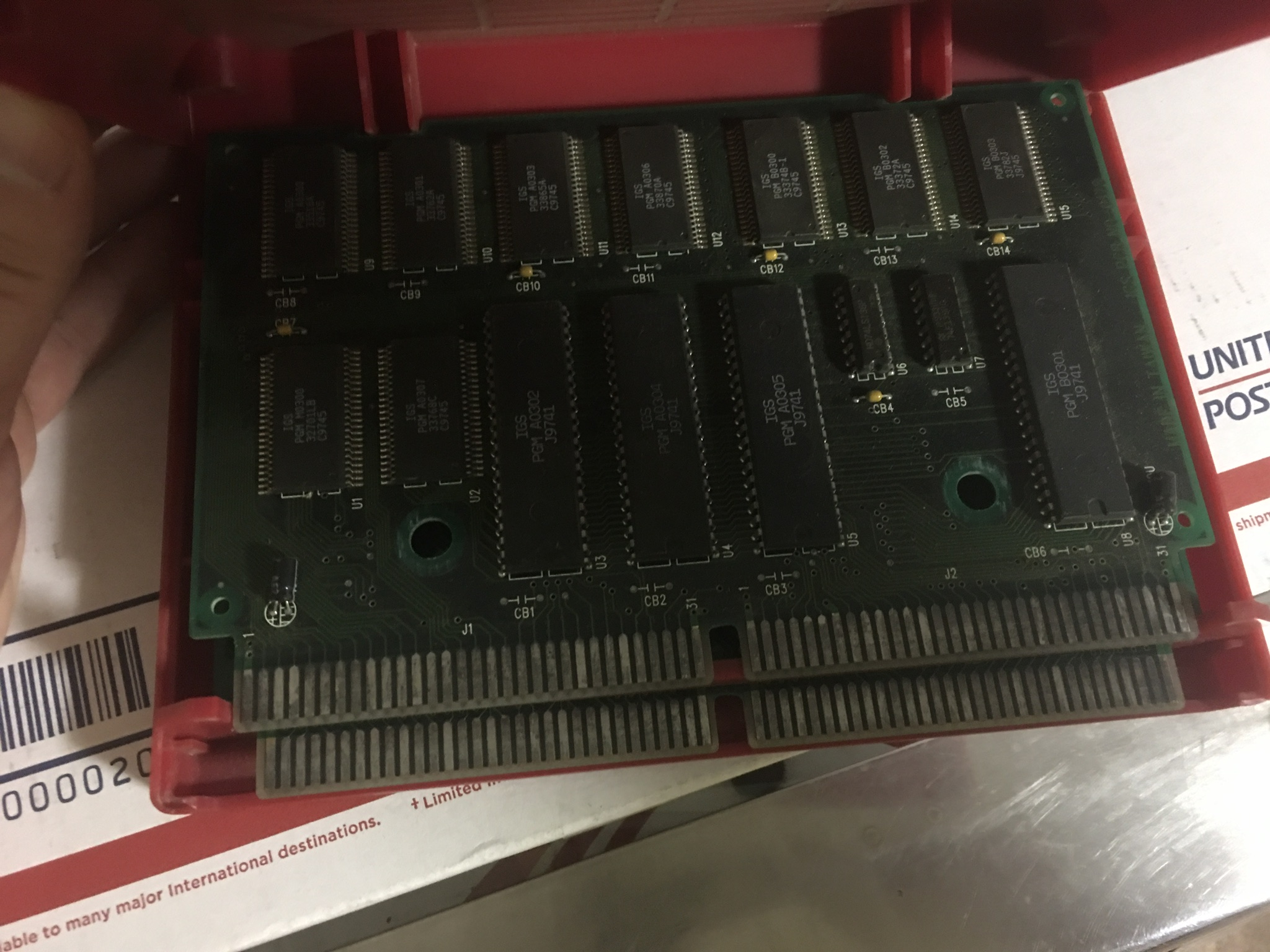

So for those who haven't seen them already - these are the boards from a Killing Blade cart, or at least the one that I got today. The boards are indeed very different from the KoV2 boardsets above, but since it's a totally different game I guess you'd expect that
It does have the same locations as specified for the KoV2 -> Ketsui conversion, but has through hole spaces rather than SMD, so if it's possible to do the conversion on a Killing Blade, it's not the same way as KoV2 which I guess is to be expected, but I do need to figure out what needs to go where and whether the same devices are used.
U8 is the same (I assume U8 is the program cart on all PGM boards)
U14 appears to be the same as U21 on the KoV2 prog board?
None of the GFX/SAMPLES board seems to match up. I assume this means the PAL will need modification in a completely different way as well.
I think without finding someone who has a Killing Blade converted to Espgaluda or Ketsui this conversion is a no go for now.
I assume by checking the MAME driver I can find which run ROMs on Killing Blade match the ROMs to replace, then it's just a matter of working out how to rewire the PAL

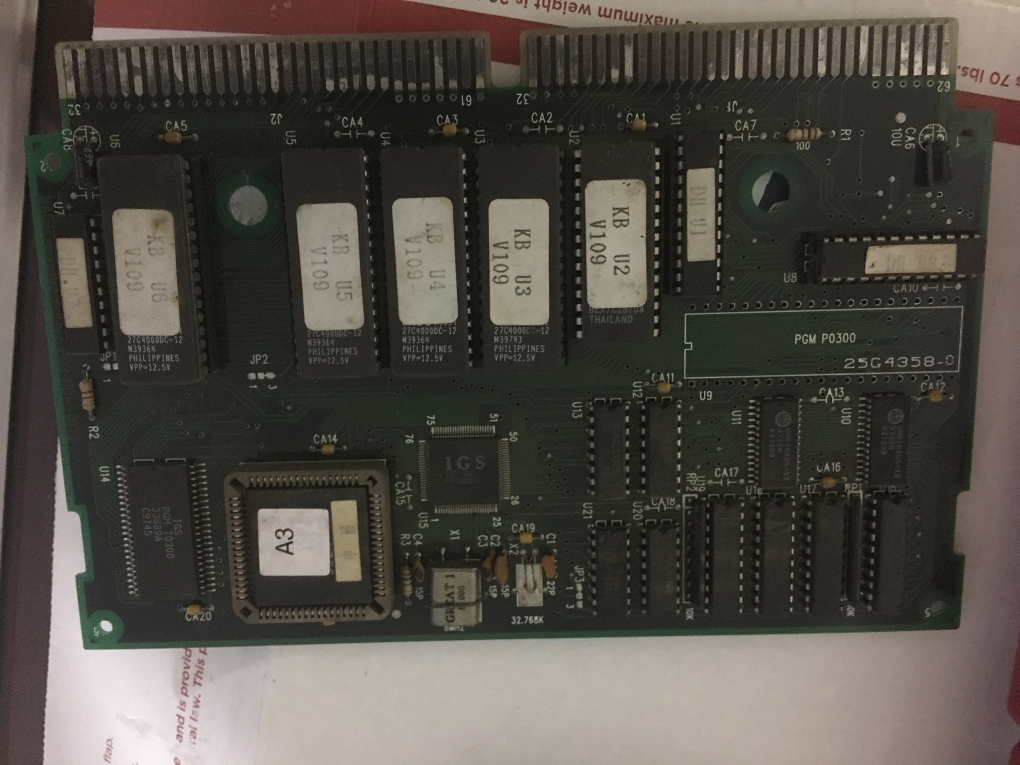

My killing blade cart looks a little different that yours. My cart has some extra chips when compared to yours @xodoraP.
Indeed. Interesting. I'm not sure what to make of it. The boards seem to be the same on both though, just the arrangement of EPROMs is different.
