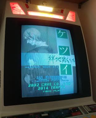

Also, is your monitor missing red or is that just the arrange mode title screen?
Oh ok, I see.

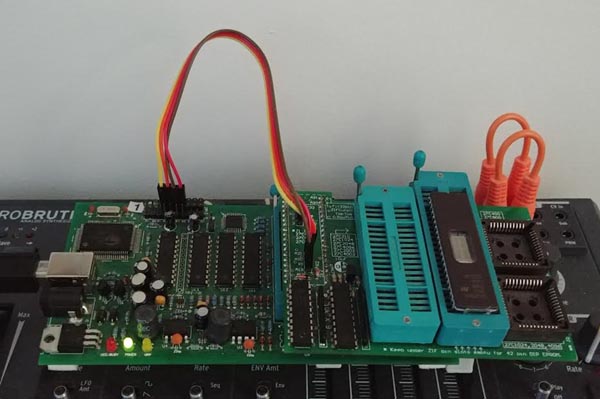

What programmer do you recommend to write the eproms required for the conversion?
I have a willem GQ-3X but I wouldn't recommend getting one.

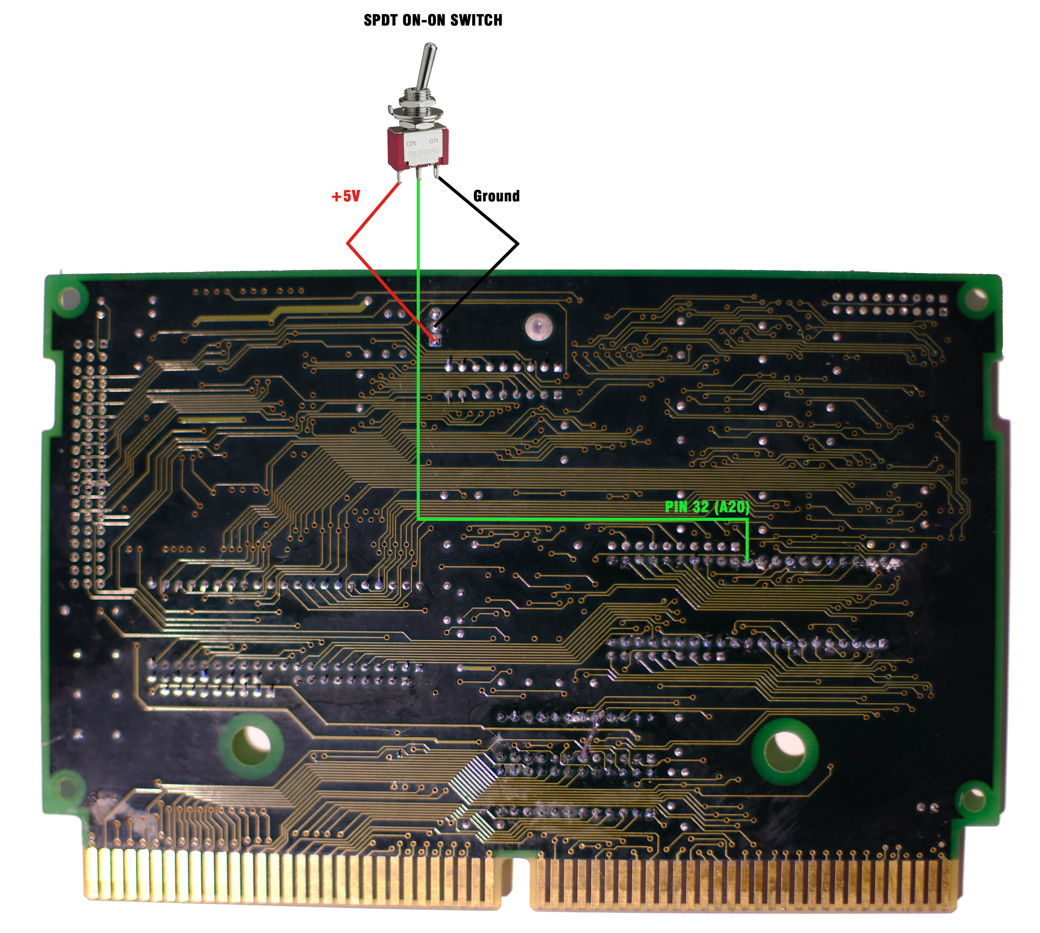

I've made a small diagram which should aid in installing a switch.

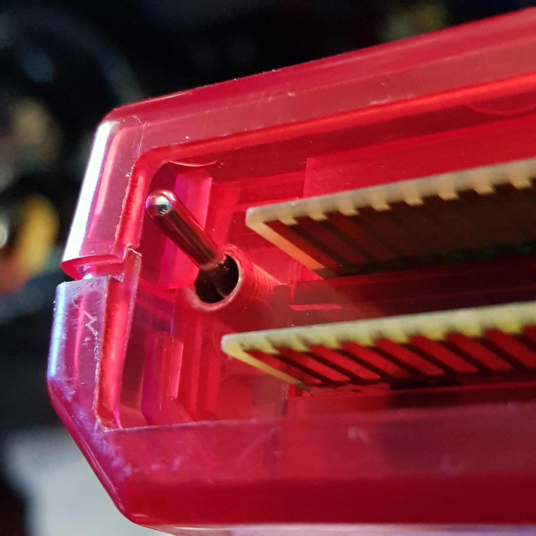

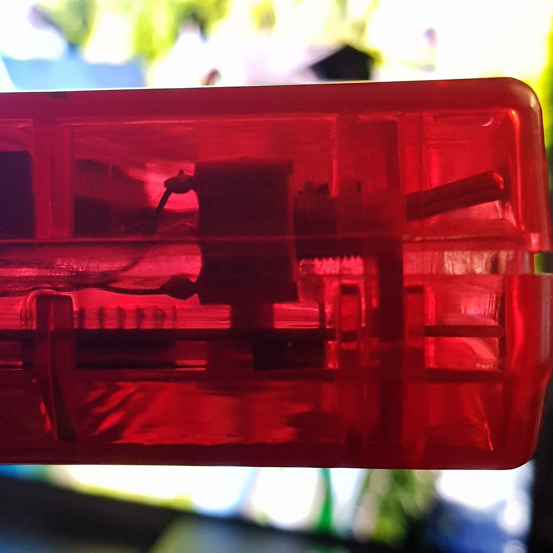

Nice, any pics of your install so we can see where you mounted the switch? Got a link to the switch you used?
Sure,
I'd grab these switches, pretty much the same as what I used and they're dirt cheap. I think the ideal location for the switch is on the top front middle of the shell, simply for ease of access.
I store my conversions in shock boxes so if I'd installed the switch on top it wouldn't have closed.
Nice, I'm a bit surprised it fit like that on the underside.
