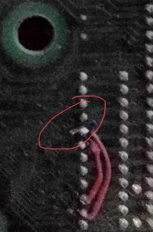

@twistedsymphony
On the PAL socket where the jumper wires are, near pin 20 in both photos is a via that looks like it might have had the trace cut
The photos are not detailed enough to say for sure but it does seem coincidental that it looks the same in both photos
What do you think?
What do you think?
GOOD EYE!
@EVAWINGZERO or @neofrank if you can get a clear close up shot of the PCB area with the 2 jumper wires, that would help confirm!
