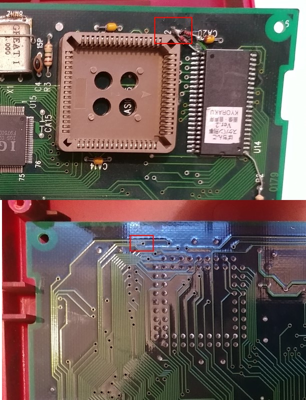

@EVAWINGZERO and @neofrank if you could confirm for me:
1. are any of the PINS on either of the PAL chips are cut off, or folded under the chip? neofrank you pulled the chips when you did your scan so I would think you should already know this off the top of your head.
2. The two diodes that were added on the top right. the joint in the middle of them... is that also soldered to a VIA? Could either of you check with a multi meter to confirm continuity or no continuity from this joint to this this via (in the pic below)
Like I said this is a total shot in the dark, but maybe they're pulling a sneeky one by using the voltage divider as a way to tie a line high that also disables the ASIC circuit or something...
I can't for the life of me see any other PCB modifications in these pics and the PALs DO look original, even if the labels don't make sense.
Both PALS were complete and no bent pins, I looked over the sockets and didn't see any additional bodge wires / cut traces under the chips either.
I don't have the cart with me now, but tonight I can check continuity with that via.
that's what I suspected, but thank you for the confirmation.
