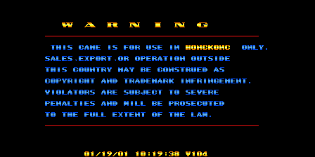

OK, I got it working under MAME.The good dump is the one done with socket but you have to split file in two and use the 2nd half.I'll forward this to MAME, thanks again.

If using @twistedsymphony's external ARM dump results in the region screen in MAME changing from China -> HK (does it?) then this would indicate the external ARM code could be changed to switch regions, as opposed to the internal ROM code controlling it for this particular game.
