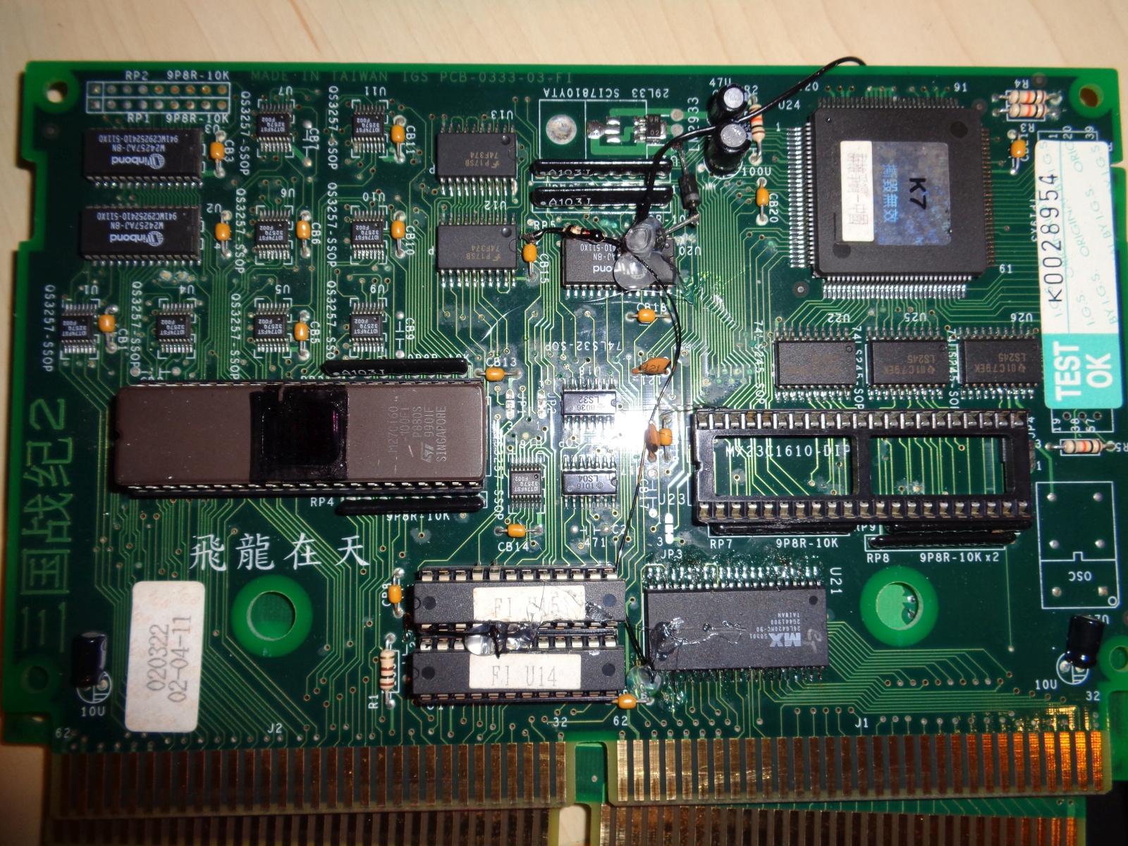

I'm curious what's going on with those green wires though. Is he changing the pin mapping? would that be something that could be done with a custom GAL?
That seems most likely to me.
If anyone could probe the PAL, there should be address lines on one side (inputs) and /CE lines on the other side (outputs).
Then with the information in MAME it should be possible to handcraft a new PAL with the correct memory mapping.

Who prepared this bootleg carts simply used two diodes and a resistor as voltage divider to produce the 3V needed to power the flash ROMs, this is not a stable solution.You should use a simple +5V-->+3V voltage regulator, you can find on Ebay preassembled boards like these ones:

The PAL chip is the original one but you need to do some rewiring on it.

The KoV SH I received today looks odd:
Anybody knows if this one can be converted to DDP DOJ BL?
