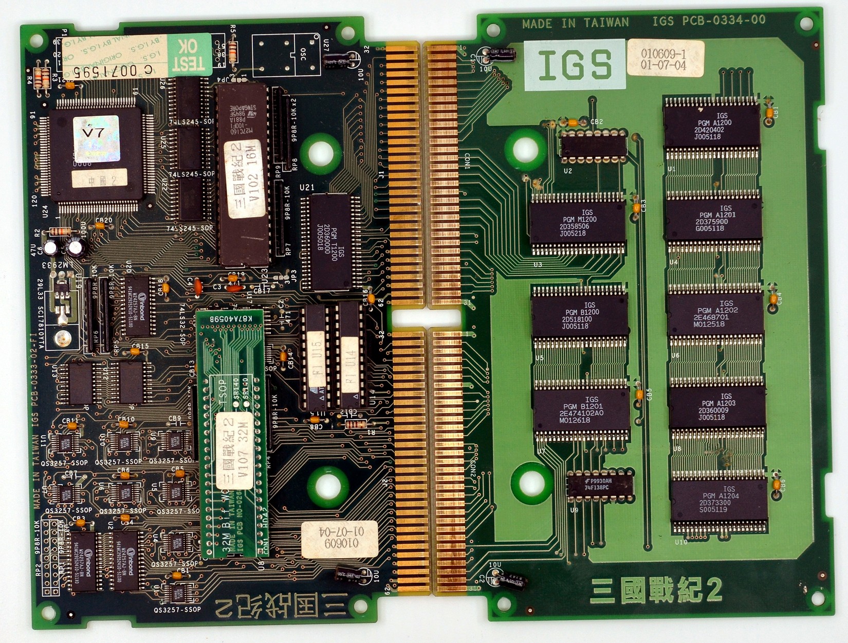

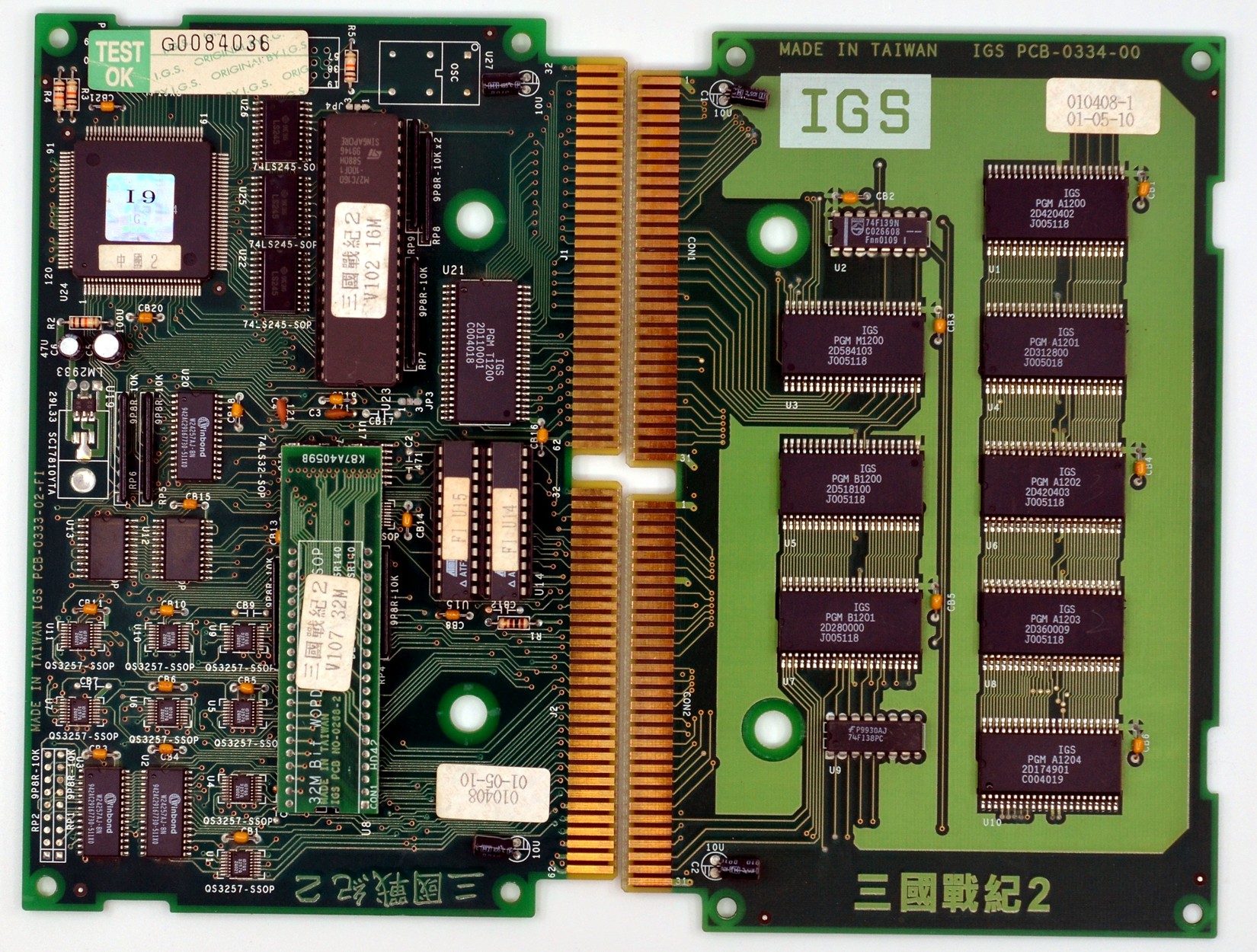

So are these boards good for conversion?
I found 2 of these, need to dig up the rest from storage, I bought quite a few PGM carts from a couple peeps, so I have some duplicates like these
KOV2
From the blog that was linked to earlier newastrocity.wordpress.com/2013/07/21/cave-conversions/
For Ketsui and Espgaluda, you want boards that look like this:
well, that doesn't bode well for @Derick2k or I since it looks completely different than either of our KOV2 carts (and both our carts look different too), that's at least 3 PCB designs for that game.
Here's hoping that my KOV SH is at least a match for DDP DOJ

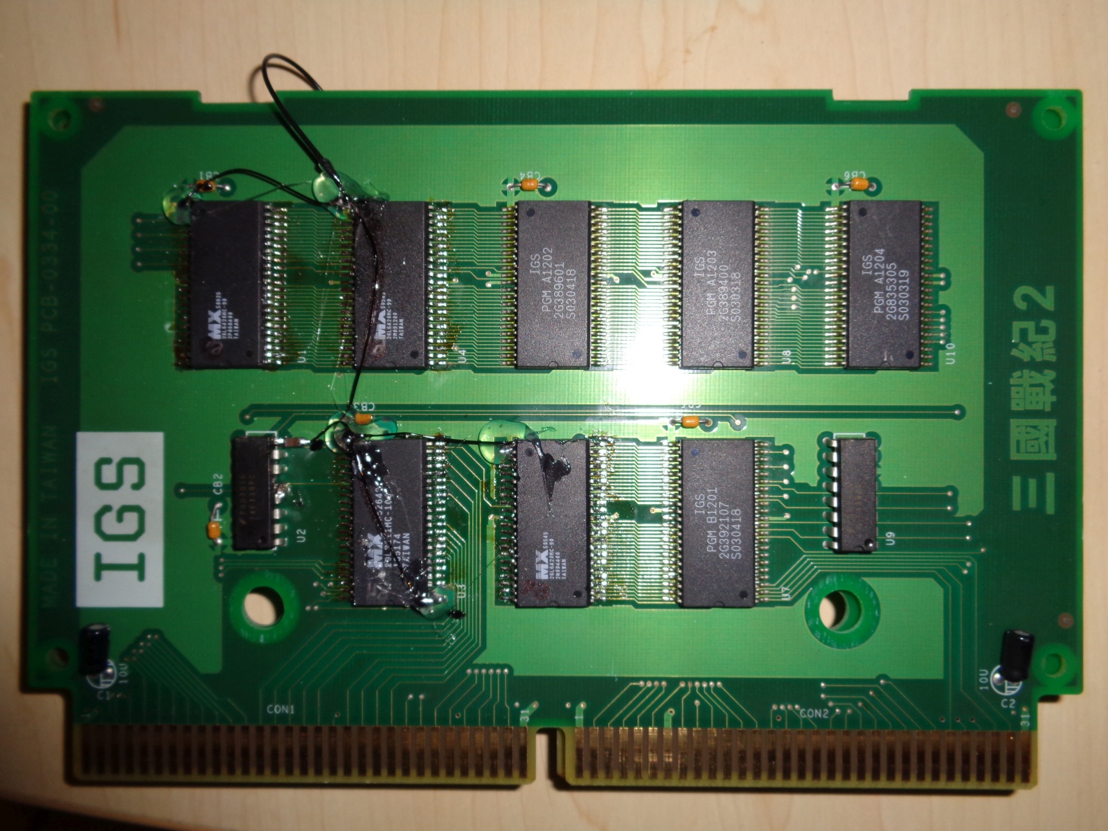

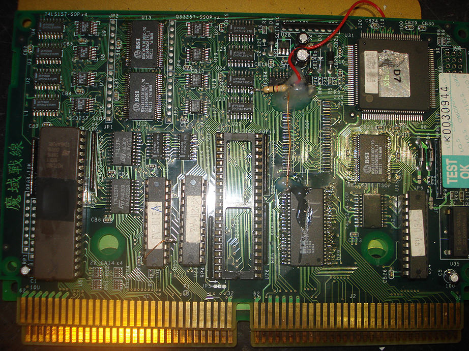

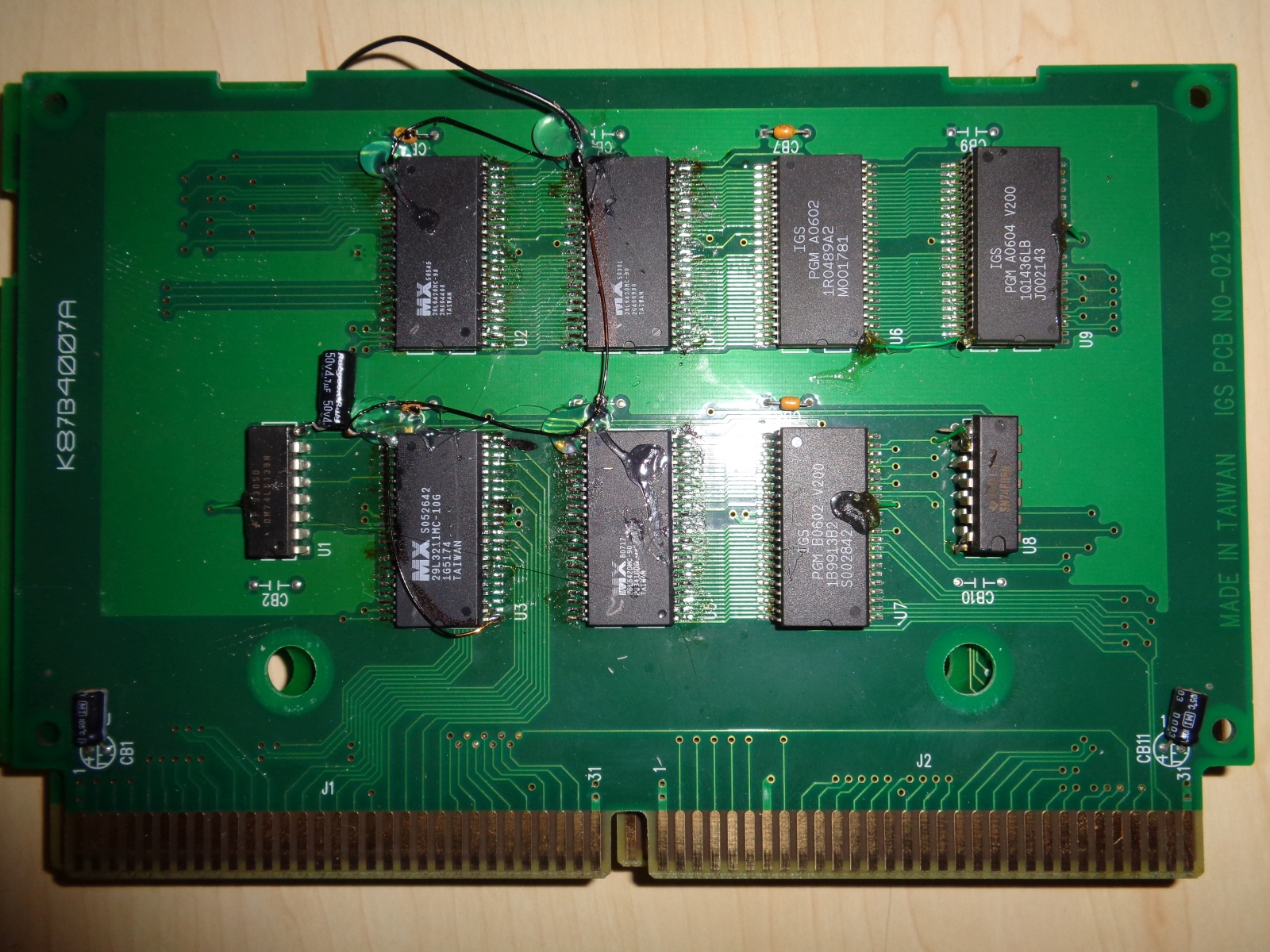

Hello. I bought DDP and Espgaluda bootlegs from a guy in france over a year ago. I had taken high-res from the pcbs.
Hope the pics are useful to find suitable donors.
https://mega.nz/#!lP4hmC5Z!-8-cTZ3TWnJsuHmNLy5zNt-P_KdCtYNuHPqh32HSVOQ
Cheers.
Who prepared this bootleg carts simply used two diodes and a resistor as voltage divider to produce the 3V needed to power the flash ROMs, this is not a stable solution.You should use a simple +5V-->+3V voltage regulator, you can find on Ebay preassembled boards like these ones:
https://www.ebay.it/itm/2x-3-7V-5V-...856859?hash=item3f7c360d9b:g:tB8AAOSwONBZFBRw
Thank you for that, it looks like these were the PCB numbers
KOV2 (ESPG/Ketsui)
prog board: PCB-0333-09-FI
asset board: PCB-0334-00
KOV-SH (DDP DOJ)
prog board: PCB NO-0222-1
asset board: PCB NO-0213
I'm curious what's going on with those green wires though. Is he changing the pin mapping? would that be something that could be done with a custom GAL?

Can you tell us which game is which?
the top pics are KOV2 ... I can tell because they have the game name skilscreend right on the side of the PCBs.
these also match my own KOV2 PCBs.
