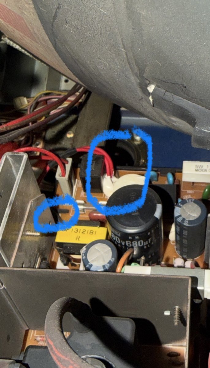

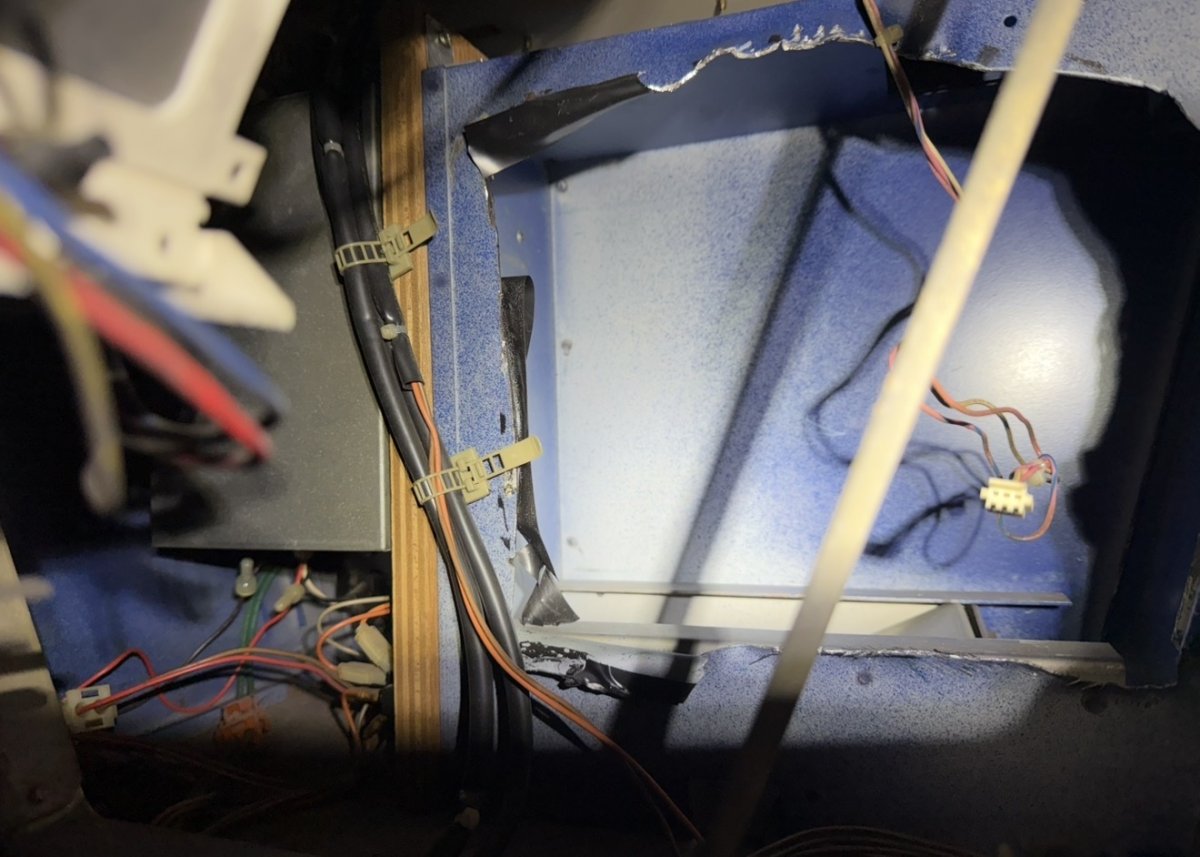

Oof what in the hell. Nearly all the other locks were drilled out but am I seeing things or did someone cut out the side of the coin box with a saw? Good lord why?
That’s what it looks like to me with that big curled piece of sharp metal. I knew I was rolling the dice but didn’t even notice that being distracted by all the other oddities / things I might not understand.

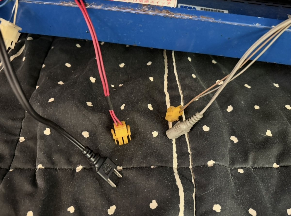

The 2 cables on the left power and the yellow one are directly soldered to the chassis.
Assuming this is another mod as I’ve never seen a 2 prong power cable coming off a chassis. (I hope I am wrong)
Tempted to buy another chassis and tube that doesn’t have these modifications cuz I have no clue how to undo them and replace them with the proper connectors.

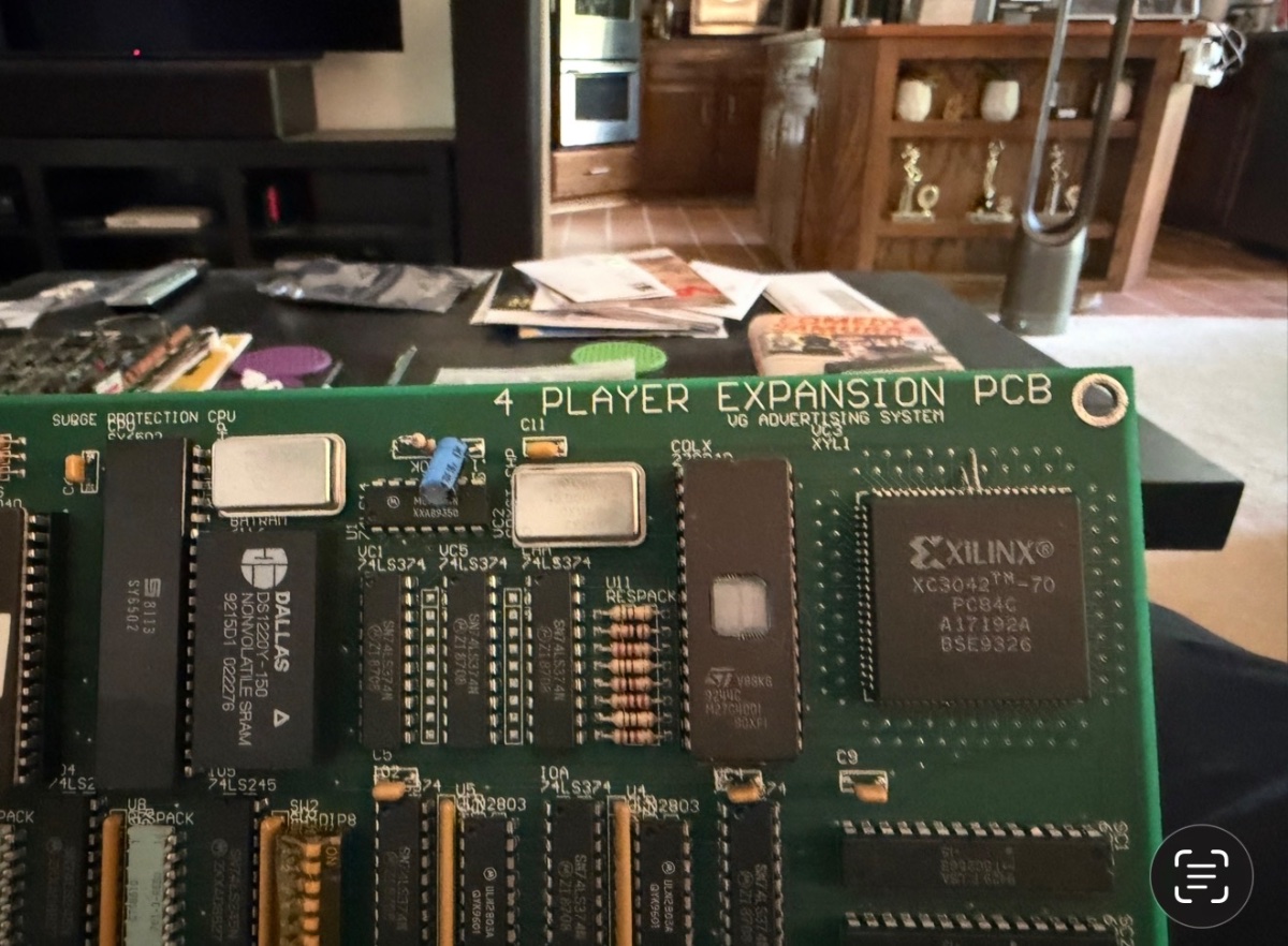

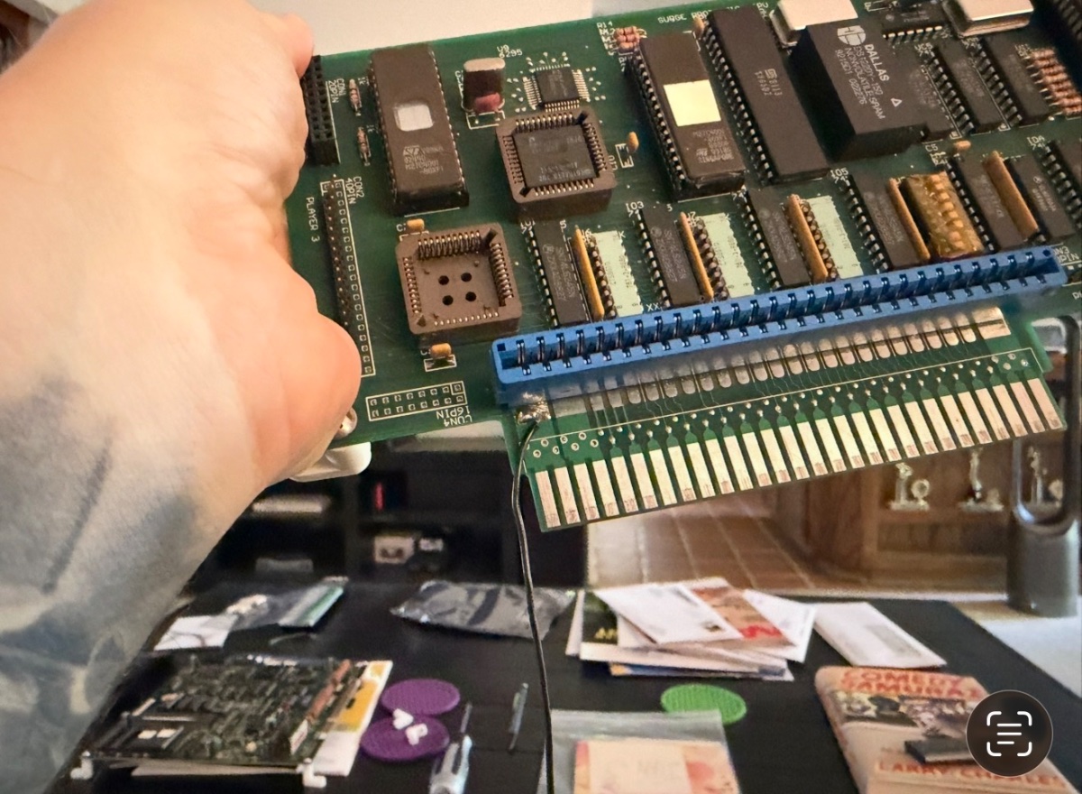

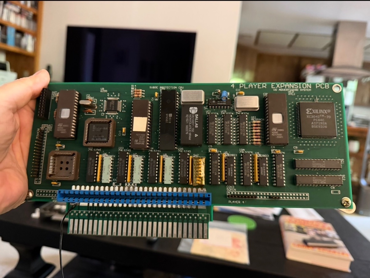

Gross. Not understanding the point of 4 player pcb on a 1-2 player cab. My disdain grows lol.

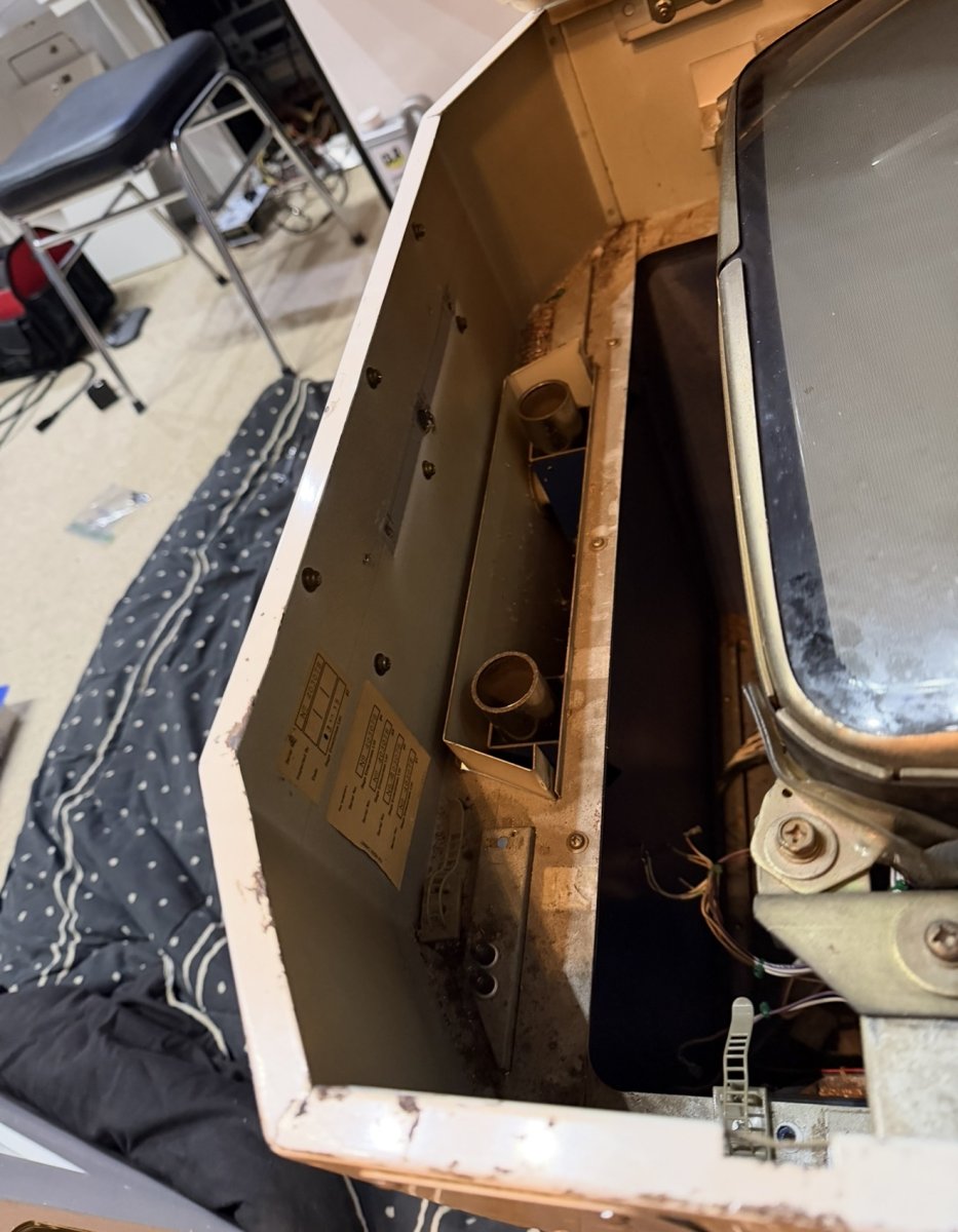

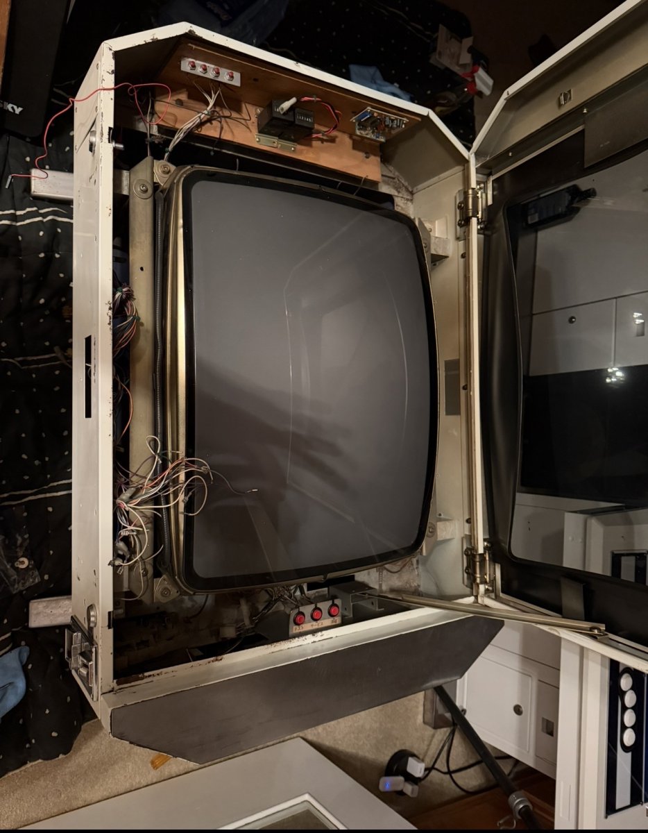

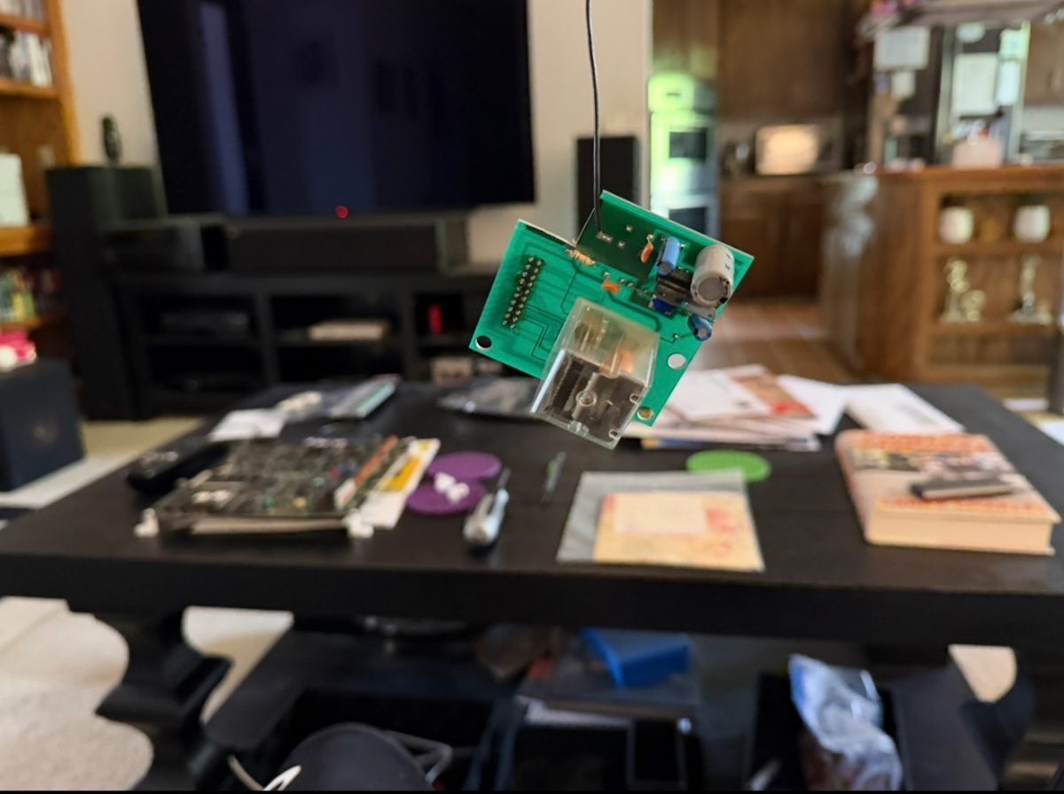

More stuff that doesn’t look standard. Not sure what these red buttons the left of the cab are for. Assuming these are coin counters in the middle. The board on the end looks like it has Japanese writing on it not sure if this is part of the original cab or not, my guess is headphone\speaker amplifier?

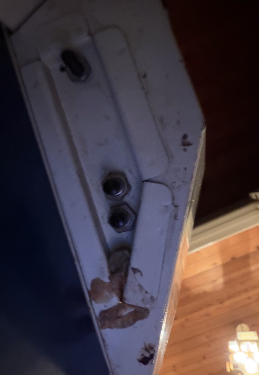

Fucking guy screwed this additional wooden tray through the cab and the sharp parts of the screws are protruding out of the side sign of the cab. Totally unbelievable.
Just wanna pull all this bullshit out lol. I could
be wrong about some of this but I’m basing this on pics of other cabs.
Maybe the metal thing on the top was standard but I’m still super confused. If that was the case where could you put speakers.
@SailorLodestar is any of this standard?
I'm pretty sure those red buttons are your test, degause, etcetera.

I wonder why they would install additional red service type buttons when the stock ones are still there on the right?
I also have these button on the left front underside of the cabinet. The knob doesn’t appear to turn seems stuck.

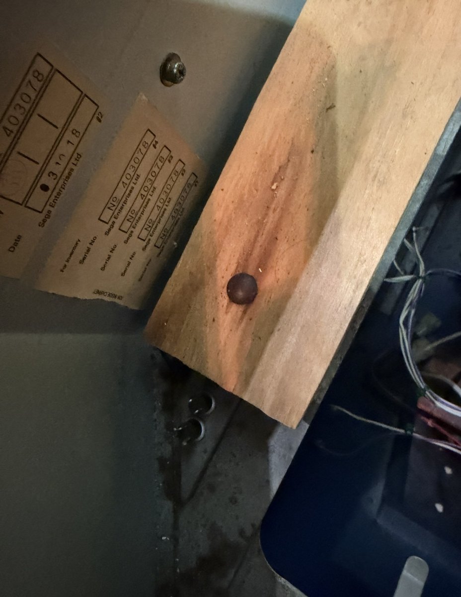

Man this is all madden difficulty. This wood board was held down by 2 nail screws with no heads to turn. Got one out with pliars rotating it from underneath. Time to work on this second one. Sob lol.

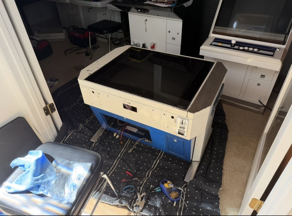

Anyone know what model power supply should be used in a an Aero Table? I see some Aero City PSUs available but not sure which one I need. Still need to get monitor out to try to get a better view of the PSU.
Edit: Finally got rear door off had one stubborn screw but used screw plyers and was able to get it off. Def looks like the silver Aero City style PSUs but haven't taken a very close look yet.
That is stock on that chassis (MS8-26SG).
Oh awesome. Yeah I figured some of my assumptions would be wrong. I see a MS8 on FB marketplace but it would be quite a drive.
I think the wiring will be the most challenging for me because it seems all hacked up and modded for the extras this person put in the cab. But then again maybe some of it can be salvaged. Getting the monitor out will make it easier to figure out what is going on.

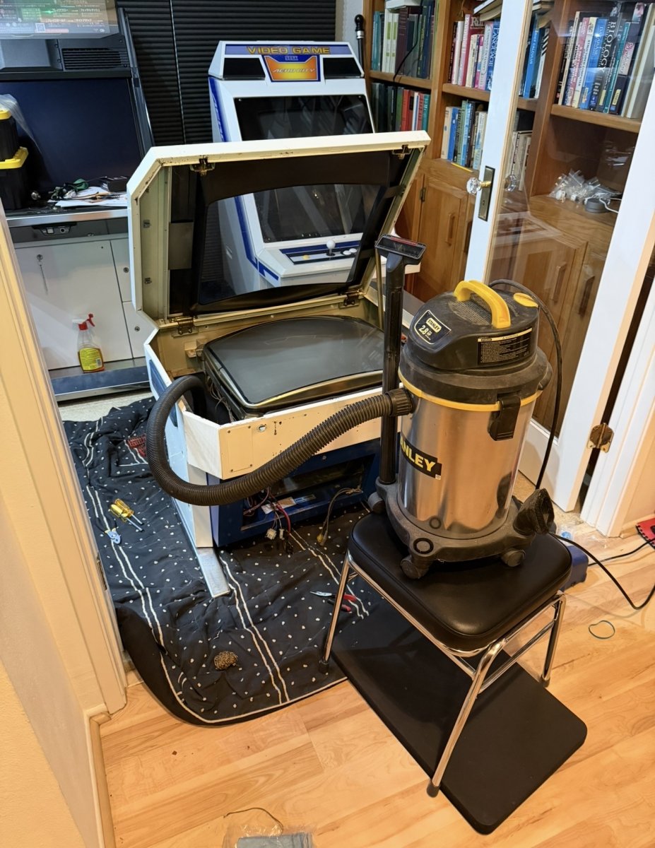

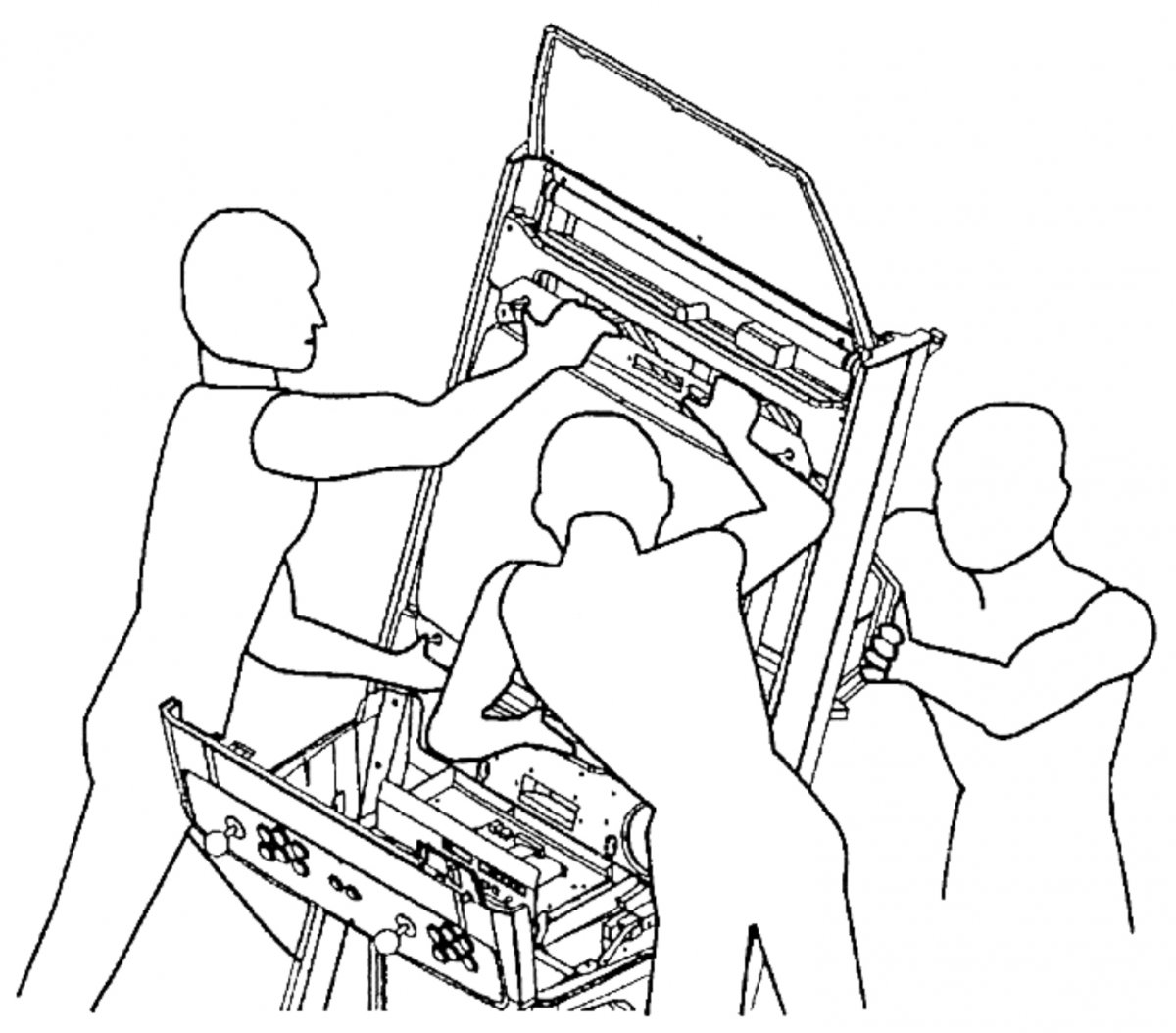

I want to rotate my Aero back to horizontal and my blast city to vertical. I definitely will do it with a helper, but I was curious about the stories of ppl breaking the neck of the monitor. Would this danger be alleviated a little if you took the monitor out. Set it on the floor, rotate on the floor, rest, then put it back in with the new orientation? Is the danger mostly from rotating it in the air in one movement?
Is the person in back more for guiding the monitor or more for extra lifting support?
Unless you are a beast I’d definitely set it down - reposition your grip - replace in your preferred orientation. I think necking tubes only occurs when people don’t clear/remove wiring in the neck area and/or when the monitor doesn’t have a frame/cage protecting the tube area.

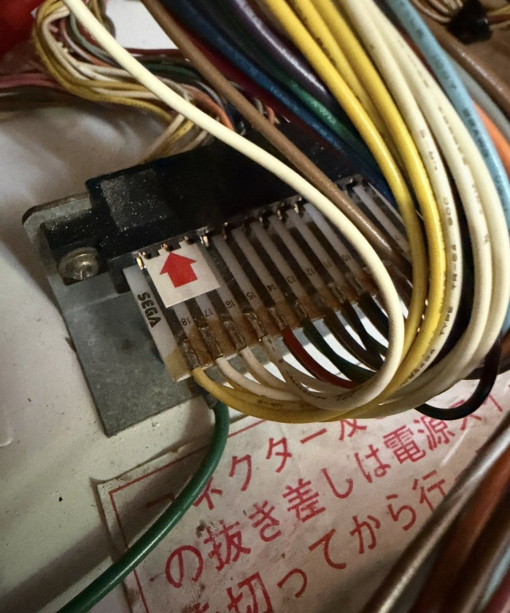

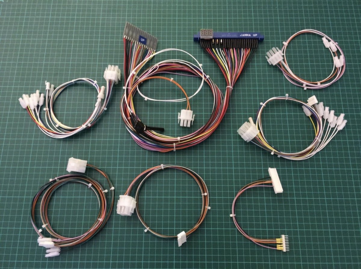

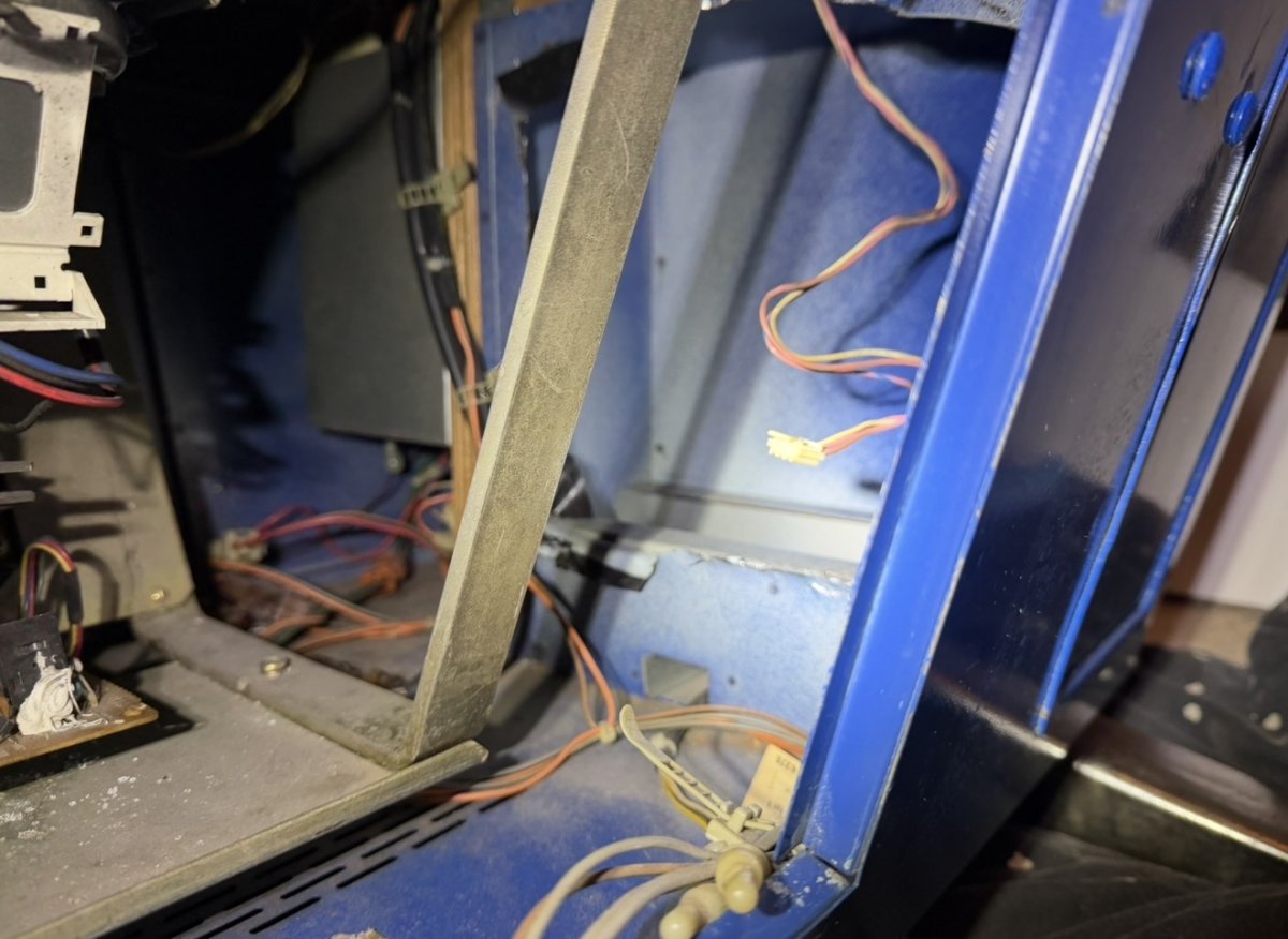

Is there an equivalent to this thing in an Aero Table?
Looking at this “full” harness and can’t figure out where it would plug in inside an Aero Table. (Pic taken from my Aero City)
Wish I wasn't such a wiring novice. I feel like I gotta map everything out one by one, ask what kind of connector is this, where does this go? Etc.
It appears the wiring is very similar to an Aero City but not exact from what I can tell.
Edit : Perhaps it is pretty much exact. Still not sure.
