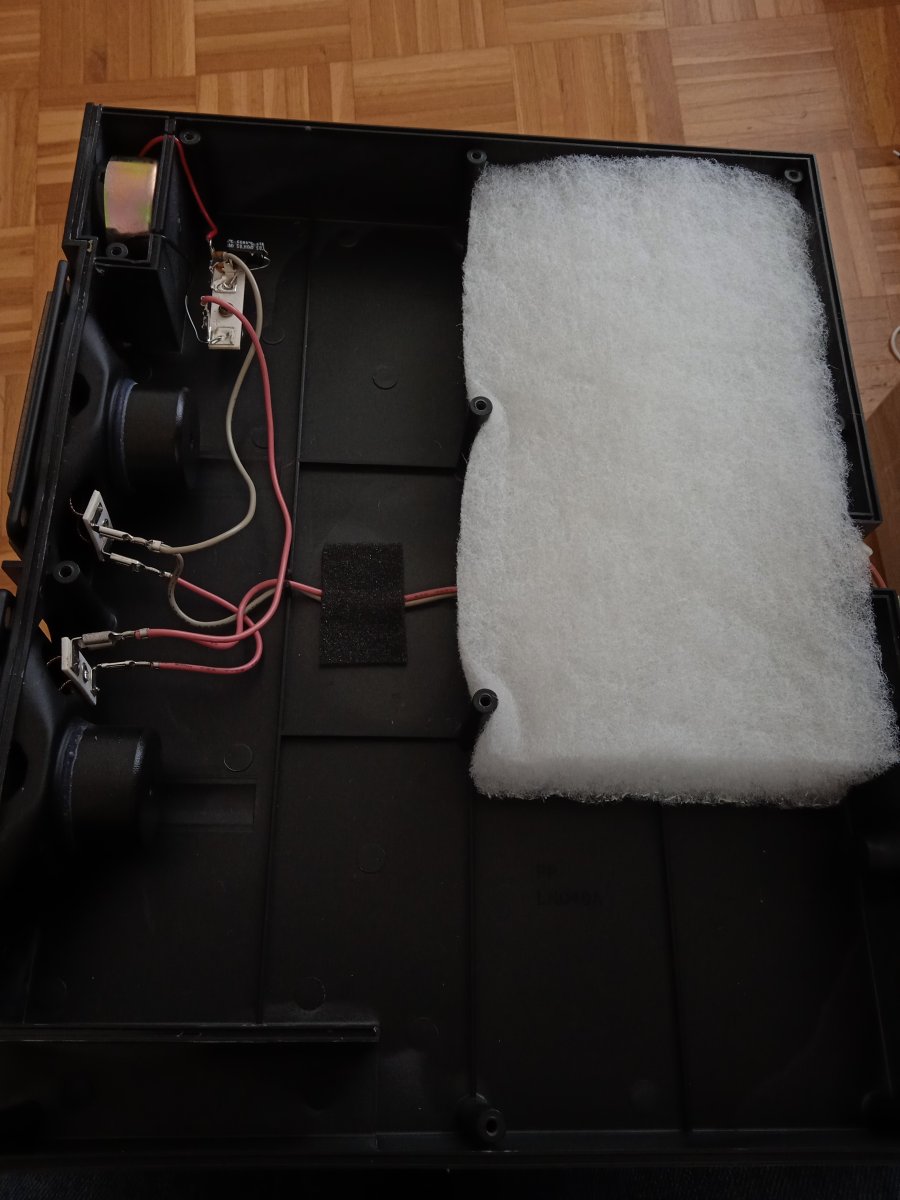

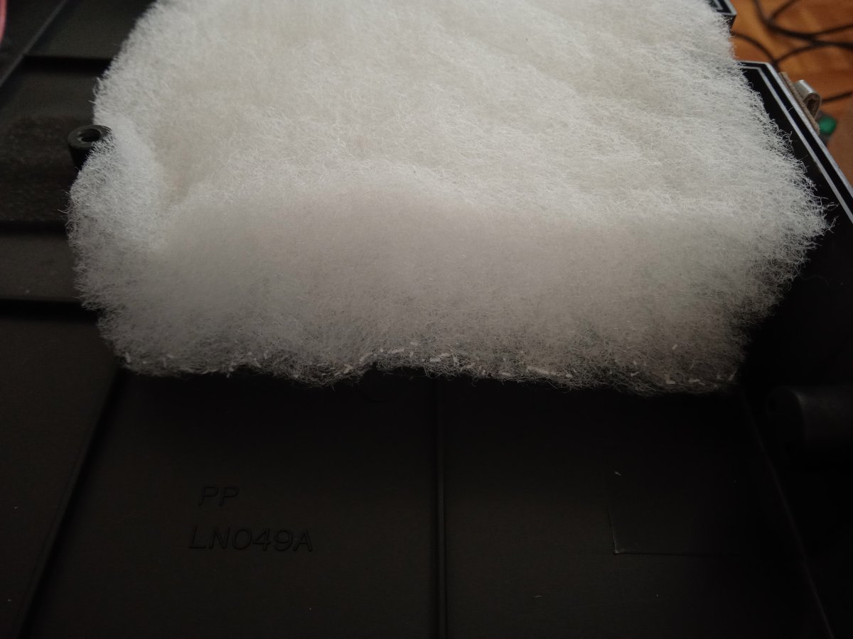

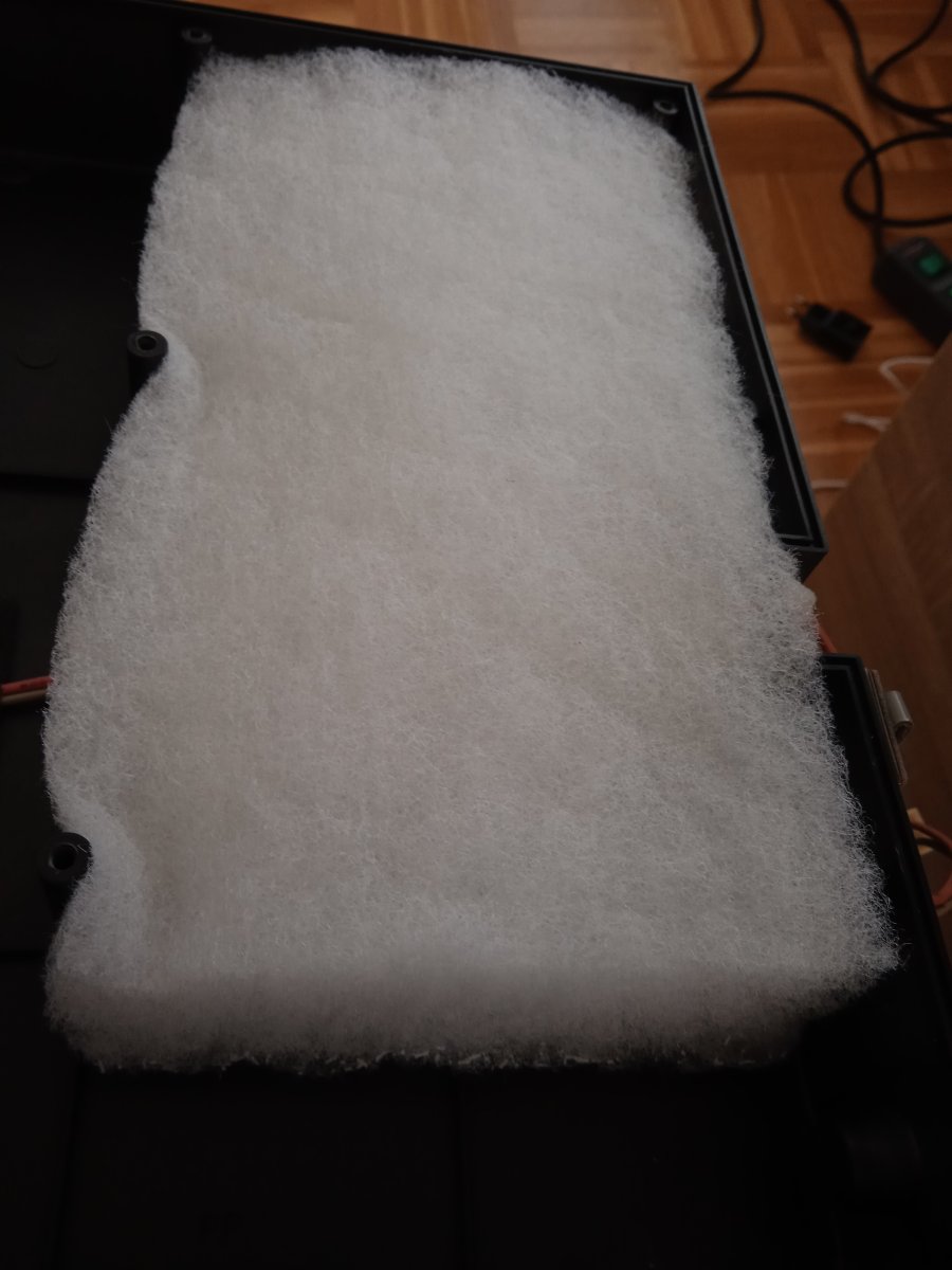

Hello, I am about to make my Blast City completely inside and outside like new. So how can I put these old dirty yellow bags back in ?! So today I was in an audio store and asked what it is and if they have something to replace. Answer: It is nothing more than insulation wool so that the sound goes where it should. Previously, such a thing was made of fiberglass today from polyester fibers of various thicknesses. So I bought 2 mats of it right away. I have these then cut to size and now everyting looks like new (well because it is :D)

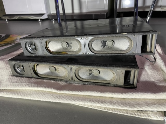

If you want the driver to slide in, there's a lip on the edge of the enclosure that you have to take off (check the first pic in my post). However, the plastic is quite thin and does have give, so I guess you could force the driver in. However, I only eyeballed it and was like, nope, not going to fit, and then hit it with the dremel.
Just catching up here and want to be clear… you dremeled about a mm off of the plastic enlosure and not the driver itself right?
From the enclosure, yes. You don't want to dremel through the driver.

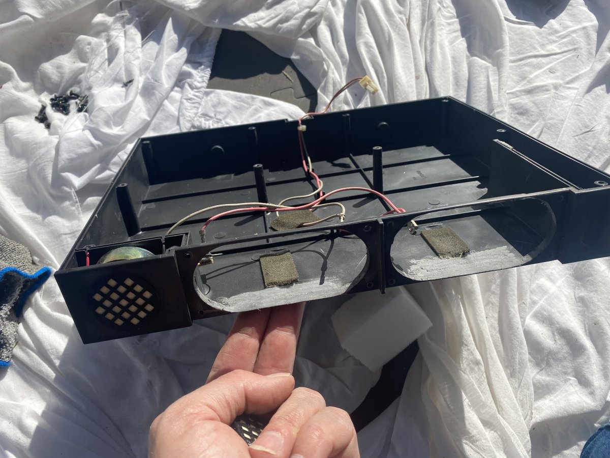

How much bulge do you have from installing the speakers? Did you dremel enough material away? Not sure if you have the back shell of the cabinet off also but this makes like a lot easier. See my pics below for what I did based on advice here. Also I mistakenly put one of my speakers in upside down but I’m not sure whether tweeter was up top or down below. 😞

I have probably the same amount of bulge as you do. Dremeled about 1mm off each side and left as little material as I felt comfortable with.
