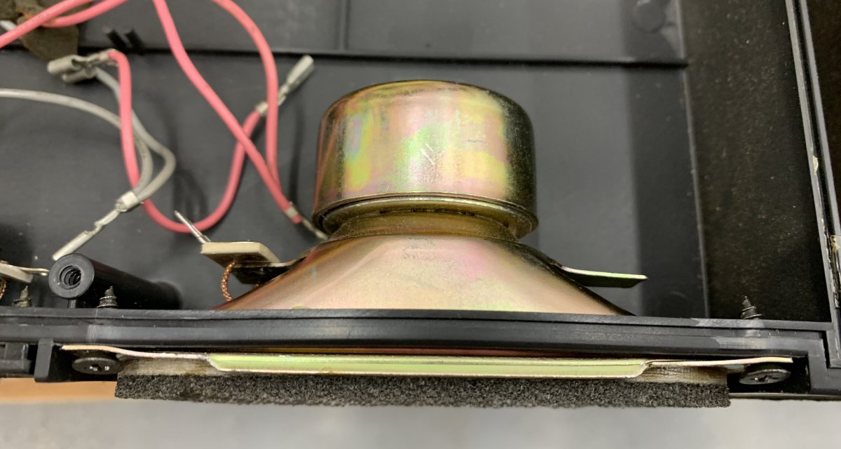

I used a really light foam (i think it was spare ESD foam from an Arrow.com order) and it didn't do enough to dampen my tweeters. It's such a pain in the ass to remove the speakers that I think I'll just live with it. One option for me might be to get some tweezers that can fit and allow me to stick another layer in there without dismantling the whole goddamn thing.

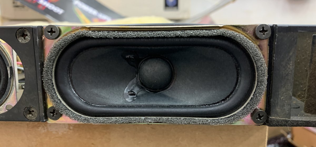

I dont have a working dremel at the moment so i cant cut the brackets off and show the fit but i lined them up with the old speakers and they are pretty much exactly the same size. They are Sharp 1004PB408A. Just need to trim off the side brackets and drill 4 holes and thats it!
Edit:
Found my working dremel and this is just a quick test fit. I think if I trim the plastic a tiny bit it will fit perfect

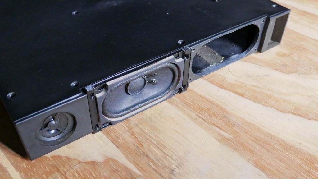

Well, I finally installed my Aurasounds that I ordered a year ago. Better late than never!
I think these are a fine replacement. I don't see any reason to look for better alternatives. Cheap too! Here's how I installed mine.

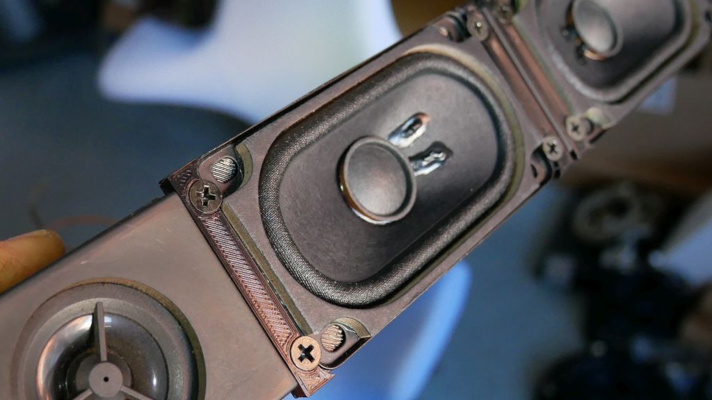

The Aurasounds are slightly wider than the original drivers. For better fitment I dremeled a millimeter or so from both sides. Before and after pics:

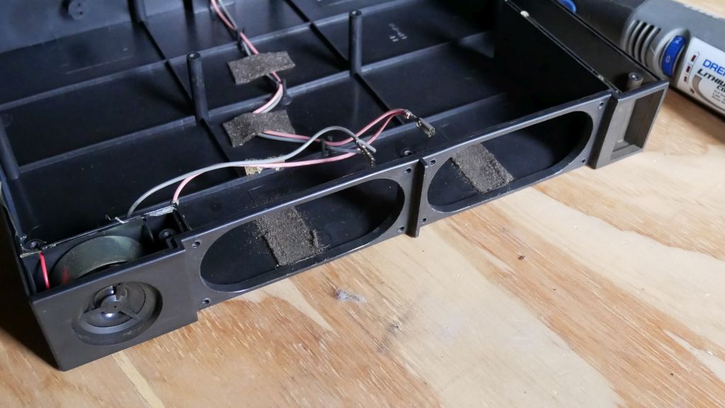

Then I modeled this adapter plate and printed it:
Here's the Aurasound sitting in its adapter inside the speaker enclosure:
Looks good to me! Not a whole lot of bulging. What's great is that the four original screws will hold the driver down perfectly. You could put some silicone for a better seal, but I went without.

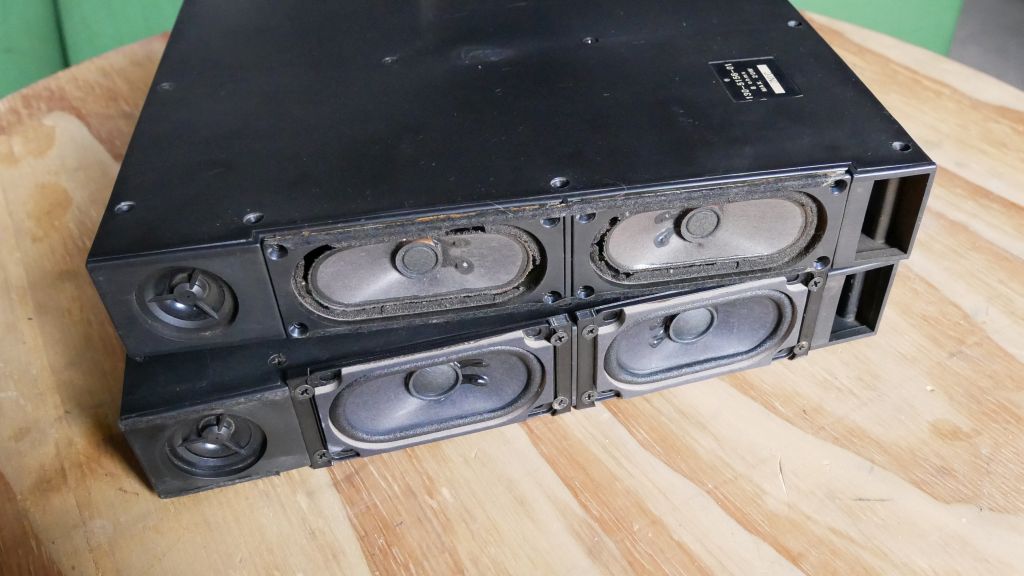

Here's a stock speaker and the refurbished speaker below it:
The adapter plate is attached as an .stl if anyone else wants to use it.
Nice work... but looking at those pictures I badly want to stick a big-ol chamfer on corners of one side so you have a nice ramp to the larger width instead of a step...
Nice work @nem too bad I already swapped my speakers out. Don't forget to muffle those tweeters. I even thought about completely disconnecting them.
