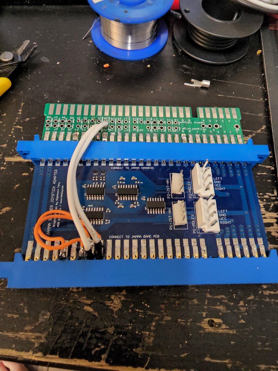

at least one hand is. the other has a tattoo. i have tried eco fighters with the Brizzo adapter and the spinner moves the ship left and right with inverted controls. wiring is different in bothe left and right movement as well 5v and ground. I also made a passthrough adapter for it with button 1 and 3 for left and right and that didn't work either. maybe someone could make game specific boards or a rom that allows the spinners to work

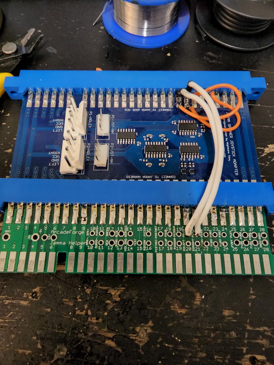

This is the adapter I made for the Brizzo adapter. It isn't pretty, but it works. And it's the best of what I had laying around. The Brizzo adapter's pinout is different than the pinout on the cps1.5 spinner PCB so you cannot just solder on a JST NH 4 pin male connector and plug it in... even if you install the connector to the pcb backwards.
It took me a while to articulate this into words properly and for that i apologize.
This is the modified Brizzo adapter used to get Eco Fighters working. refer to https://www.arcade-projects.com/thr...ers-without-a-spinner.8020/page-2#post-346697 on how to wire up the adapter. special thanks to @Bonky and @West for helping me figure it out.
