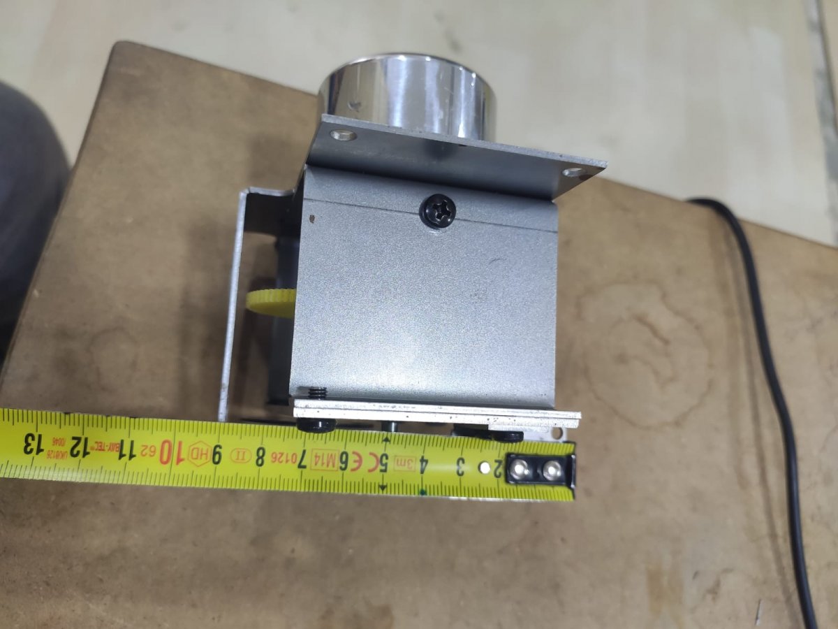

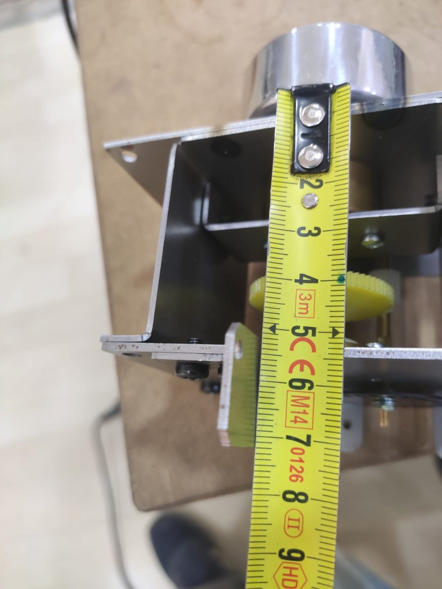

Lets check the pictures. All the measurements are Metric. It is CM
DEPTH : About 8CM with Micro Switch.
LENGTH of the plate : 10,5 CM
WIDTH: 9CM

I think the biggest problem for tight panels is the depth, and the biggest factor in the depth is the microswitch mounting.
The vewlix is probably the tightest control panel housing in terms of depth. Do we know what the available depth is in a vewlix housing?
I think if the micro swich was mounted upside-down and we used a small upside-down see-saw lever to actuate it you could probably reduce the overall height by ~2cm. you could probably reduce the height another 1cm by just shrinking up the vertical thicknesses and clearances as much as possible.
