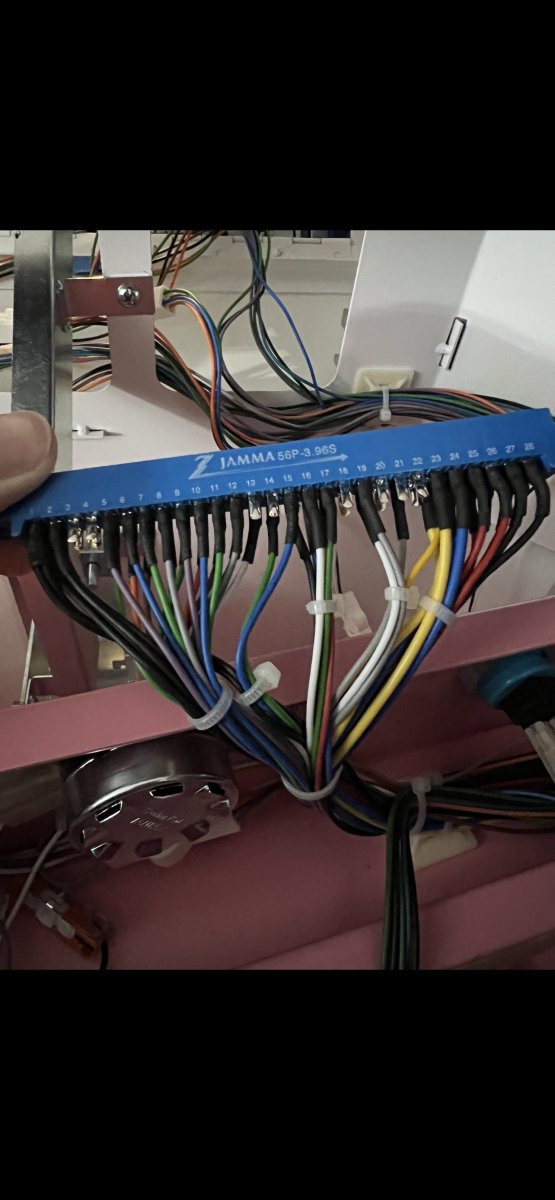

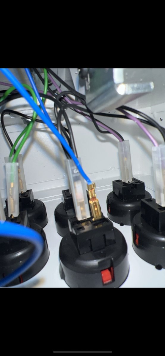

Hey everyone,
I have a Capcom Minicute repro from Hurist, running it with a Mistercade through a Jamma harness connected to a Wells Gardner 19" monitor via an isolation transformer. Everything is working fine except for the Player 2 "Button 2." I used a multimeter to check the continuity between the two wires on B2, and it showed a connection. Initially, I suspected a loose pin on the Jamma harness for B2. I replaced the pin (Pin 6), got a new wire for the button, and connected it directly to the Jamma edge avoiding the JST connection, but it still doesn't work.
The strange part is that if I lightly touch the wired button's spade connector (not the ground connector) with two fingers, B2 works fine. This makes me think it's a grounding issue. I wiped my Mistercade, reinstalled and updated everything, but no luck. I bought a new Jamma edge (Hirose 56 pin) to test and am yet to receive it, but I'm unsure if the wiring on my Jamma is correct or not, specifically for the ground, or if it's the Mistercade. I attached some photos below.
I tested the wiring from Button 1 and Button 3 on "Button 2," and those inputs register (button 1 and button 3). This shows that the physical button for "B2" is working. It's puzzling that there may be a grounding issue when all buttons work in a grounded daisy chain except for B2. Any advice on what I should do?
It shouldn't unless you've pressed the button down. I'm assuming something here's mistyped given the rest of your post, but it shouldn't show continuity if the button is unpressed.
It should be :
Pressed: continuity
Not pressed: no continuity.
You're also making the situation more complex than it should be by trying to replace different things and not starting with a JAMMA board to begin with.
Don't redo the entire JAMMA connector, there's no need over one button.

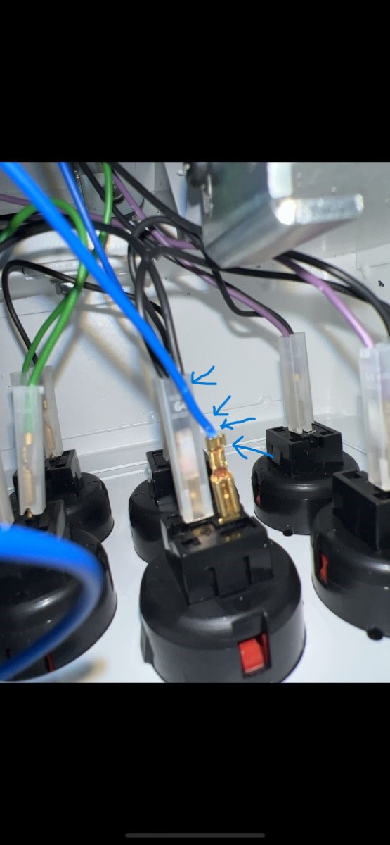

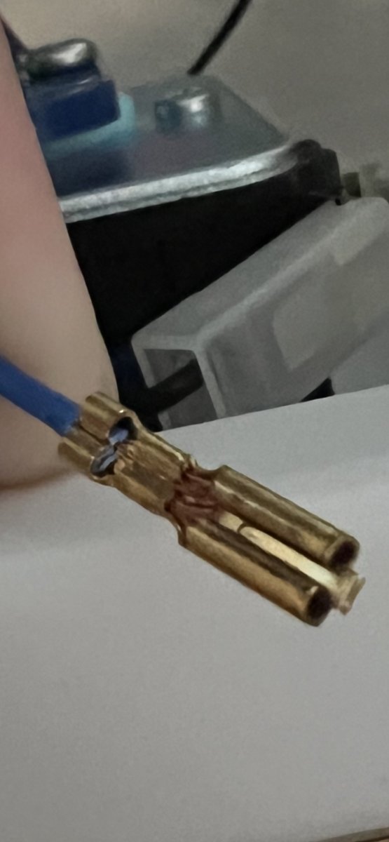

The wire on button 2, the blue one, the connector is poorly crimped on, and there are several bits where it was pinched or bent. Adding in this:
it really seems like your crimp job is the problem. I'd cut that wire back half an inch, and solder it on directly and see how it is (will eliminate another potentially poor crimping job from the equation long enough to test.)

You can see 3 spots where it's creased (and potentially severed, and would make a connection if pressed with your finger) and that the connector itself has been bent by your crimper (I'd guess you used too small of a size when crimping).
With Hurist's original wire, I would touch the spade and the same thing would happen. I cut his off and did a horrible job crimping a new one on and tried it again, still needed to be touched. I cut a brand new piece of wire, put a good crimped spade on it, connected it to the button, and then directly wired that to the Jamma connector, the issue still persists, I apologize for the lack of explanation.

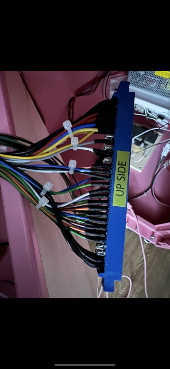

I heard that the Jamma harness brand used in this project often has problems with grounding wires not being soldered properly to the Jamma connector. The heat shrink used also makes it hard to see if the connections are good or not. Even though I could cut off the shrink to check, it's weird that every other button works fine in a daisy chain, except for the "b" button. This makes me think it might not be a grounding problem...
There's a very easy way to rule this out. Take the ground connector from one of the working buttons and swap it to the button that isn't working.
Anyway, what I would do next is I would continuity check the connection for P2B2 from the jamma harness to the button. One meter lead on the harness pin, the other on the spade connector.
Hey how's it going, I did the first part of this and took the ground from a working button and swapped it to the "b button" that wasn't working, this lead to the same result of the b button not working.
When I get home tonight I will do what rewrite stated previously and also check the continuity between P2B2 and the Jamma harness. Thank you very much for your help!
I will hopefully be ordering a Jamma board as well to test this, it's just unlikely the issue is my Mistercade setup.
