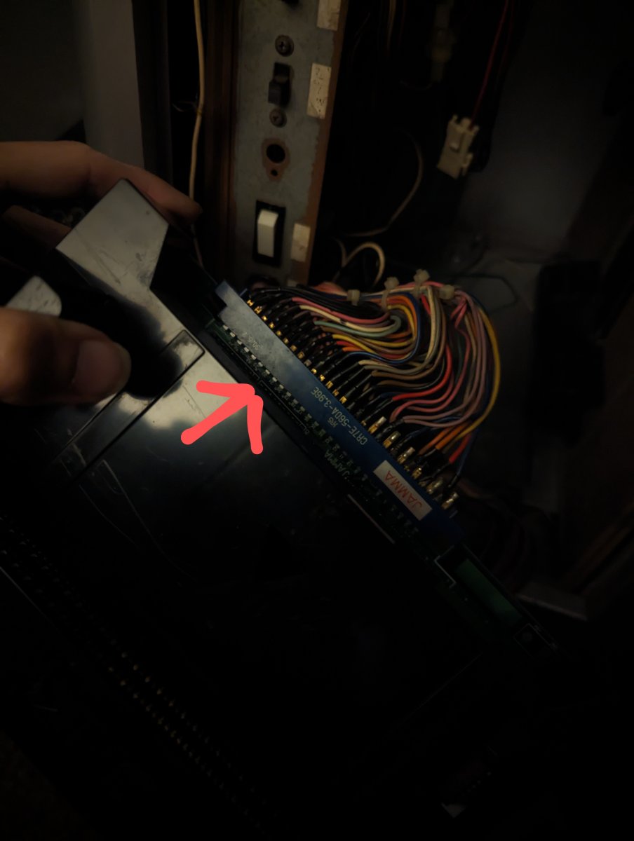

No, approach them from the other side. Use the pins on the PCB rather than the harness.
Didn't realize how dark it was when I took it, but it should get the point across, lol.
May be a stupid question, but I am testing this with the Mistercade still plugged in correct? Also, going to have to test tomorrow unfortunately, I need another hand and that person is now asleep haha.

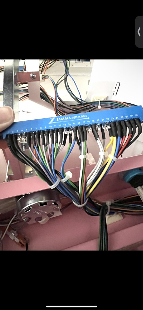

Hey @rewrite, when looking online at the standard Jamma layout, the wires on this don't seem to match, does something look off to you?
- Trying to determine the 5V and 12V pins as well as grounds.

Here is Hursit's, maybe I'm just not able to identify them properly lol, I'm sorry.

Pin 1-2 gnd , pin 3-4 are +5V , pin 5 is -5V , pin 6
Pin 1-2 gnd , pin 3-4 are +5V , pin 5 is -5V , pin 6 is 12V .
@Sky64 Pin 1 or 2 black wire , pin 3 or 4 red wire (adjust psu to show 5.00) for +5V , and for 12V same only put red wire on pin 6

Thank you, this makes sense now. I was looking at it on my harness and it showed 1-6 on the left, but I know for a fact that pin 6 on my harness involves the P1 and P2 button 2. Should I first test this without the Mistercade connected and then plug the Mistercade in and test it again? I know @rewrite said to do this with it in but I've seen some people test just the harness as well.

Flip your harness around so that you are looking at the black and red wires to your left...
Just don't plug it in this way, lol.
But yes, counting from the wrong side.
You sure you haven't plugged the harness in the wrong way at some point? It's an easy mistake to make, and if you have, you'll have put +12V through the player 1 and 2 button 2 inputs.
