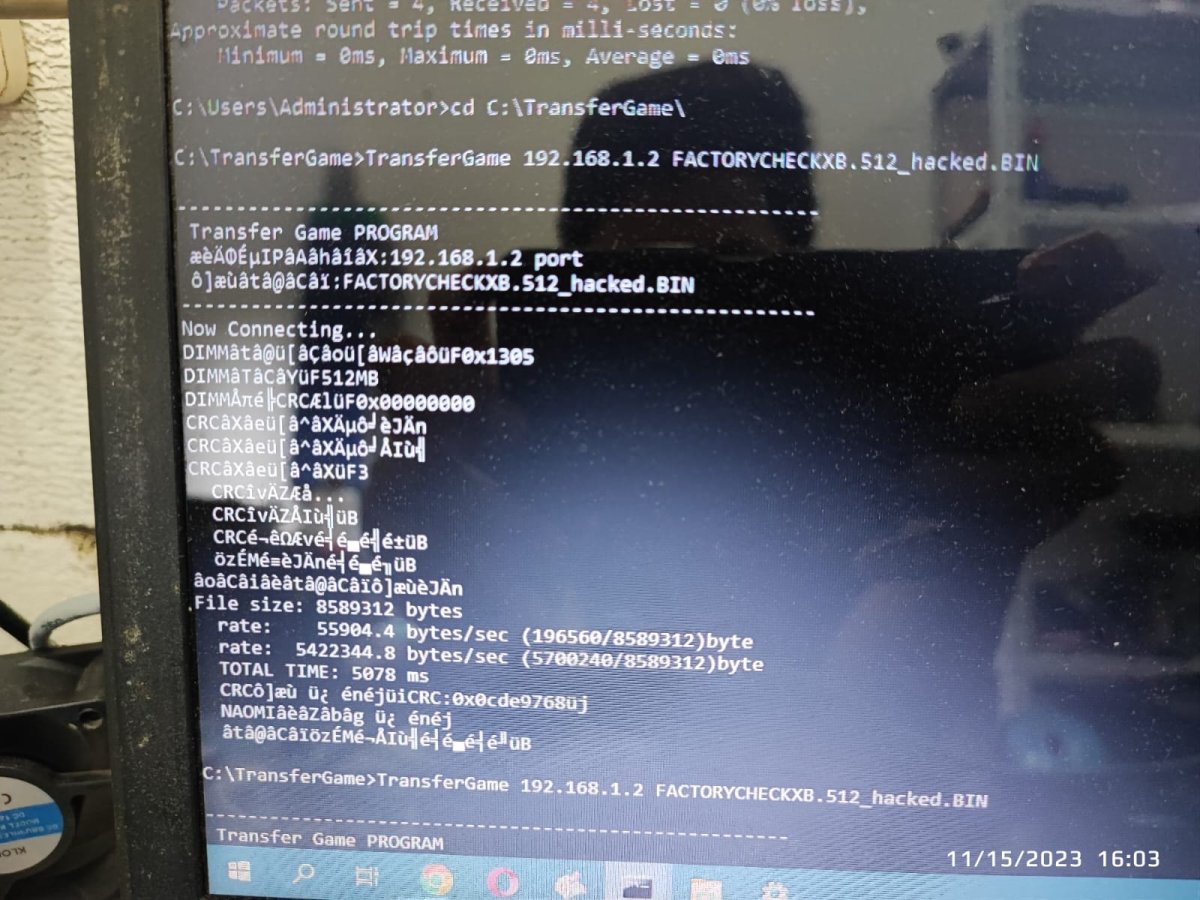

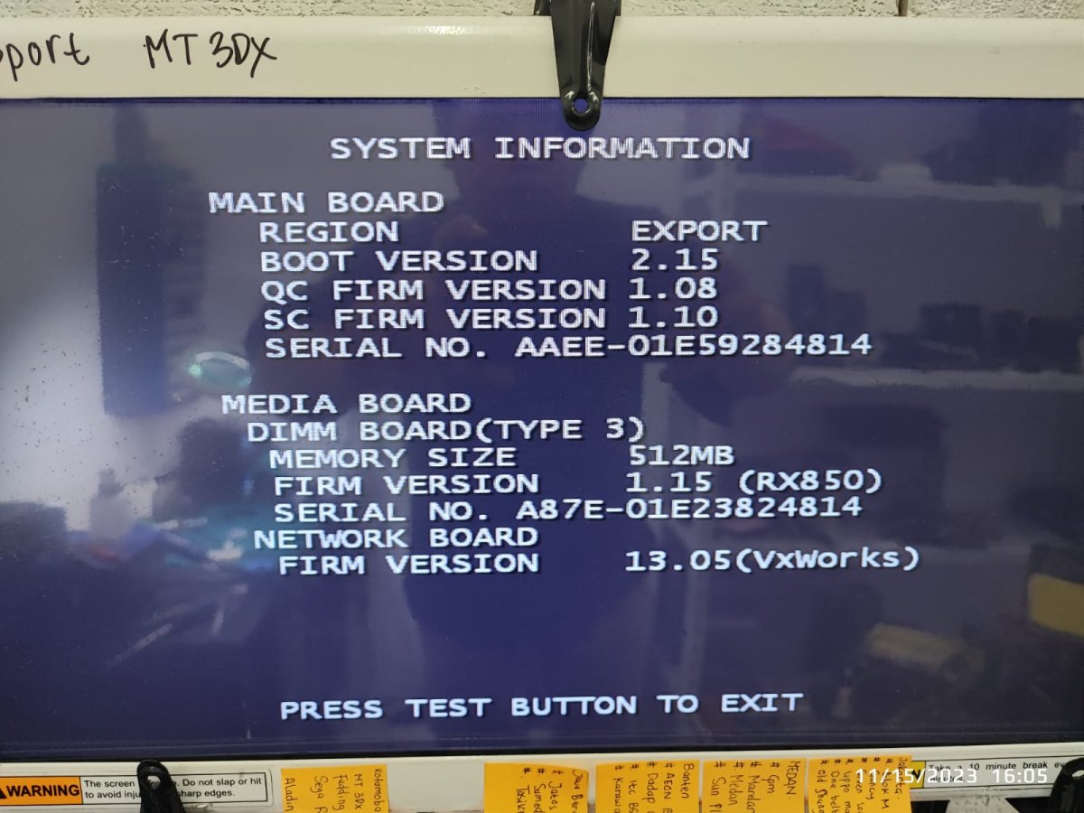

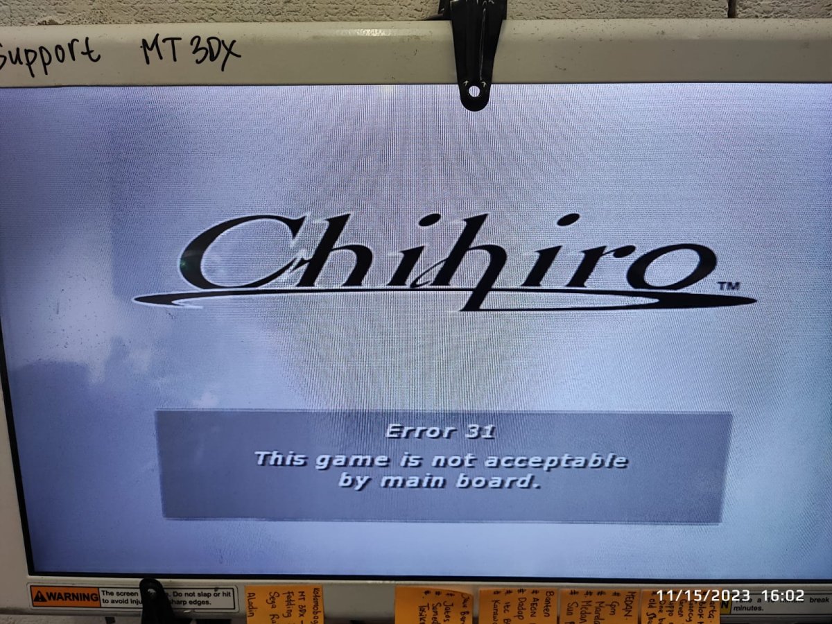

Hello all,
Sorry I wanted to ask, I have problem with Chihiro Type 3, I tried netbooting to upgrade the Firmware, but when doing so the Chihiro rebooted about 2 times then ended up with Error 31 and no change in system information. is there something wrong with the steps I've done? Thanks before

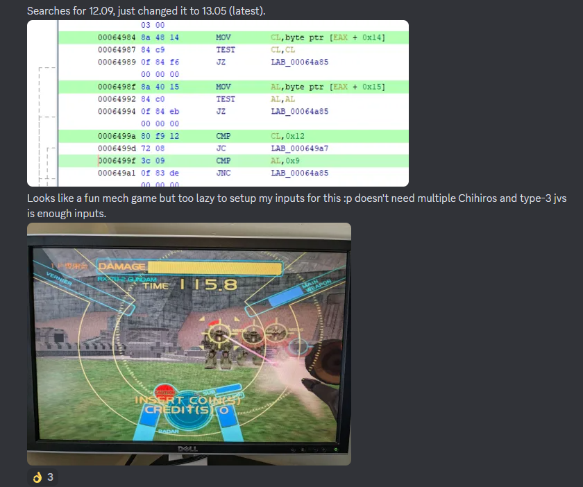

On all Chihiro net-dimm supported games ? I remember seeing something like this on some of them like the gundam games as they need a specific board to run, due to the analog inputs.
Gundams biggest blocker is it expects a specific netfirm revision that hasn't been archived. I ended up editing the game to just check the latest (plus a custom kernel, wont work on any public even hacked).

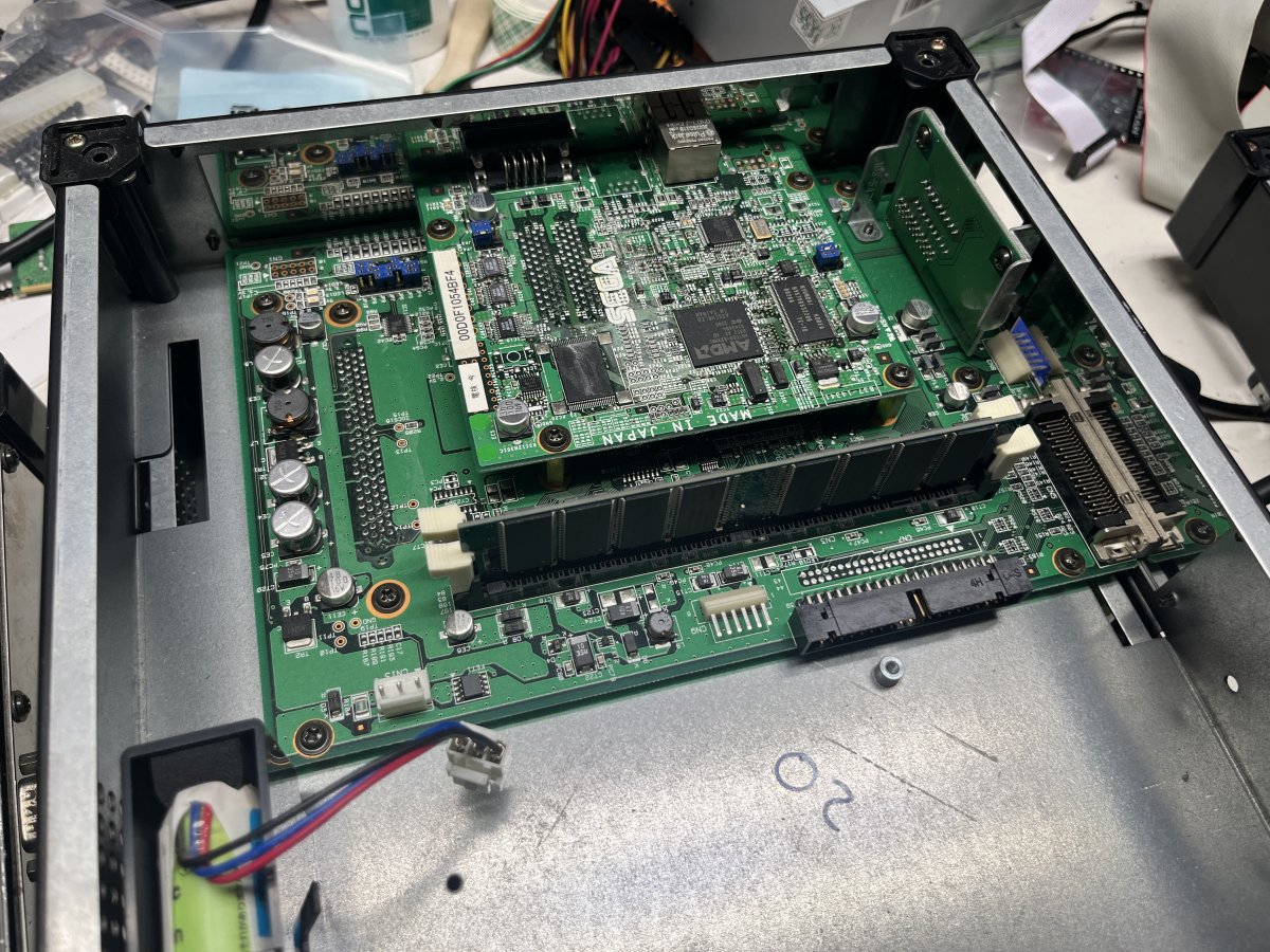

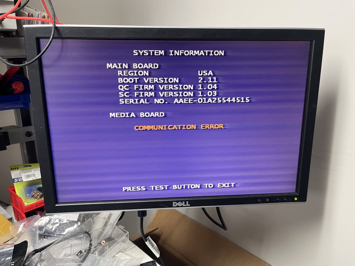

Hello, hit an issue trying to upgrade my firmware to FACTORYCHECKXB.512_hacked.BIN.7z with goal of running pair of Outrun2 from CF vs GDROM.
Partial recap on main xbox board, new paste, removed the danger cap, replaced the supercaps (guess not needed, oh well) new batteries all that.
Type 3 dimm, fat board with the IDE connector in the sexy top box that matches the profile of the Chihiro.
Chihiro specific zeropic from mitsurgi-w
I shot the file into it with triforcetools.py, got the updater. Hit next a few times and it said it was updating.
It never said "process completed hit button to restart" (Saw this from someone else's screen shot.) It rebooted on it's own and just went back into the updater.
I think I might of nexted all the way thru it and it ran again, rebooted again. Pulled power.
Now I get error 22, media board not responding.
Any thoughts where I went wrong? I have some spare parts so I have one extra media board and network board. I regret not taking pics, afraid to update the others.
I did not walk up the versions to latest firmware before the hacked version, and don't remember what it was running before hitting go.
I read that there is default firmware copy and then the updated firmware, and it should revert to default in case of issue. JP1 only pertains to the ethernet board's firmware right? Not the media board? TSOP swap?
Any pointers appreciated!
Assuming that you followed the instructions and put the jumpers as needed, then if it says bad media board, maybe there's a problem with your media board. Try swapping the media board with a working one and see if it works now. This firmware has been tested by hundreds of people, so we know it's good.
I didn't really see any specific instructions, I just read 15 pages on theis thread. I did the normal thing of setting the Type-3 NetDIMM to boot from network not GD-ROM, gave it a media board IP and gateway and pushed the file into it from my Linux server. I didn't do anything else.
I have two more working media boards, I can see what happens on the next one and document it.
