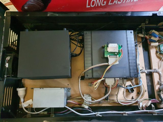

Sounds like it is not working which is strange. Can you show us a picture of your Chihiro unit please.
It's a type 3

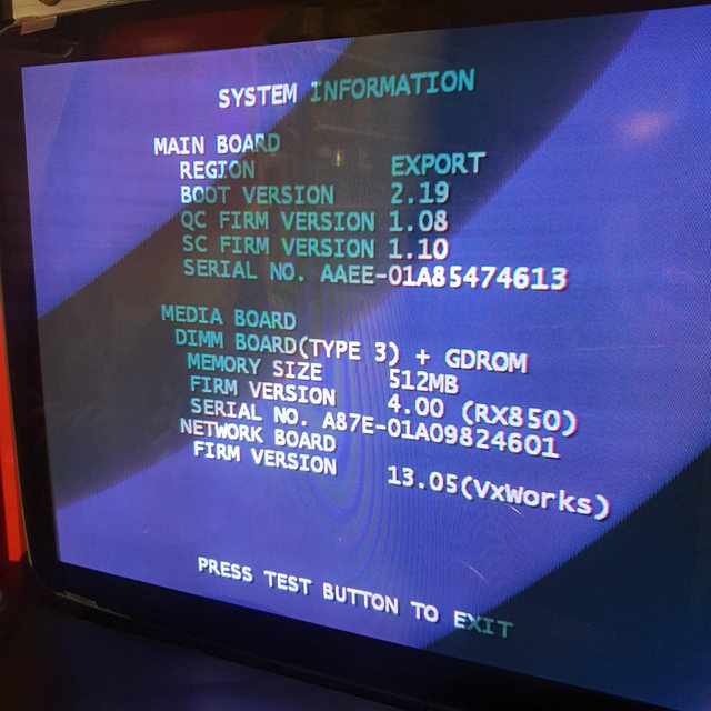

Hey guys, just playing around with the Chihiro now that I've got one and wanting to create other games on CF
Here's the information I have of my chihiro
As you can see the FW info seems to be the same numbers as the one located on the first page of this thread. Does DS' bios and original differ in anyway (identifier wise?)

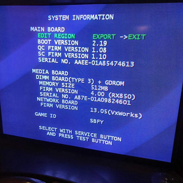

So I've officially fixed this by doing what @nem suggested, I just updated the FW to DS' one and everything else fell into play, it turns out my Zero Pic was perfectly fine after all. In hindsight, I should've just updated the FW straight away, but I was mislead as all my information on the chihiro already matched the first page of this thread
What I'm not sure of is I got this message when I was updating
However, even once updated, it still stated 2.19 vs 2.20
Nevertheless, after updating the FW, the same zero pic was freshly burnt and I was able to get the change region option and I've been able to CF boot with games made using @rtw's gcfi tool

Looks like in this particular case it was the fw of the chihiro, I was well and truly mislead with the information on my chihiro.
Interesting - as my screen matched up exactly with yours - but, glad you got it working!!!! Thanks for posting - it will help others trying to get this to work.
The revision not staying at 2.20 is just something leftover from when we were testing the custom fw. It allowed us to more easily rewrite original fw if we messed up. @Darksoft just never got around to allowing the version number to change.
So @mR_CaESaR the hacked firmware versions are exactly the same as the original ?
The behaviour I see is the difference is the ability to read the CF card created by gcfi. That's the only "change" I made to the Chihiro, I netbooted the hacked fw and then used the same cf card and zero pic and it worked, so I can only assume my chihiro didn't have the hacked fw on
