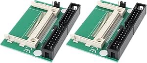

This is what i connect to the internal connector
Please take a photo of your actual setup.
You cannot connect two male connectors together so you must be using a cable ?
Exactly ! With an ata cable. Im going to try with another cf adapter...
