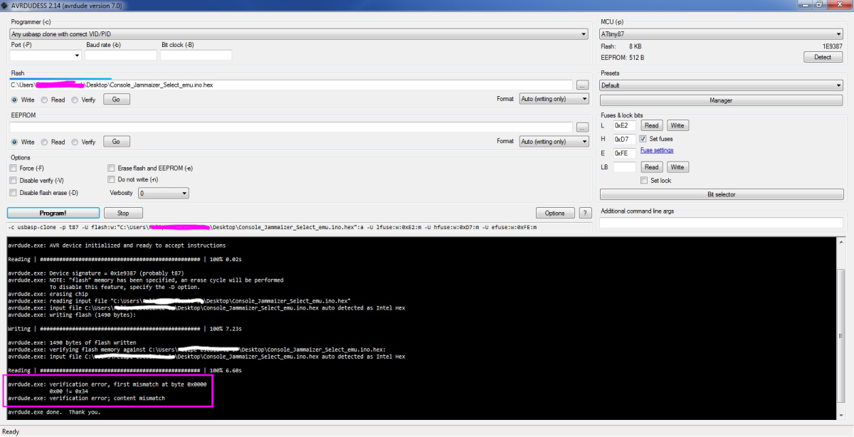

Looks like it may have been bad microcontrollers all along as you said. I am postulating that due to the supply chain shortages, the ones I picked up just before the shortages hit were sourced from suppliers that pushed B-stock runs of the chips out to market. Bought a batch of 10 from Digikey a week or two ago and they all programmed externally using an SOIC-28-to-DIP adapter......almost perfectly.
But I did get a verification error (below). I am going to rework off the bad ATTINY87's off the mainboard, solder the new ATTINY's in. I'll find out soon if the verification error means anything, but just checking if this is known. The hex file used was download from the GitHub master project. I made no edits whatsoever.
The first mismatch 0x00 is at 0x0000 (ie. at the very beginning). I would say that means nothing was written.
Read the chip and see what you get.
Damn, I soldered one in already. Just when you think you finally made it over the hump :/
EDIT: Was able to program the chip in circuit as Arthrimus prescribed. Seems there a lot of bad ATTINY87's that were pushed to market due to the supply chain issues. I just ended up with a lot of them.

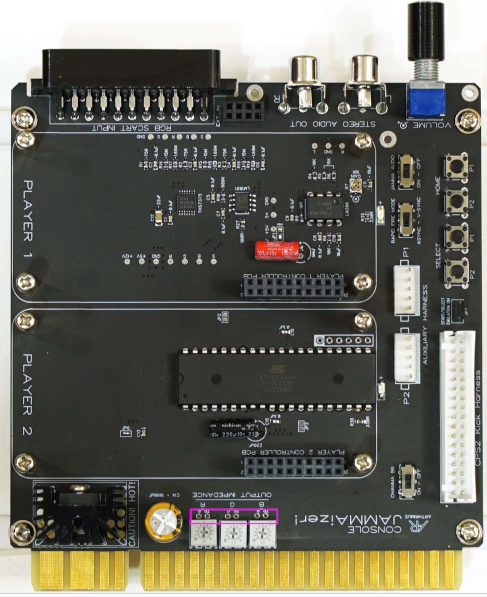

Also had another question. I’m not sure if this is an issue with the jammaizer, but I’ve turned down the impedance controls all the way, and on my UMK3 cabinet the brightness is still way high compared to the other jamma boards I’ve used in the cabinet. I’m using the VGA hat with vga cable straight to the pc video card. The monitor is a Hantarex 9110.
If I am not mistaken, a clockwise turn on the pots will dial down the impedance. Counterclockwise will turn up the impedance. So you might have turned up the impedance and are overdriving your monitor through the JAMMAizer. Here is an excerpt from the manual:
"You can check the output impedance setting using the vias labled TP_R, TP_G, and TP_B for R, G, and B respectively. In stock form they are adjusted to approximately 475ohms but you can adjust them anywhere from 1Kohm all the way down to 0ohms. For most monitors the stock settings will look great and likely won’t need any adjustment."​
You'll need a multimeter, but enboxed in pink is where you would measure/calibrate the impedance:
