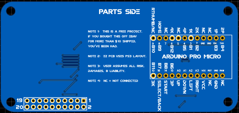

  • and a PCB I created to fit the Daemonbite Encoder into the form factor for 2x10 MC PCB's originated by Akishops, now popularized by Brook

Arthrimus's MC Cthulhu EZ PCB and my PCB for the Daemonbite Encoder. Once I get to testing, I'll check if I made the Daemonbite Encoder PCB correctly and release the gerbers for that. Cheap solution for controlling MAME or MiSTer with super low latency.

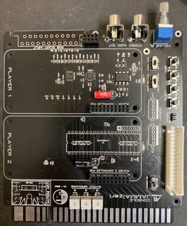

Here is a pic of the JAMMAizer's assembly thus far in comparison to the one I bought from Arthrimus (middle). Still awaiting some components before I get to testing, but everything is chugging away smoothly.
As for supply chain shortages impacting assembly, the gold audio-grade Nichicon UFW/D series capacitor near the JAMMA edge connector is OOS everywhere. I don't think this is an issue as I have never seen audio grade caps used on an actual arcade PCB. I've never heard of high-grade JAMMA mono sound anyway, so I'll just use a general purpose capacitor. I can always swap out later. Anyhow, once I have a substitue for this cap, I can then get to testing. Should be this week. 5-position JST NH headers used for buttons 7+8 are also OOS everywhere. As a substitute, I suppose I can use a JST NH header with more positions and just cut it down to 5-positions. Or I can use JST XH. But I've never seen a JAMMA or JVS based cab come OEM with 8 buttons (yet) either. I don't have such a cab, so no biggie for me.

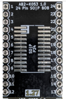

Speaking of the ATTINY87, I've went through two different SOIC20-to-DIP20 programming adapters (one that came in the mail today) and neither can accommodate the width of that IC. I did dry fit the ATTINY87 to the JAMMAizer to confirm it is the correct size. The IC's still won't fit into the adapter. Options online pretty much are all the same. Going to be really hard to program HOME/EMU circuit. That is another challenge for anyone that wishes to fab these up on their own.
Might need to use a breakout PCB like the one above just to get it working.
EDIT: Problem solved. I used a larger SOIC28-to-DIP adapter. It was able to accomodate the width of the ATTINY87 and programmed it lickity-split!

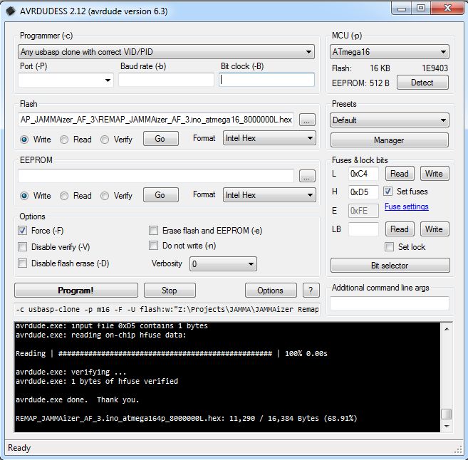

Solder your dupont wires to the legs of the ATMEGA16 and connect them to the USBASP according to the following images
Plug your Console JAMMAizer into a power source, either an arcade cabinet or a Supergun and power it on, then plug your USBASP into your computer.
DO NOT PLUG YOUR USBASP INTO A COMPUTER WITH THE CONSOLE JAMMAIZER POWERED OFF. THE JAMMAIZER'S PSU LOAD RESISTOR COULD POTENTIALLY DAMAGE YOUR USB PORT IF YOU PLUG IT IN UNPOWERED.
Using AVRDUDESS load up your HEX file, select your programmer, and set your fuses.
For your fuses you want to set the Low Byte to 0xC4 and the High Byte to 0xD5
Hit program and watch the magic happen. Once the chip is done programming and verifies, you are fully updated and you can now disconnect your USBASP and the programming wires and use your JAMMAizer as normal.
