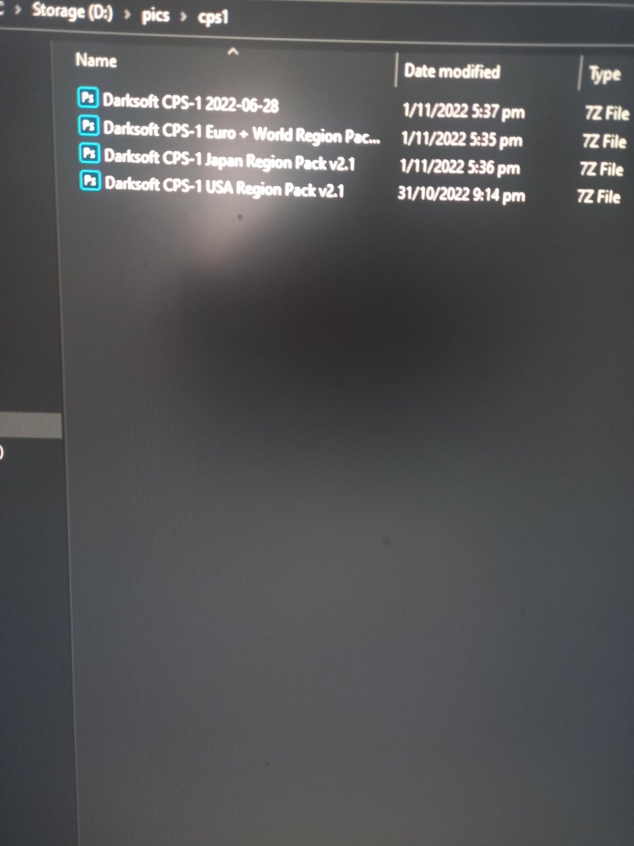

Are you copying the files with a PC or a Mac?
If you measured 5.1v at the Jamma edge with the board powered, then it means that is not the problem.
PC

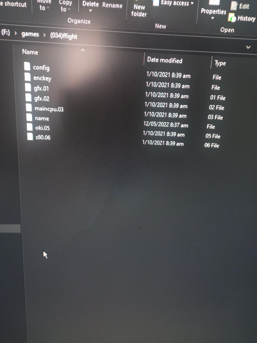

Most games play fine just the a few that don't and the games that don't work were all tested working by seller I found a link to cps1 packs and tried the us set and euro world set and had the same problems with the same games
I didn't try the Japan rom set

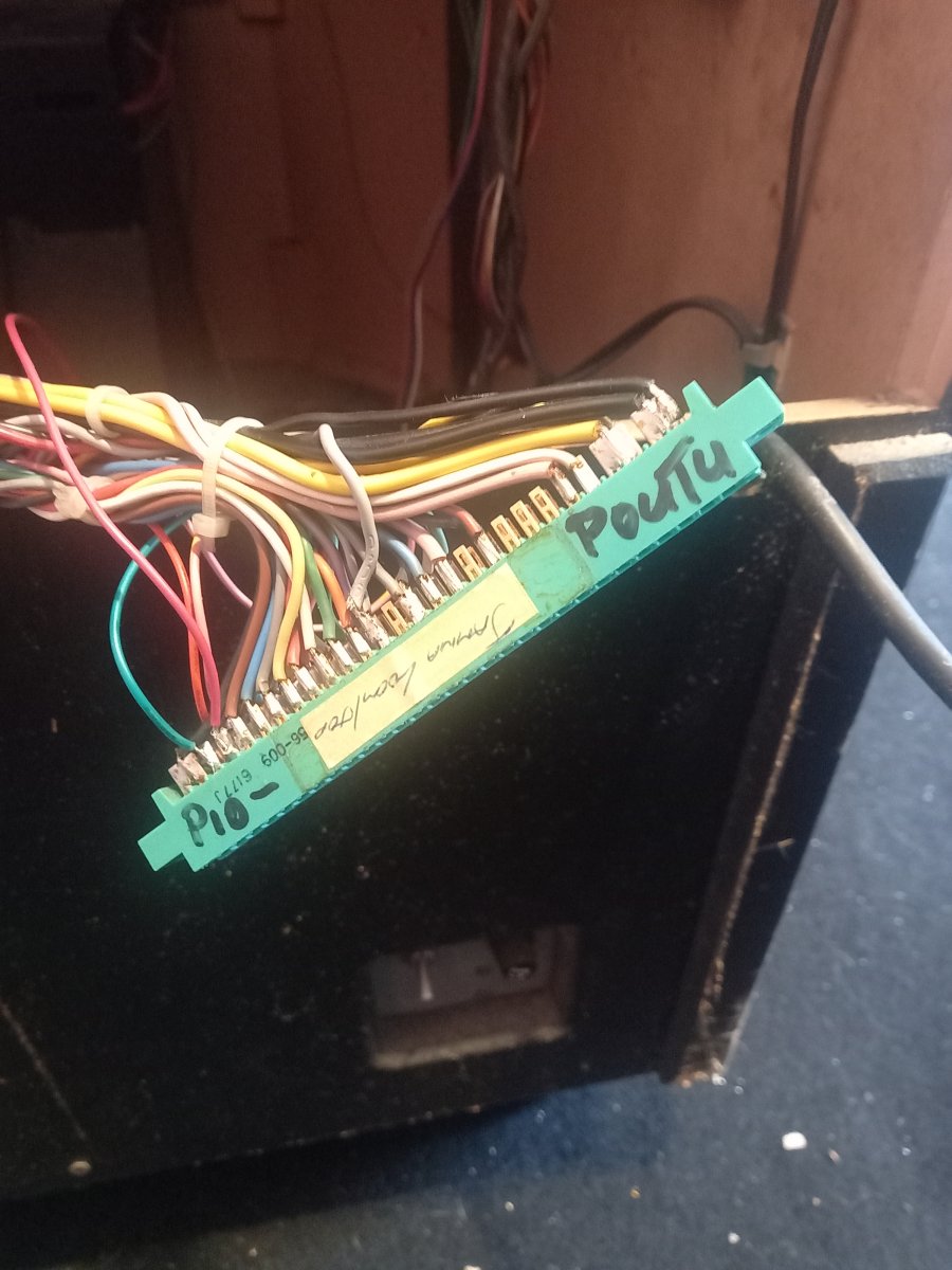

For clarification, can you please provide pics how the jamma connector soldering/wires look like? Specially the power/ground wiring. As said already by nem, it looks somewhat shady and not good enough...
Yip I'll take some pics I'm using a different harnesses to the previous one because it was getting voltage drop and my other machine does not
In saying that I've never had problems with that jamma harnesses before and had all sorts of boards running on it

first is the files on the sd card
then my jamma connector and voltage
