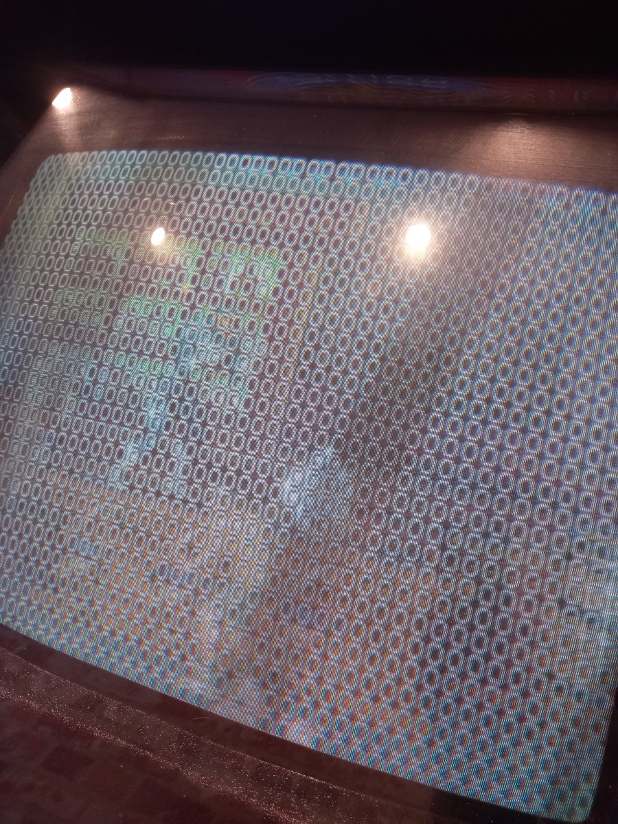

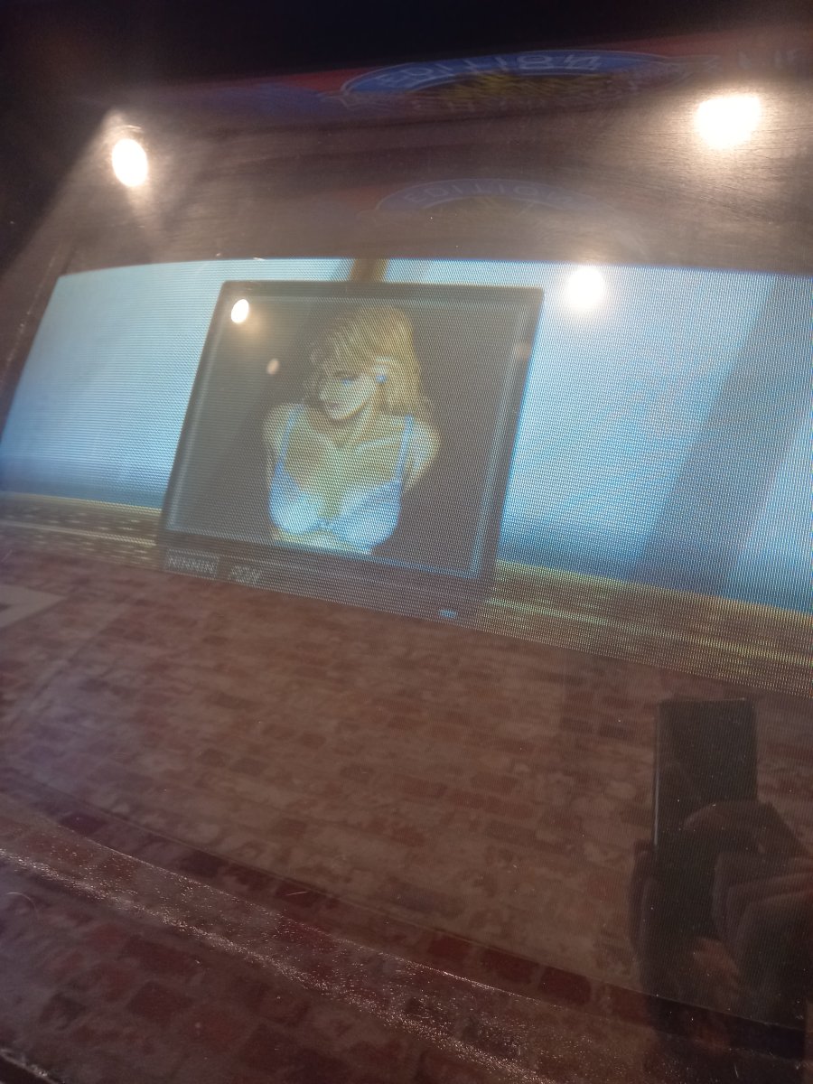

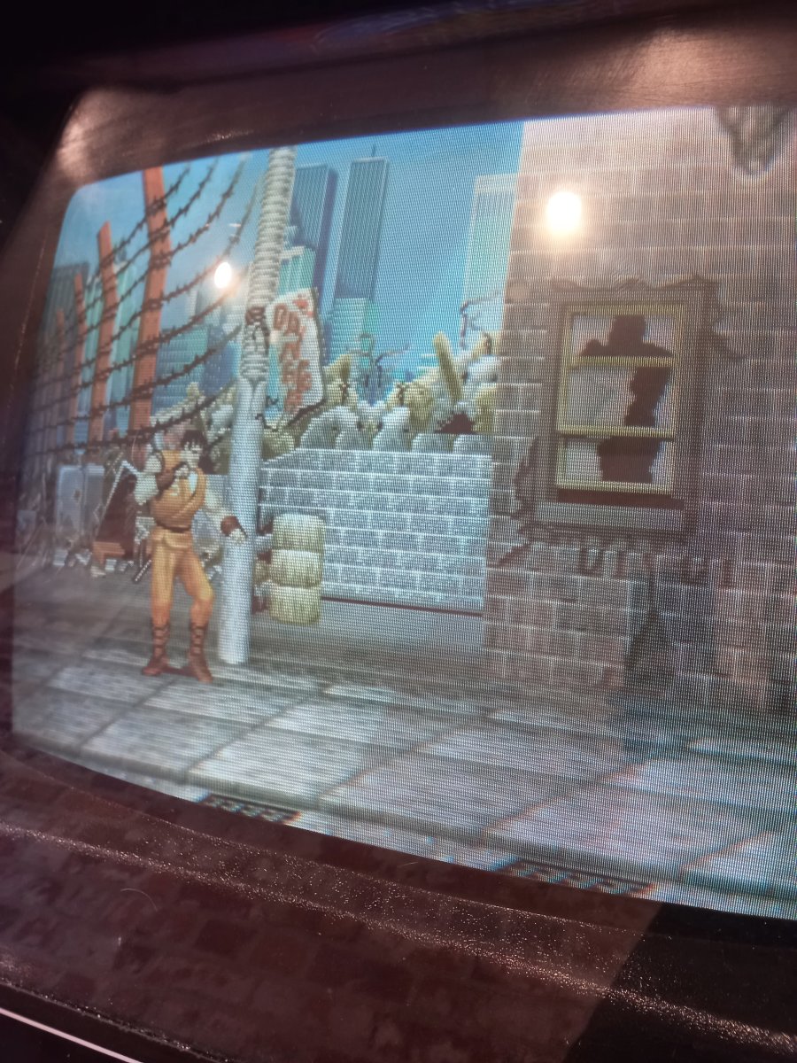

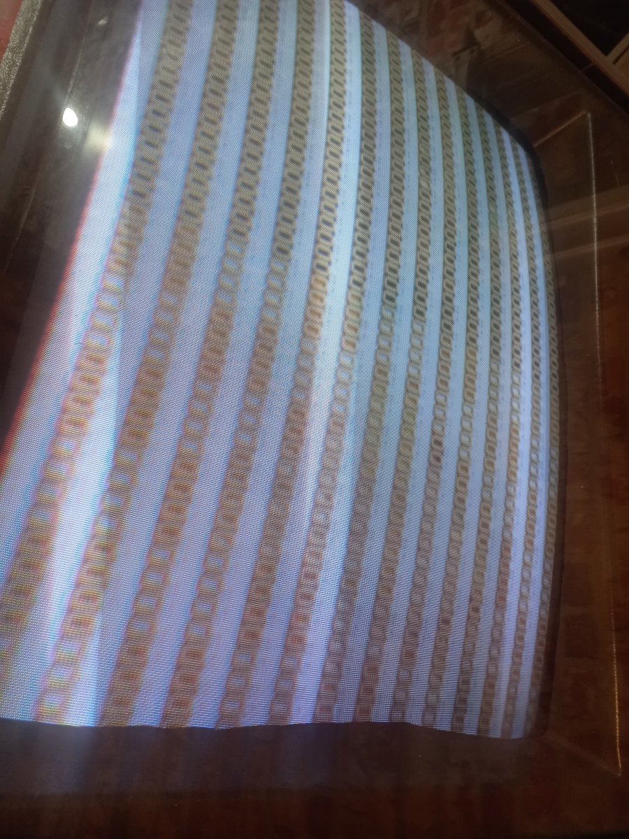

Did you copy the "games" folder at the root of your SD, without modifying its content (without removing games)? Preparing the SD with Windows? Which games don't work, what are the symptoms? The SD should be as small as possible (microSD HC).
Yes SD card had games root folder prepared on windows I tried us and world euro rom packs and had the same problems with the same games. 75% of the games work fine. Some that don't are punisher final fight mercs warriors of fate Cadillacs and dinosaurs. Final fight is missingwritingon the screen others graphics glitch. These games were tested working by the seller before I got it
