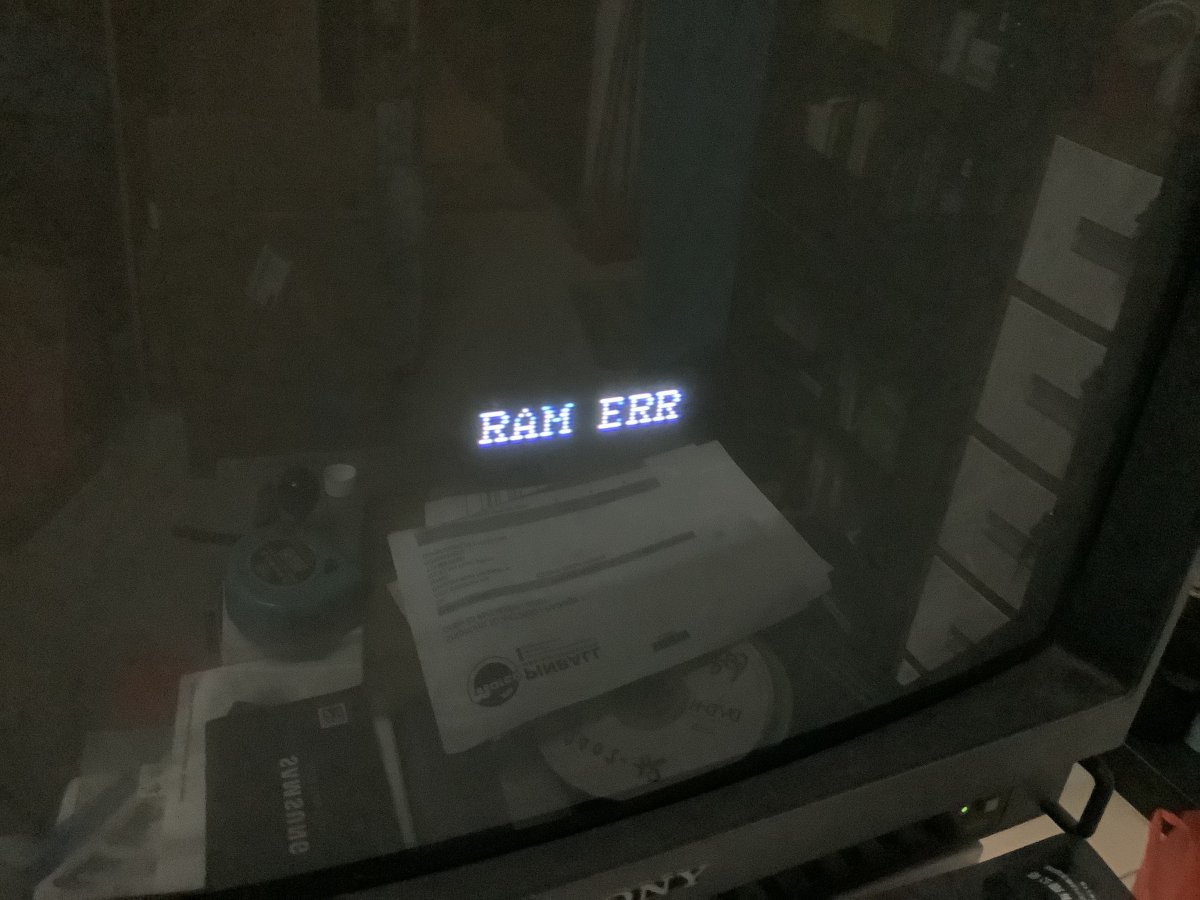

CPS1.5 game is not running
1、A board 89626a-4
B board darksoft CPS1/1.5 multi(buy from www.saveyourgames.it)
with a FPGA Q-Sound chip
C board come with cps1 multi
Pal come with cps1 multi

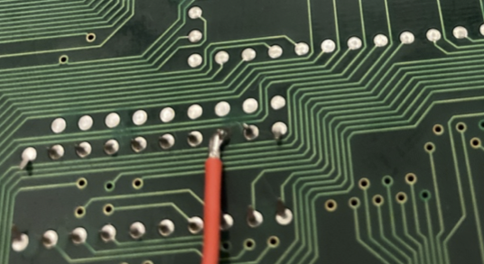

Double check the green wire reset and red wire qsound.
Change brand and reformated sdcard .8g 32g sandisk and come with mister sd card.
2 cps1 games is ok.and put the qsound.bin in the sd card root dir.
3 run cps1/1.5 games with the original PAL. On original PAL none of my qsound games booted. Cadillacs was black screen. Others 1.5 games get RAM ERR. Cps1 game is ok.
run cps1/1.5 games with the custom PAL. nothing change.
4 should I buy a custom pal from www.saveyourgames.it again?
5 I had asked www.saveyourgames.it for help, he sent me to this forum for help.
6 where can I get the custom pal or repair the cps1/1.5 multi kit? @Darksoft
Problem seems to be the PAL. Are you sure that the cable is properly connected? Are you able to write your own PALs/Gals?

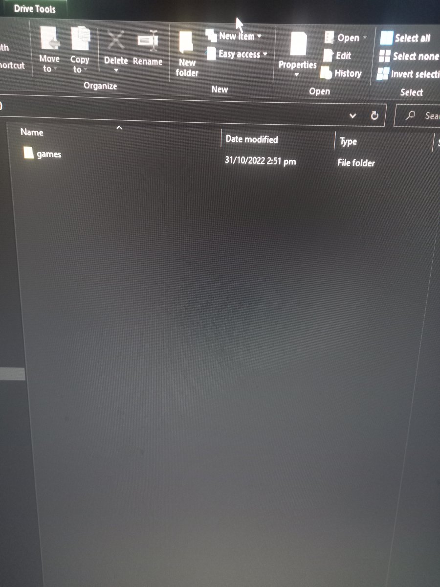

May have happened to others, but couldn't get the CPS1 multi to display any of the games after selecting from LCD. Erased and then black screen. Lots of testing. New C board. Connected A board back to original game. Everything is fine....
Turns out it was cus I had formatted the SD card and setup the games folder on a Mac. Once I reformatted the SD card in Windows and transferred the games everything worked. I'm assuming the Multi had issue with the hidden files Apple file system uses.
Glad you’re up and running @Lions3 — the hidden mac files do indeed throw the multi off. At the very least setting Spotlight not to populate on the SD and running a dot_clean is always the best course of action on all multis.
yes,I have use the multimeter check wire and the pal pin.
I am a newbie of the pcb.
which programmer and pal should I buy?
if I can buy the custom pal alone.that is easy to me
@Darksoft

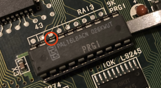

when I installed the custom pal come with cps1/1.5 multi.
I used the multimeter check the red QSOUND wire to the pal PIN is connected.

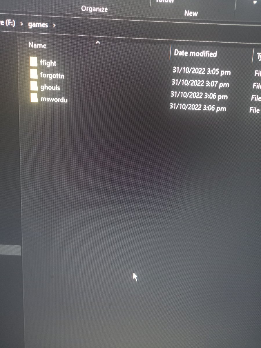

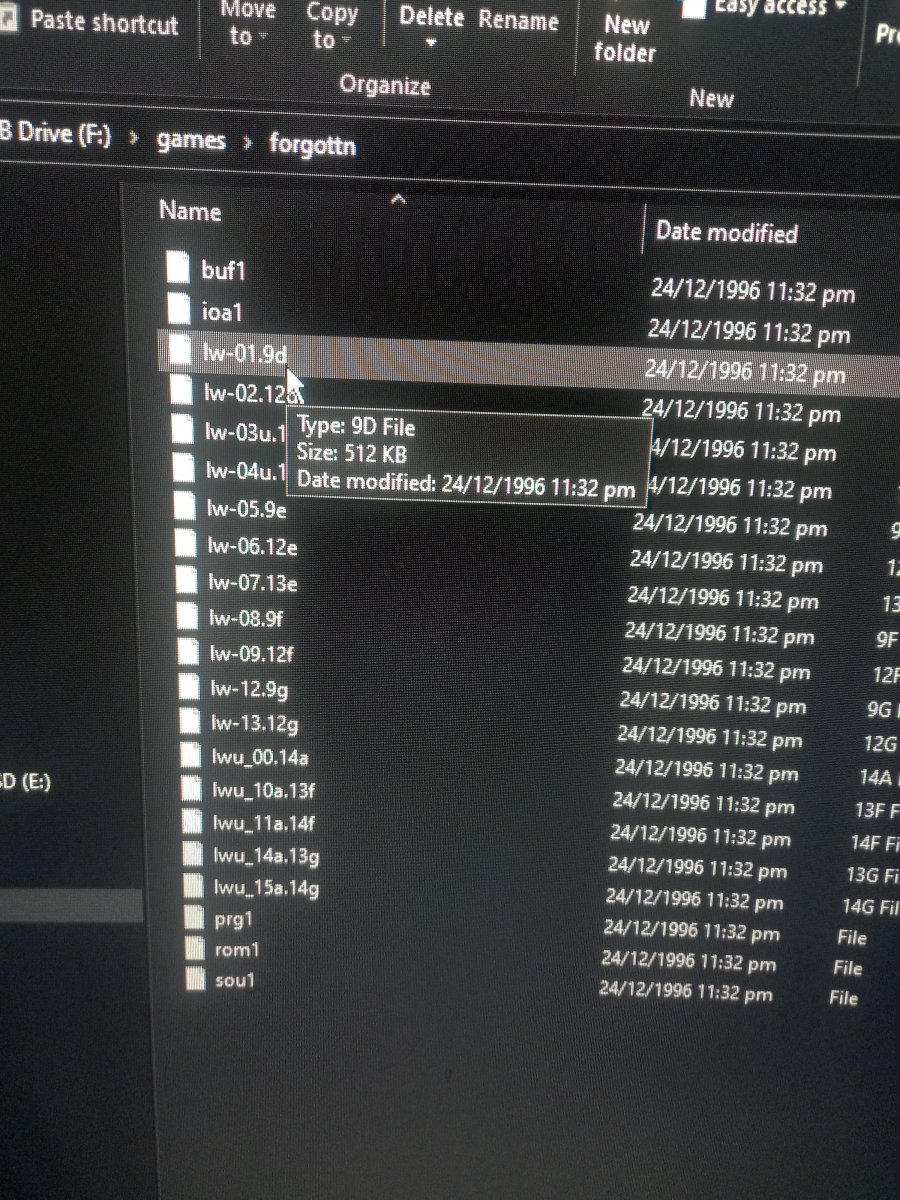

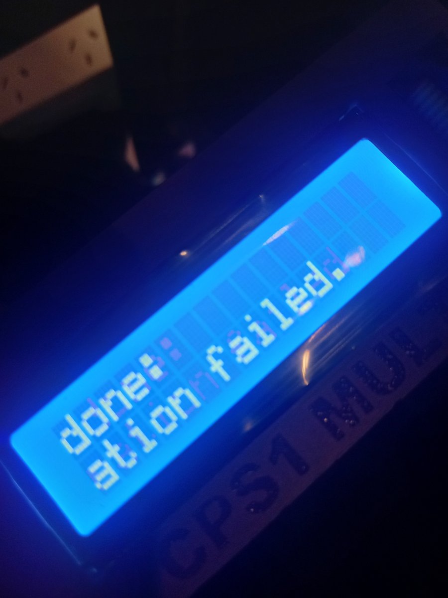

Hi guys I just got a cps1 multi that was tested and working before I got it and I'm having problems I get this screen
And when I load a rom it says failed on the lcd
Is there a certain rom pack for it I need?
