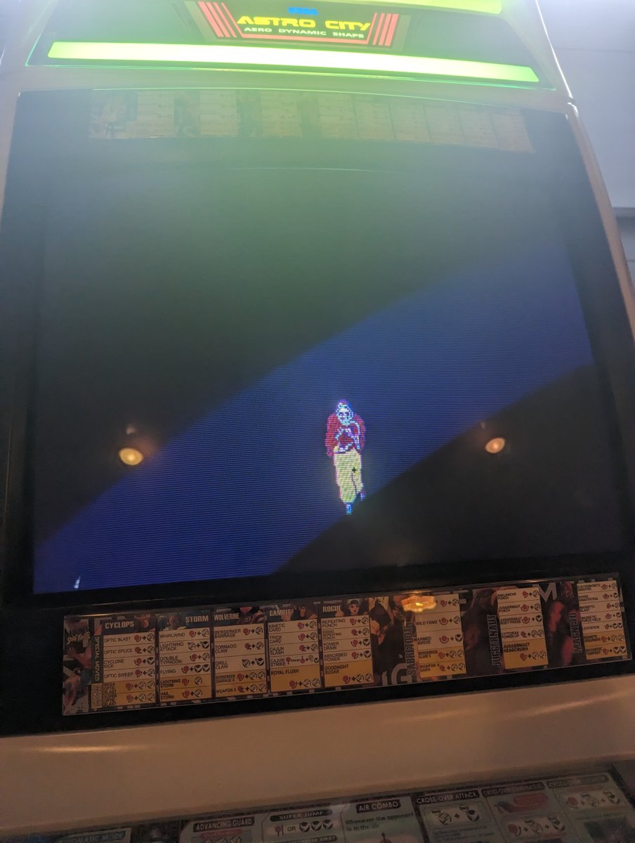

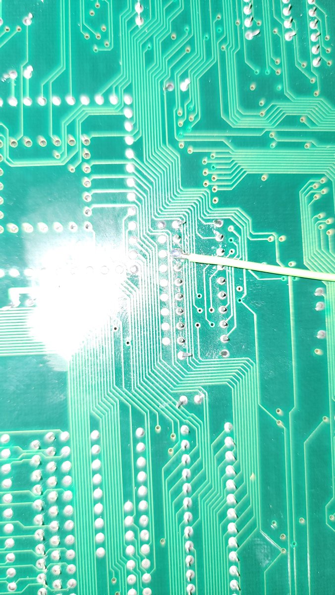

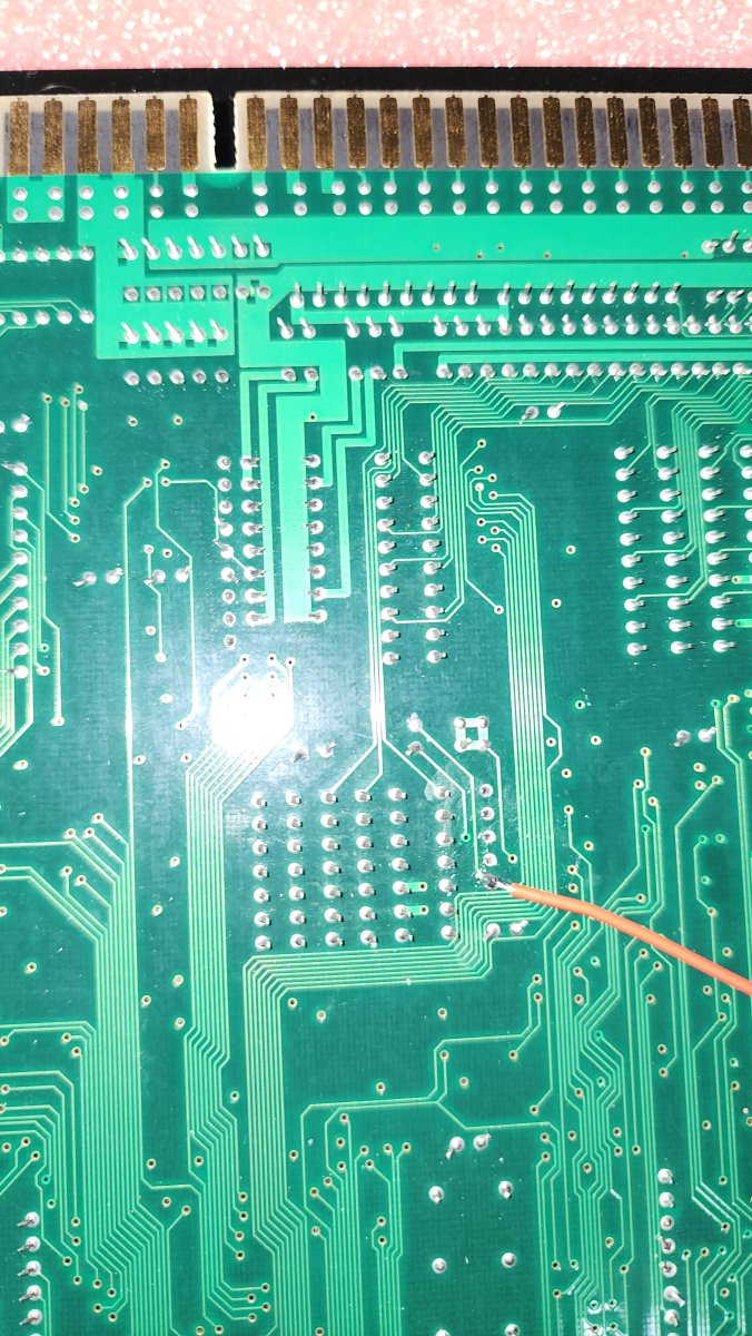

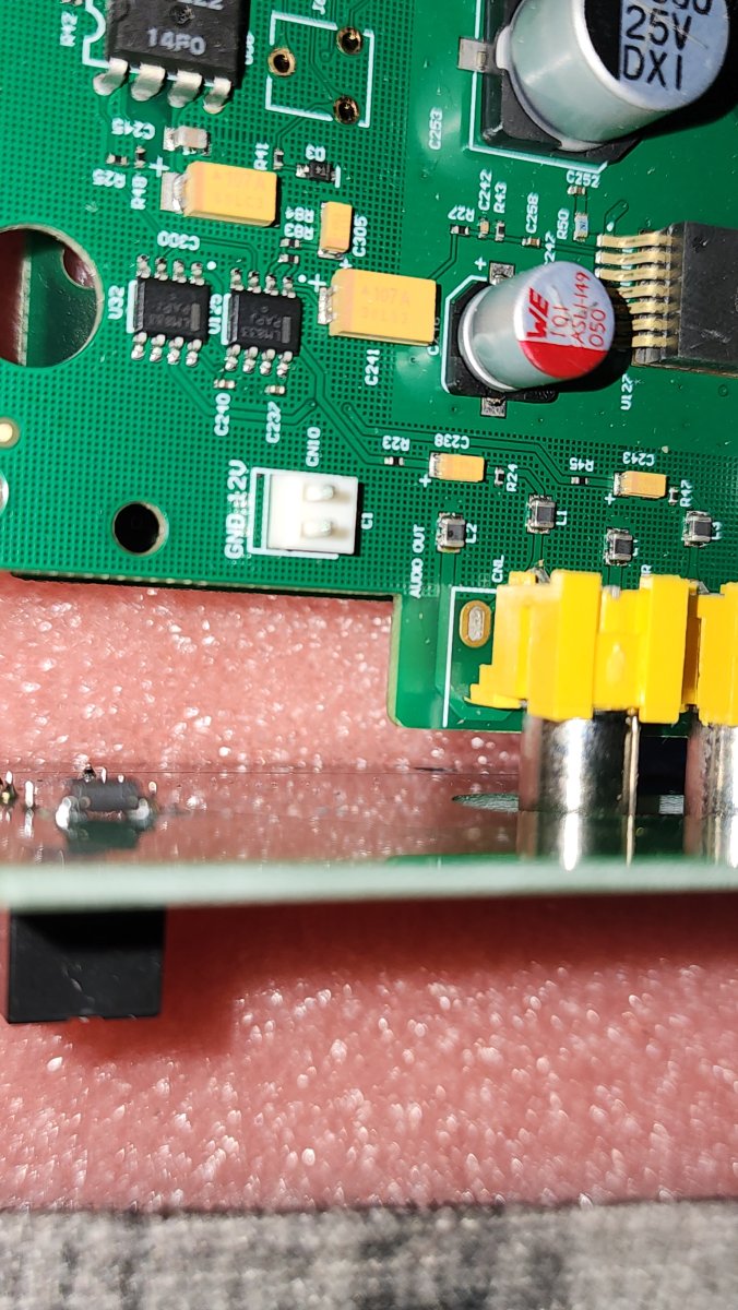

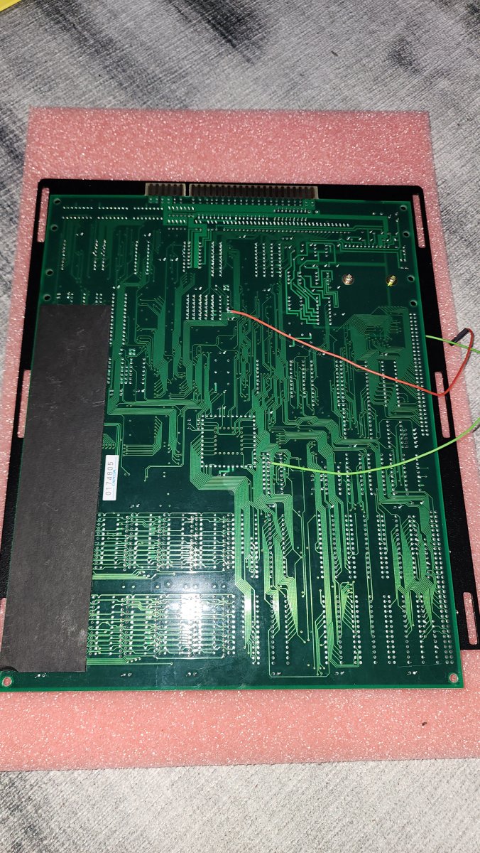

Hi all! just finished my custom "Baby Blue" out of a blast city cab. I got my cps2 darksoft and it works great!! I finally was able to put together my cps1 darksoft and it seems to have 1 issue. Qsound audio is not working. when i hook up rca cables i just get feedback. the cps1 i have has the capcom qsound chip. am i forgetting a setting to make this work?

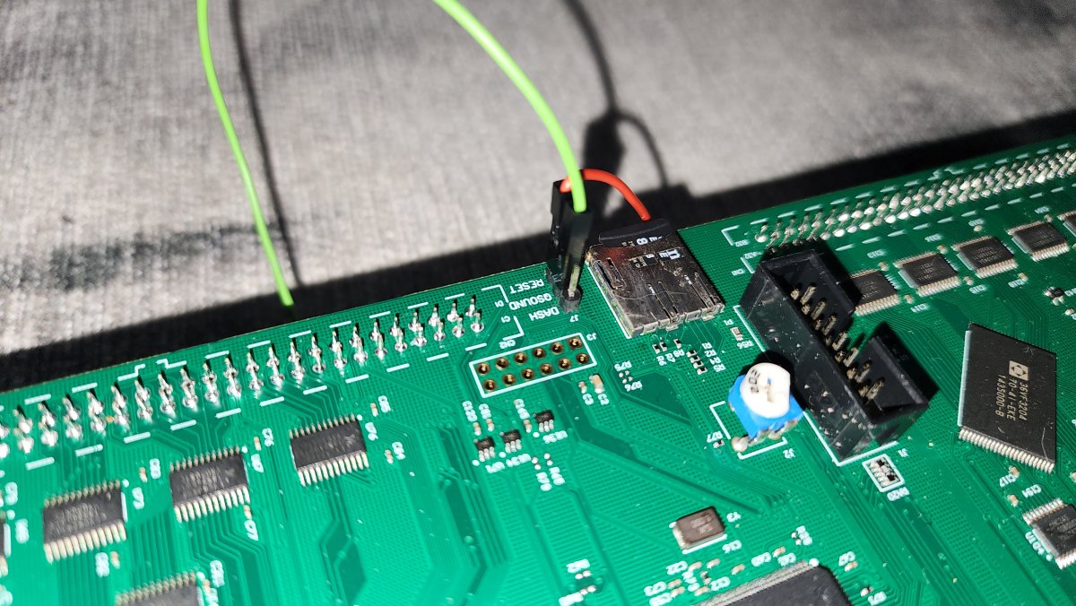

Make sure your Multi's QSound wire is soldered to the correct point on the A board and that the wire is plugged into the proper connector on the Multi board. Pictures of your Multi installation would be helpful.

i tested continuity as well. the connection seems good and no bridges to the pins next to the solder point. im using a dash board and all dip switches are off. do i need to enable any dip switches to get q sound?
Here is the wires connected. on a other thread it was said q sound has to go to a q sound amp. im running it to a blast city amp. is this the issue?
