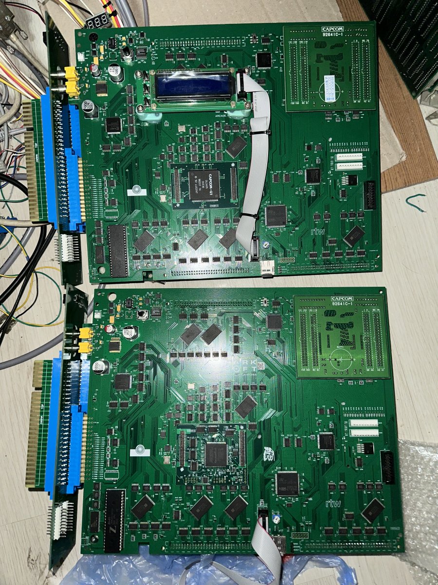

OK, Let's go step by step. Can you show picture of your C Boards? From the pictures I can see that you have 2 multis. Did you try replacing the C Board? and the A Board?
If you tried that already and it didnt work. Send me a PM and I'll give you the instructions to send it to me. All kits are tested one by one before being shipped, so I suspect the problem must be in your setup. It can be that something went bad during the transport, but I doubt it.
Thanks.
Thanks.
Yes, I have 2 multis. And I try replacing the A and C Boards but it doesn't work (sound).

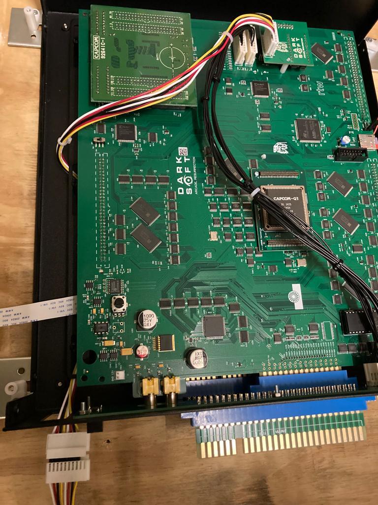

Anyone else using the CPS1 Multi with hursit spinners in a Jasen case?

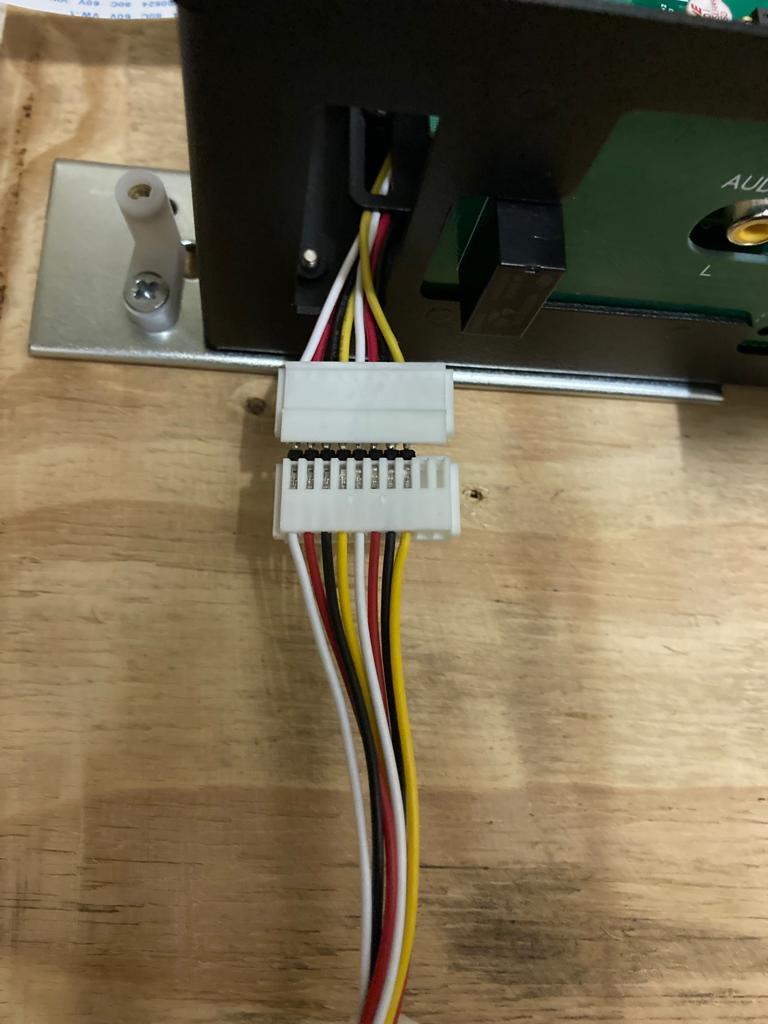

I want it to be easy to disconnect, without having to unplug from the CP or PCB. I've gone for a quick and easy route thus far, but would be interested to see if anyone has done a more sturdy and permanent solution?

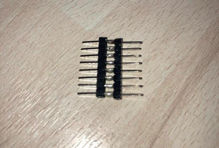

Soldered a coupler of connectors back to back (and then removed one side of the black bridges):
Crimped up a short cable that reaches to the front, allowing for a quick disconnect (need to get some 8 pin housings!)

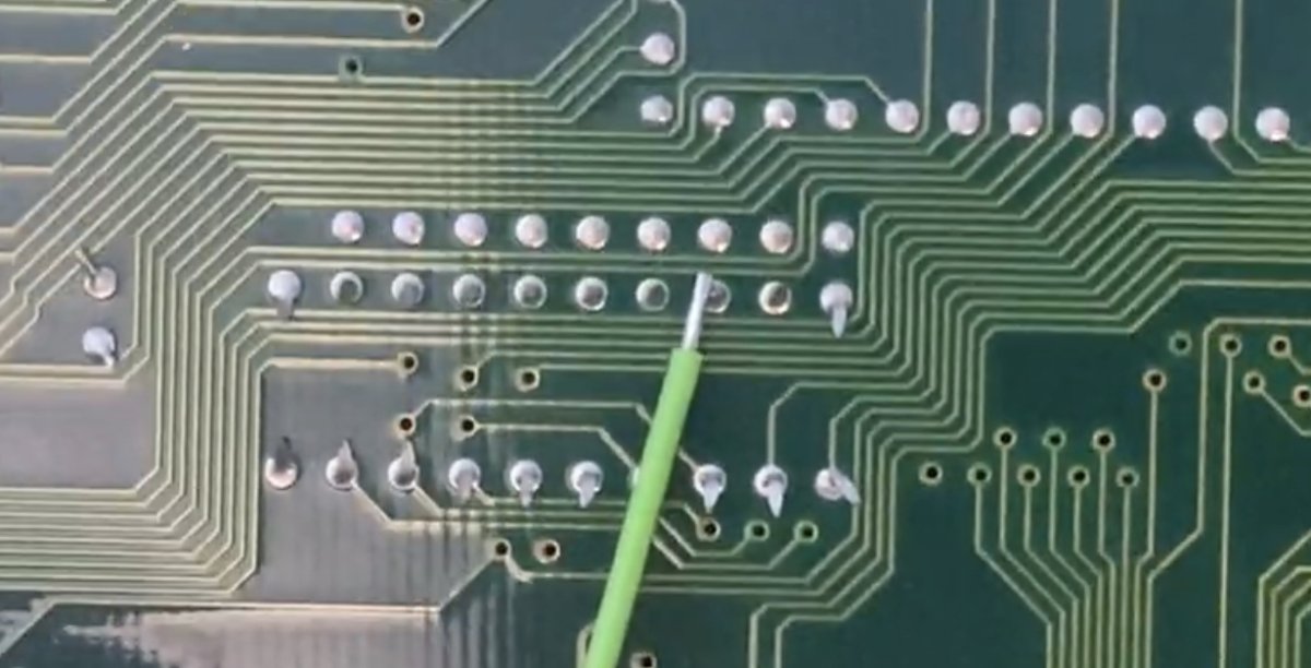

Did you install a wire from the bottom of the PAL to the B board? Step 4 in the video on the first post
Well yeah, also correctly! Like it’s on the right pin, soldered well. You can confirm continuity with a multimeter and it’s not bridging anything. I’ll assume that’s a “yes” so at this point I’m not sure where to direct you. Someone else may chime in.
When I run my working multi with the wrong (i.e. original) PAL I get a situation like what you’re describing. The new pal is identical to the original pal except for a code bank that’s enabled when the qsound wire is active.
So things to check involve that system. The qsound files on the sd card (that toggle that enable signal), the wire, and the code on the replacement PAL which I don’t think is public but also is likely fine if anything-at-all works. You could disconnect the qsound wire from the b board and see if anything is different. If nothing changes then it’s reasonable to believe the issue is in there somewhere.
