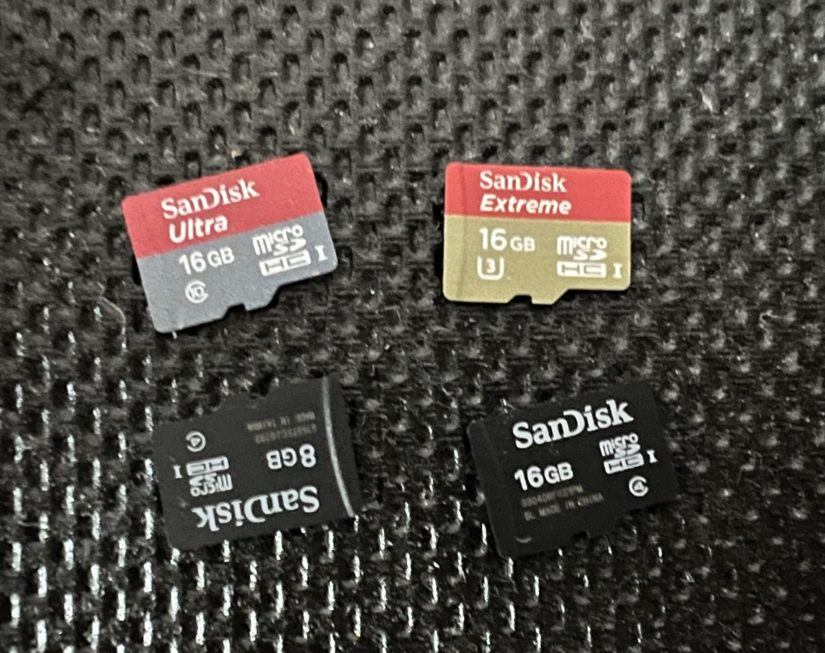

I would… try a 4th. Only one of these is not a fake, can you tell which one? Only one was read as good by the multi. Garbage sd cards are everywhere and yours don’t scream ‘trustworthy’. You can sometimes tell by how quickly the card can be loaded with data. Single digit Mb/s transfer speeds probably signal a bad card. I used one that was verified good because it worked in another multi and an everdrive.

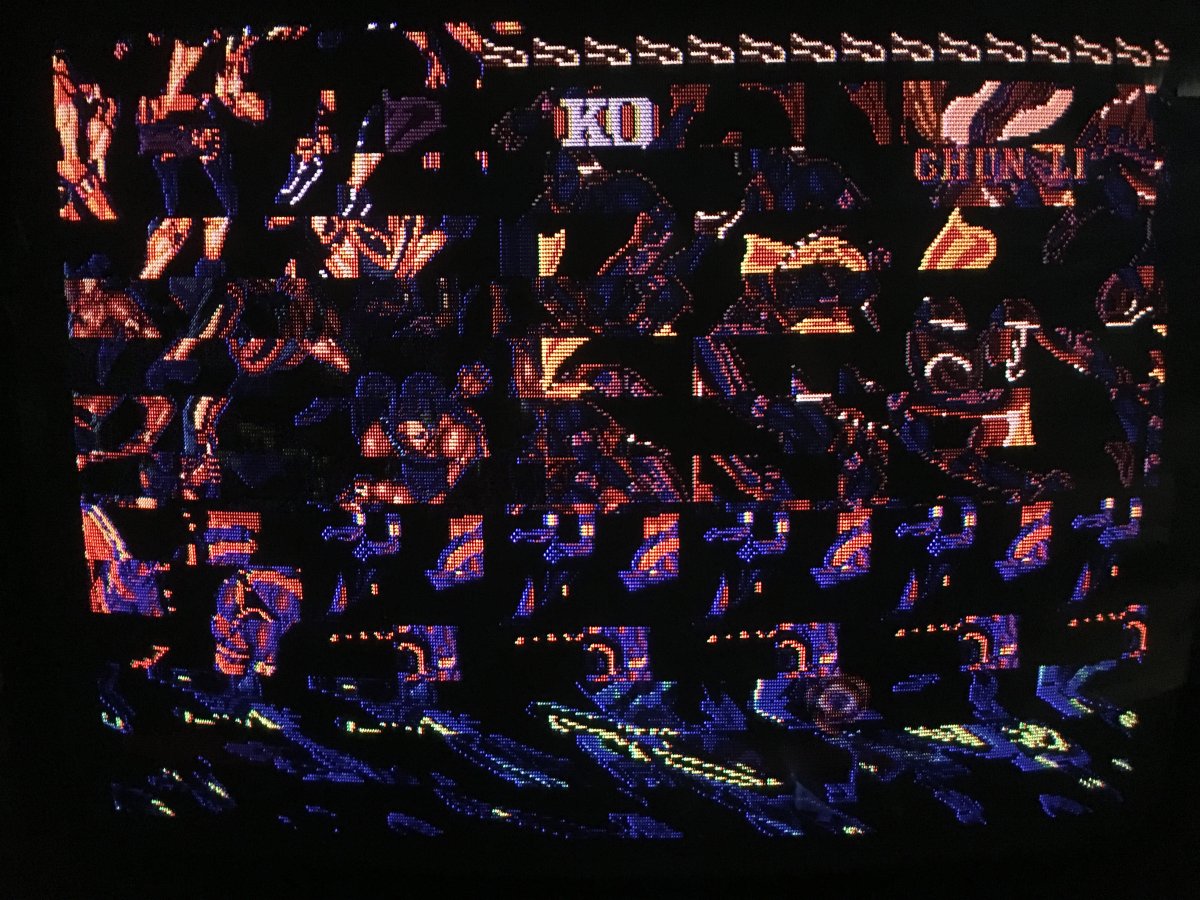

I’ve got a Dash board and a modified 92631C-6 C board installed running the US Pack, I’ve successfully played through many games and everything has been great but just noticed an issue with SF2 Koryu Edition.
Has anyone played this one successfully?
Here’s a picture of what I’m getting

Just tried. Mine loaded slightly different garbage, but garbage nonetheless. might just be an issue with the rom in the USA pack. I haven’t tried it from any other pack but you could give that a shot.

I’ll give it a try with one of the other sets, thank you for confirming.
