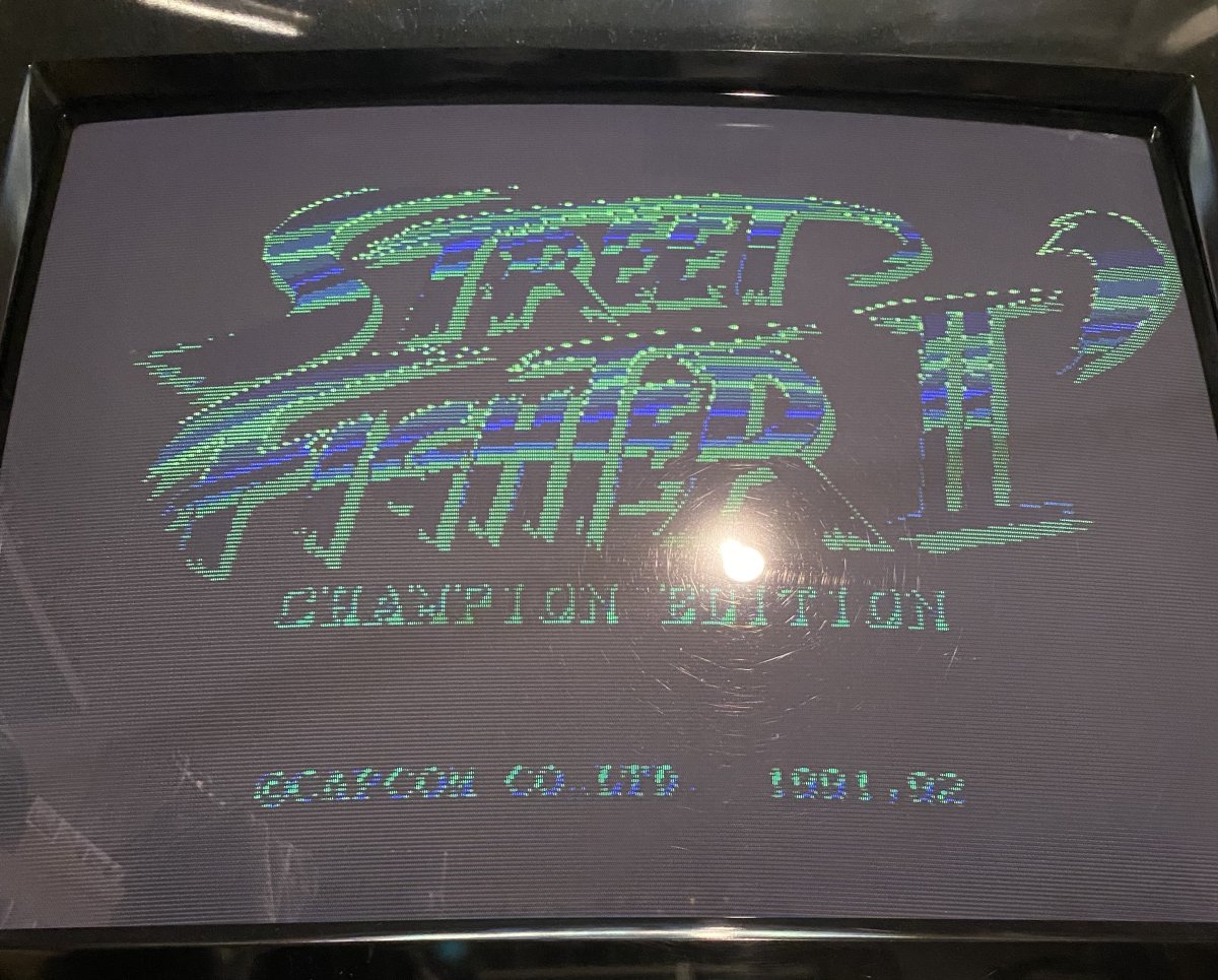

Apologies if this had been mentioned, but is it normal that when switching to specific games (ie World Warrior to Hyper Fighting) the new game’s graphics are messed up or missing, but when you do a power cycle, it’s fixed?
it happens to certain games. I flashed the game to CE from a proper WW flash, but it looked like this.
However, when power cycled it’s fine.
Tried flashing to muscle bomber, 1942, captain commando, punisher and all were fine.
I have experienced something similar but I believe I was flashing to daimakaimura. I didn't remember which game I was coming from. Something in the USA region.
Power cycle and all was well.
