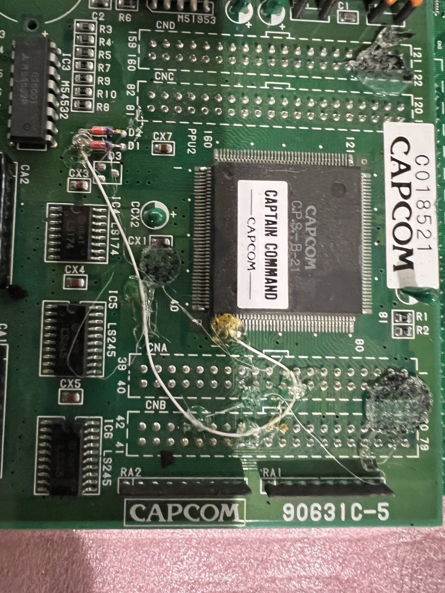

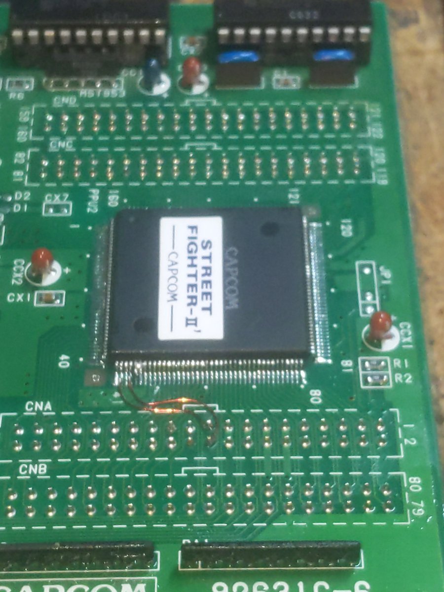

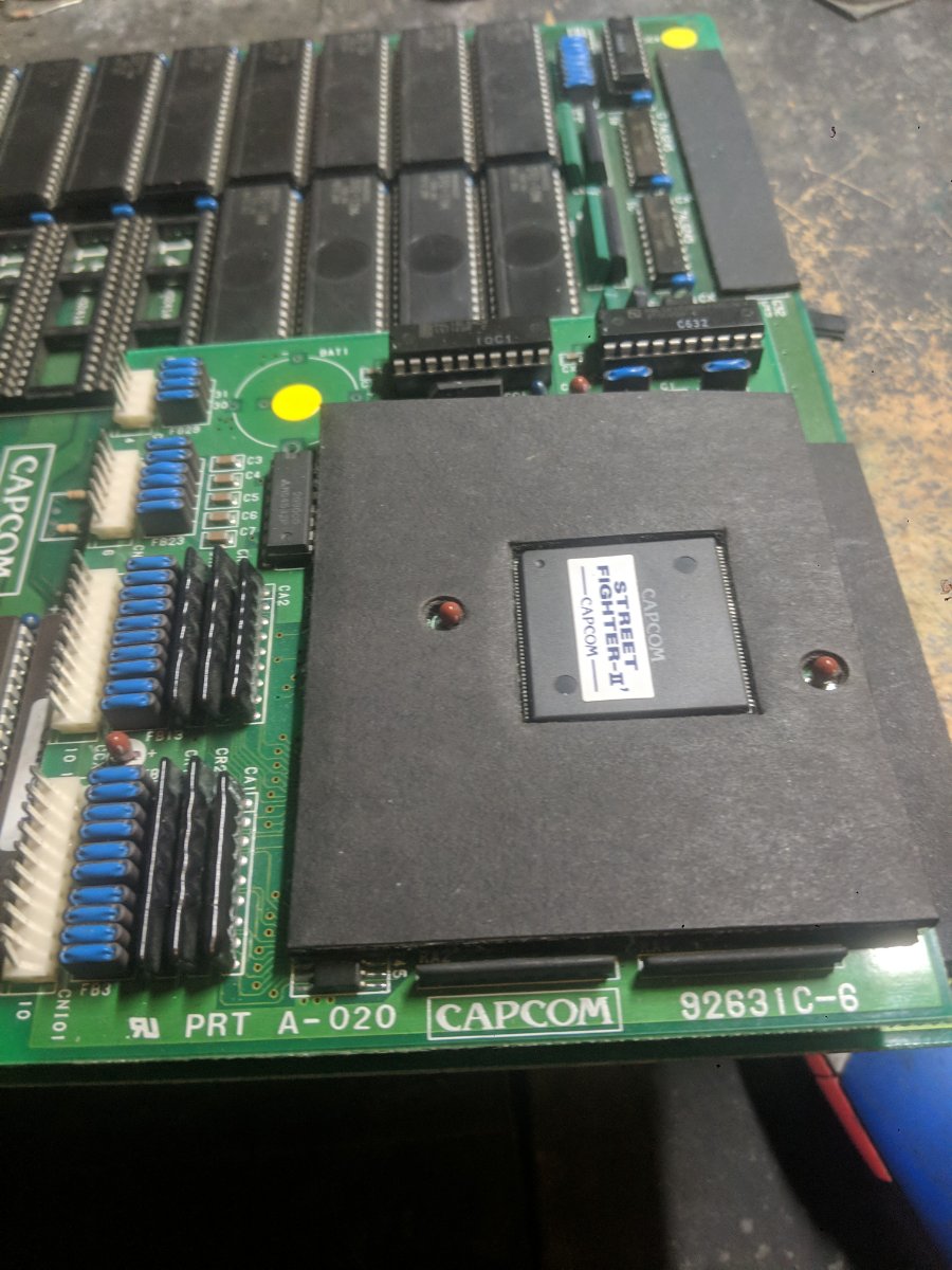

After not having time to do any arcade stuff for a very long time I am finally putting together my cps1 multi. Having some issues with only a couple games working. Pulled the black foam like cover off my C board to find this. Seems a bot dodgy?
That C Board has been modded and doesn't allow.key injection. You need to undo the mod or get a new one without that patch.
Remove that cable and solder blob. I see there is a trace cut too that should be undone. Send pictures and check that Vcc and GND are not shortcutting before plugging it back again.

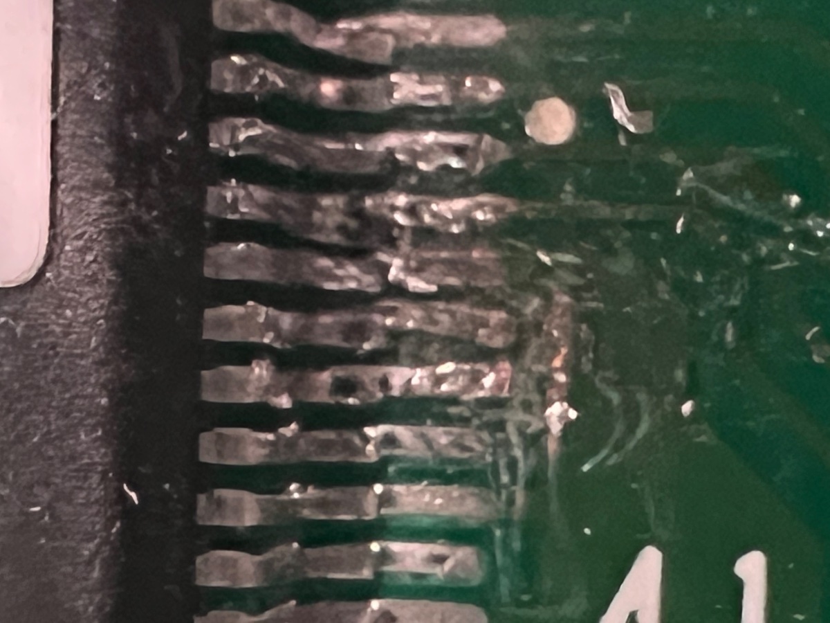

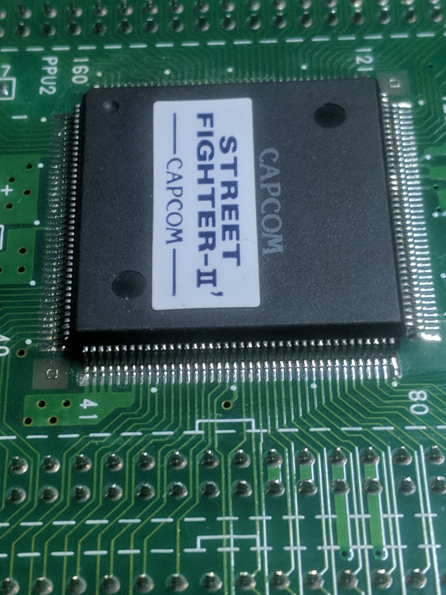

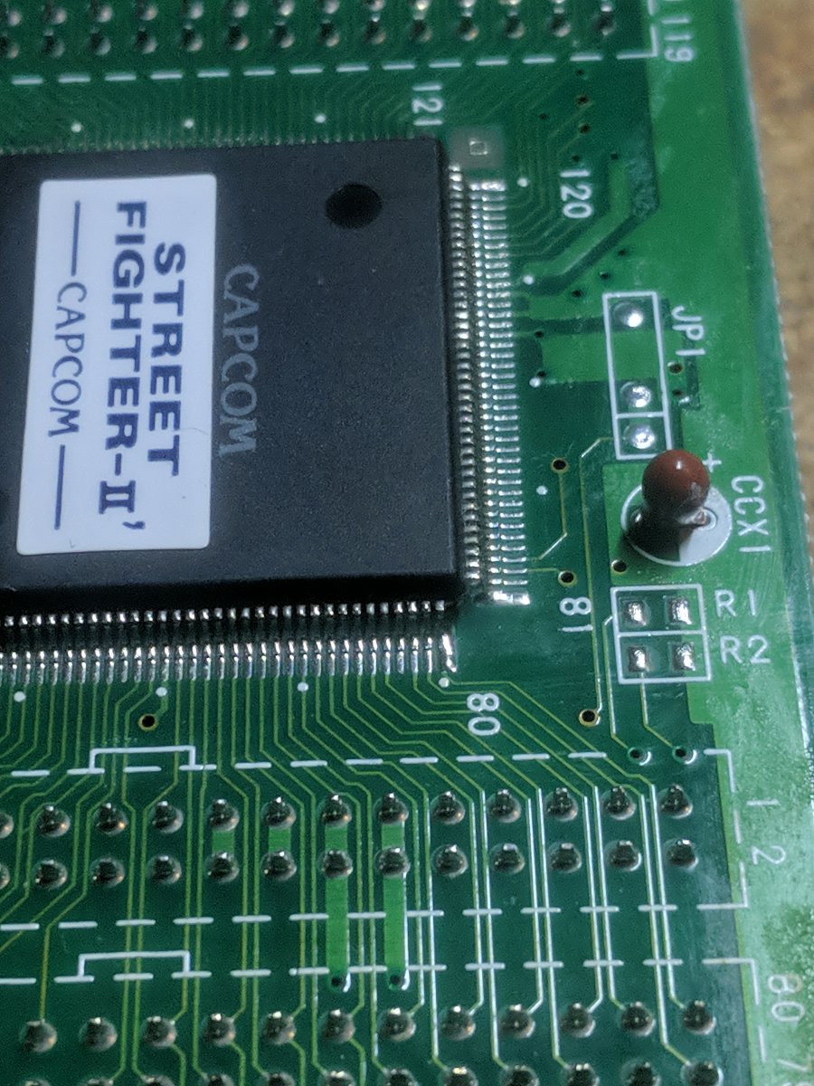

Not feeling wonderful about this solder cleanup I did.
You can do better than that pretty easily.
Do you have flux? I recommend the grease style as it's easy to work with.
Put the flux all over those pins where they are attached to the PCB and apply heat. Most of the solder will just straighten out on the pins.
If any clumps pins together just apply heat and drag away (towards the green).
If you need to remove some solder, use de-soldering braid w/flux. It's very easy to work with.
Edit: If there's hot glue on there remove it with 90% or greater isopropyl alcohol before doing any soldering.

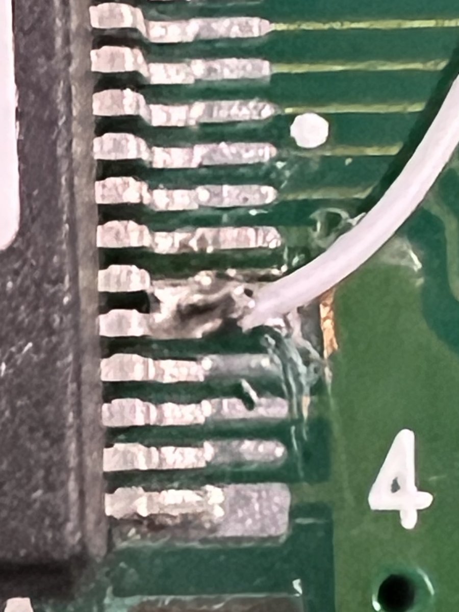

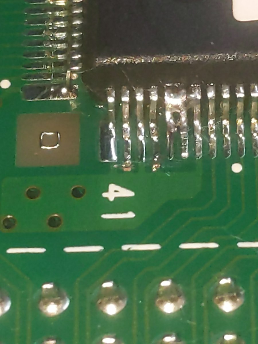

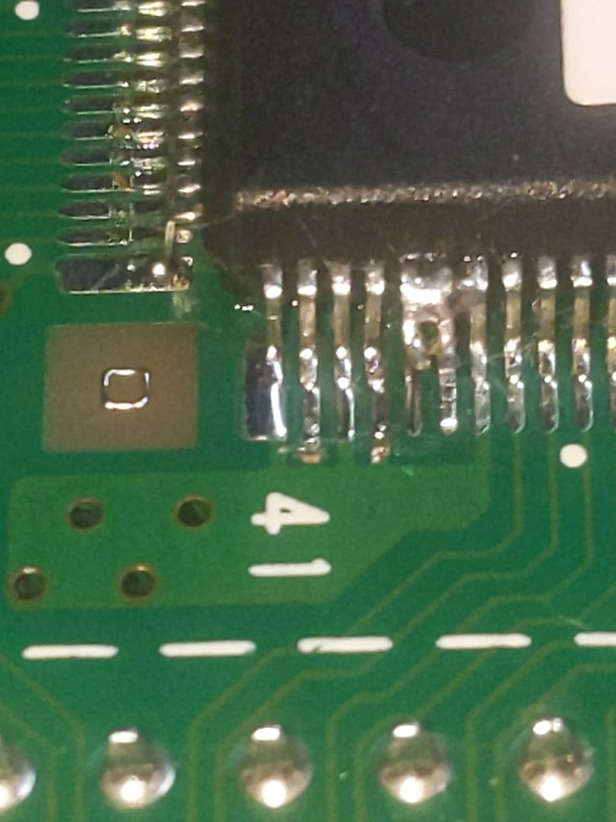

That looks like a potentially lifted pad
Put it under magnification, it is def lifted. The one next to it might be broken. I prob did too much heat or pulled on wire too soon. Im good with soldering most things including small things but not small things close together. Need to find a new c-board or see if anyone else can fix.

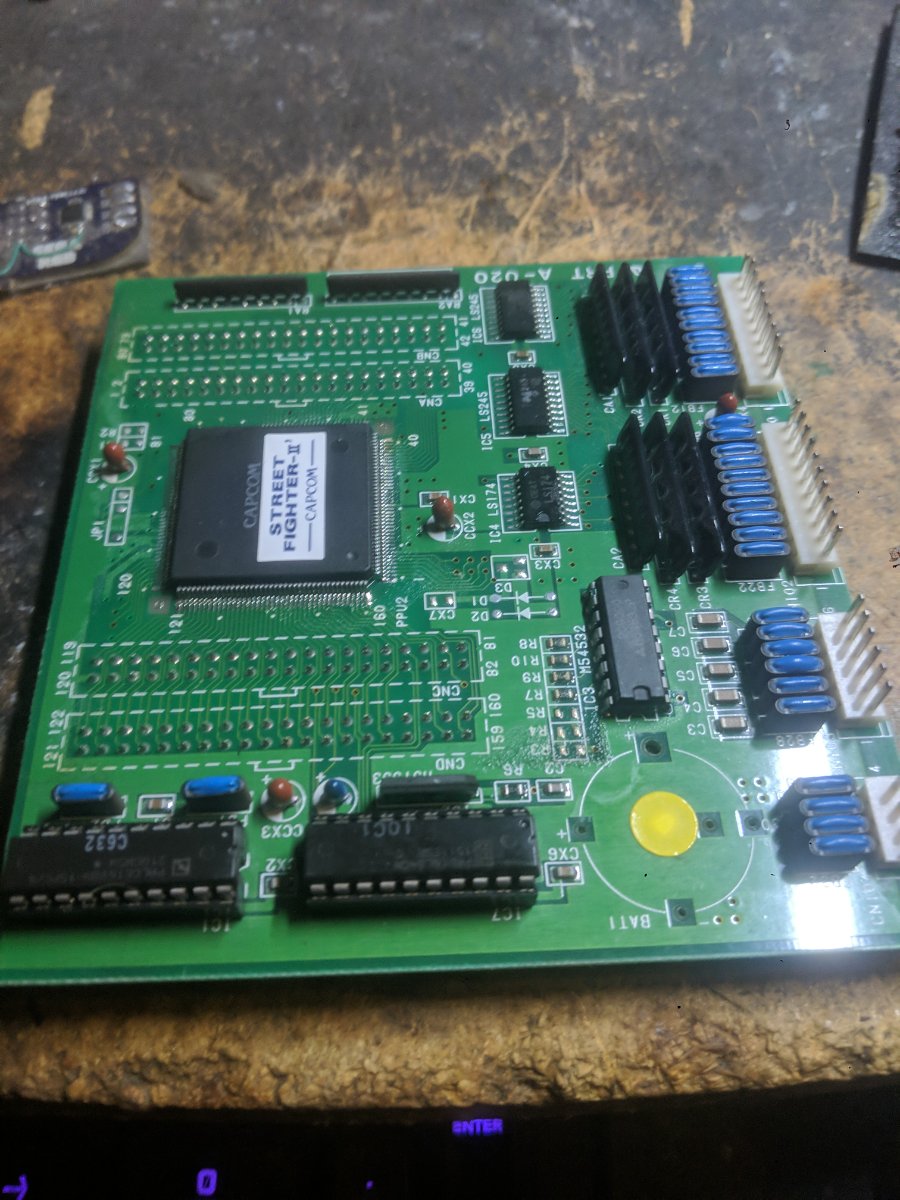

I ended up having a spare hyper fighting C board 92631C-6, I modded it and sold it to @Coyo5050 .
