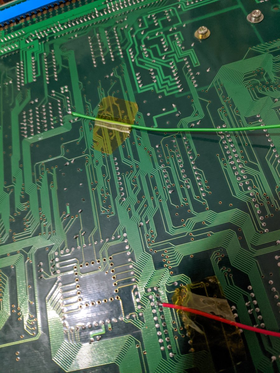

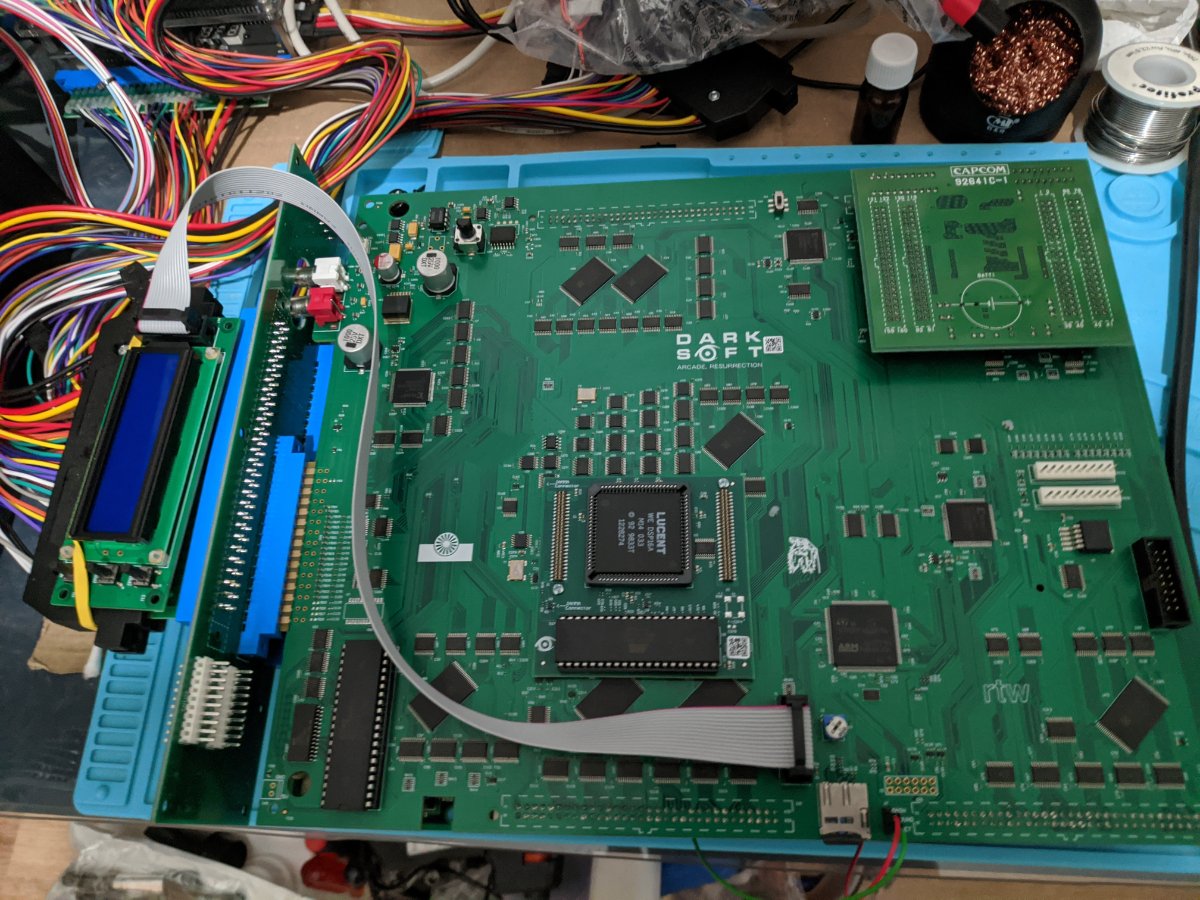

no I'm only trying to use jamma sound for now.
just rechecked the continuity between the bottom of the connector of both dupont cables and the solder point👍

options are either mono or q-sound, I tried both above, with both jamma and rcas and said neither did give sound, but I might have been unclear, soory, english isn't my mother tongue😅

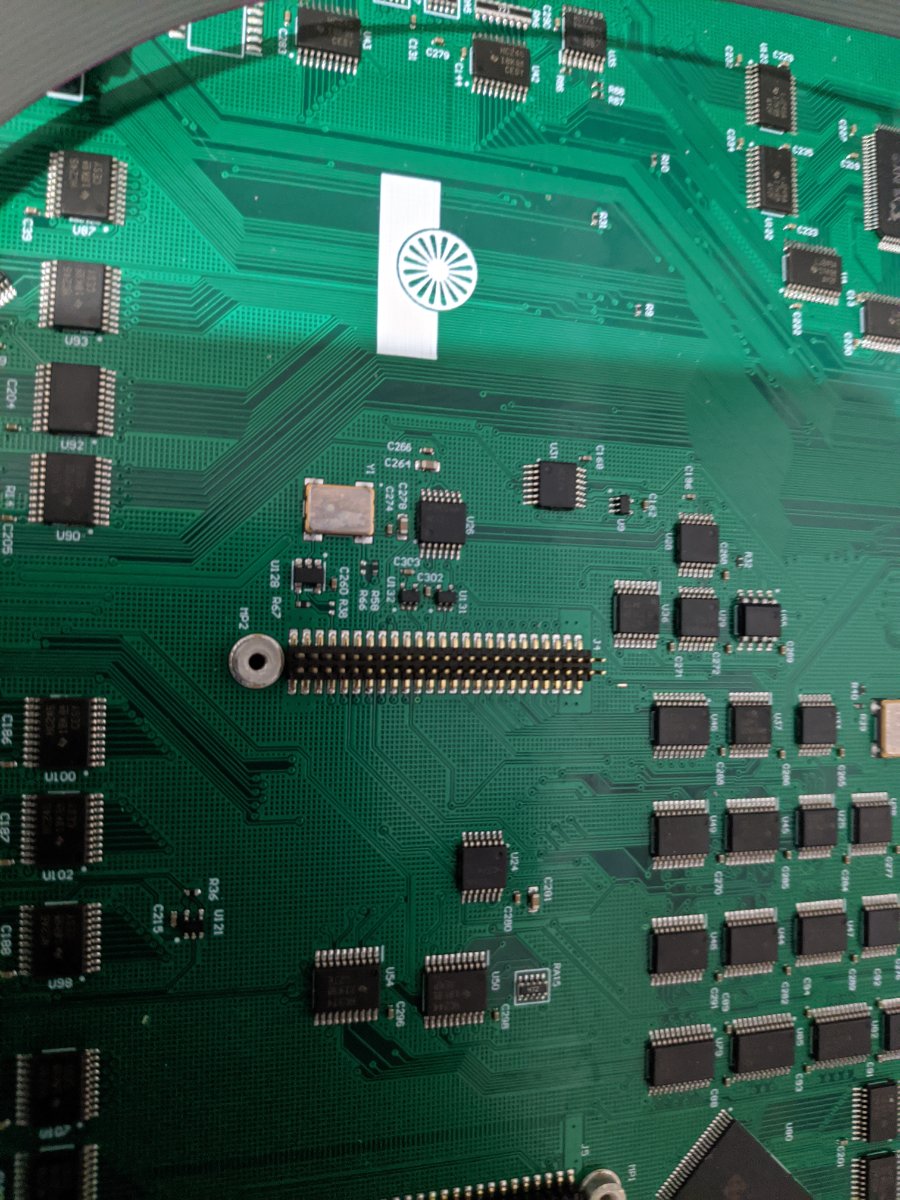

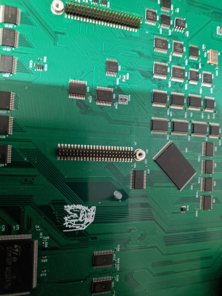

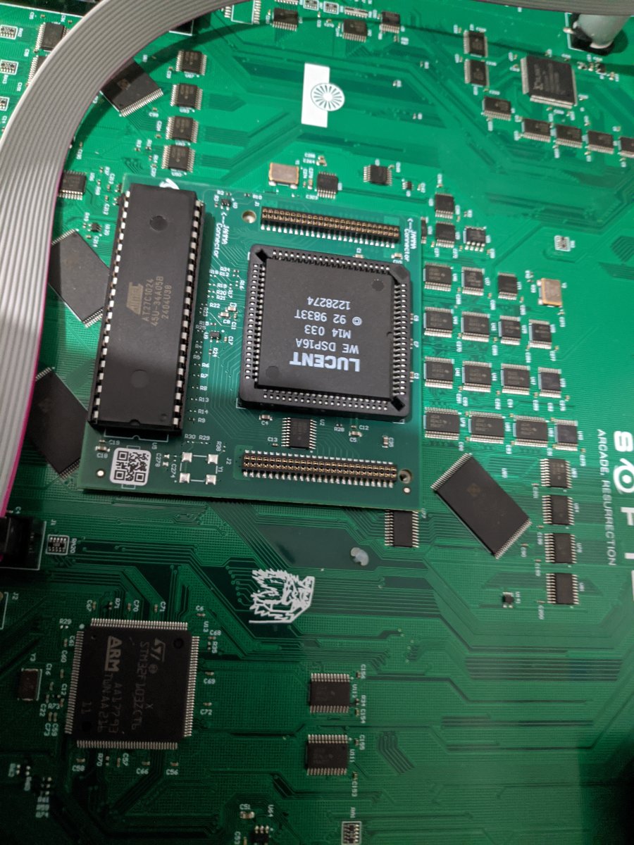

I see that you have the new WE DSP16A sound module. Do you still have the other one with FPGA? does it work the same with that one?
You know that there is a volume pot for Qsound, right? Did you try to turn it?
I think that the WE DSP16A is not makeing good contact. Can you push the chip more inside the socket? remove the 2 screws to do it, so you don't bend the multi PCB. If you can remove it from the socket and insert again. If that doesn't help I'll send you a new WEDSP16A sound module to replace that one.
I think it was very well in place haha, still managed to gently take it out and put bit back, still the same as before, static : (amplified like crazy so you can here something helpful(?)
https://streamable.com/882txu
(I did screw it back obviously👍)
